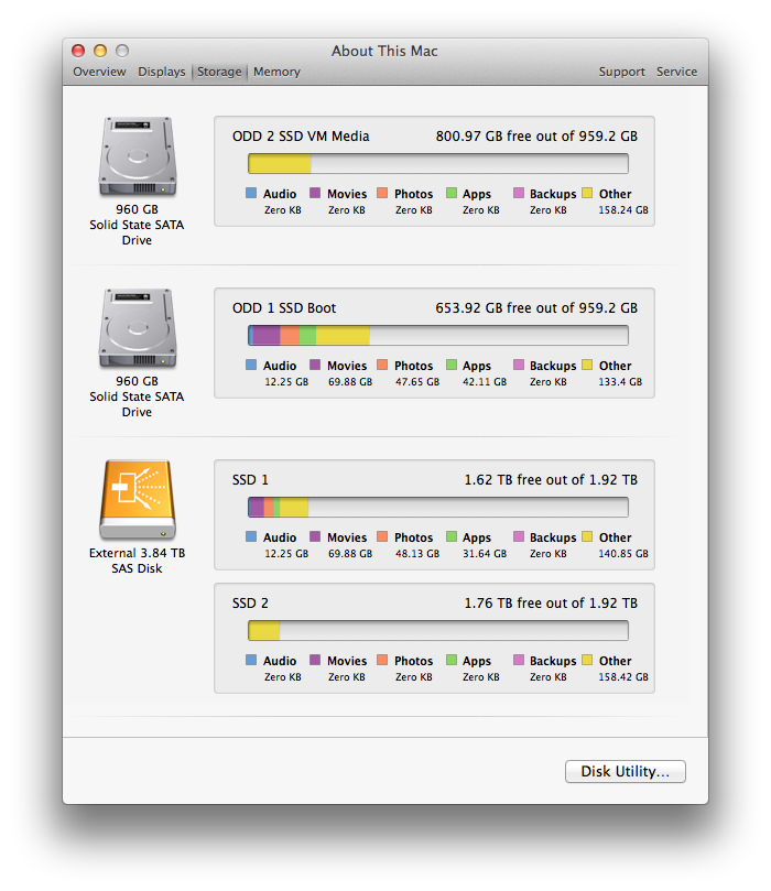

I have two raids setup in my 5,1. I have four ssd's in drive sleds 1-4. Raid 0 for 1-2 and Raid 0 for 3-4. OS on 1st set and vm's on 2nd set. Installed well, all features available except for back find my mac. Says not supported on raid, but haven't dug into it to see if there is a manual work around or not.

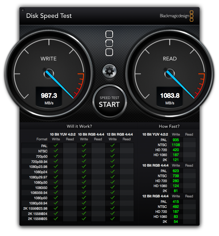

I have one SSD 1+0 array and two SSDs connected to the ODD1 and ODD2 ports of a MP 3,1.
I had a lot of problems booting up from the SSD array until I partitioned it so that the arrays were 2TB or less. After that, the MP was able to boot from those arrays.
Just a word of caution -- back up your RAID boot set-up. Your failure rate is double now since a single failure of one of your SSDs will cause the whole array to fail. RAID 0 has no redundancy at all, so if this is a rig you use for work, I would make sure you back it up at least daily with CCC.
Cheers and have fun with your new super fast array!
Those are impressive DiskTest speeds ... what are you using to achieve those speeds?

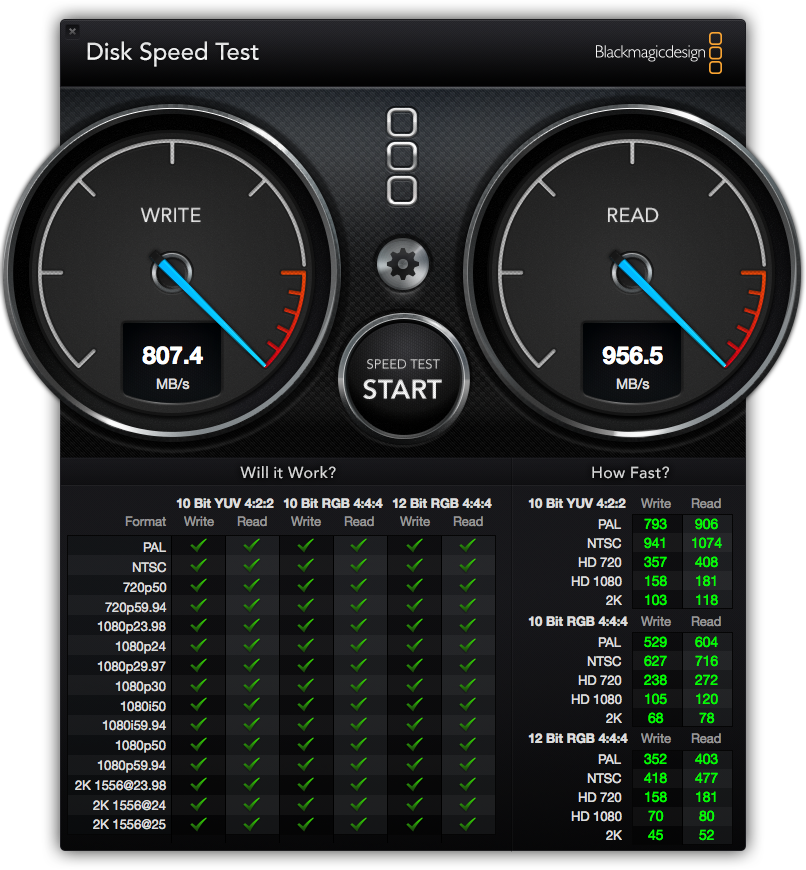

Yes, you do want to have a good backup strategy when using RAID-0, however a single SSD system will have similar results if the SSD fails ... so always have backup.
I am seeing these speeds with a pair of 512GB Samsung 840 Pro SSDs on a Sonnet Tempo Pro PCIe card in my 5,1 MacPro:
