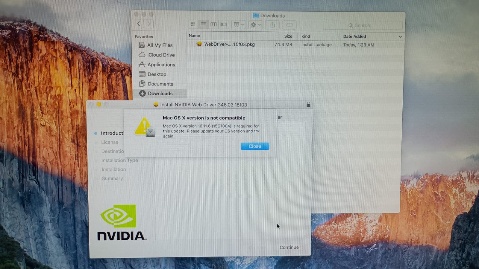

But I've couldn't install them
I've received this message:
Mac OS X version is not compatible
Mac OS X version 10.11.6 (15G1004) is required for this update. Please update your OS version and try again.

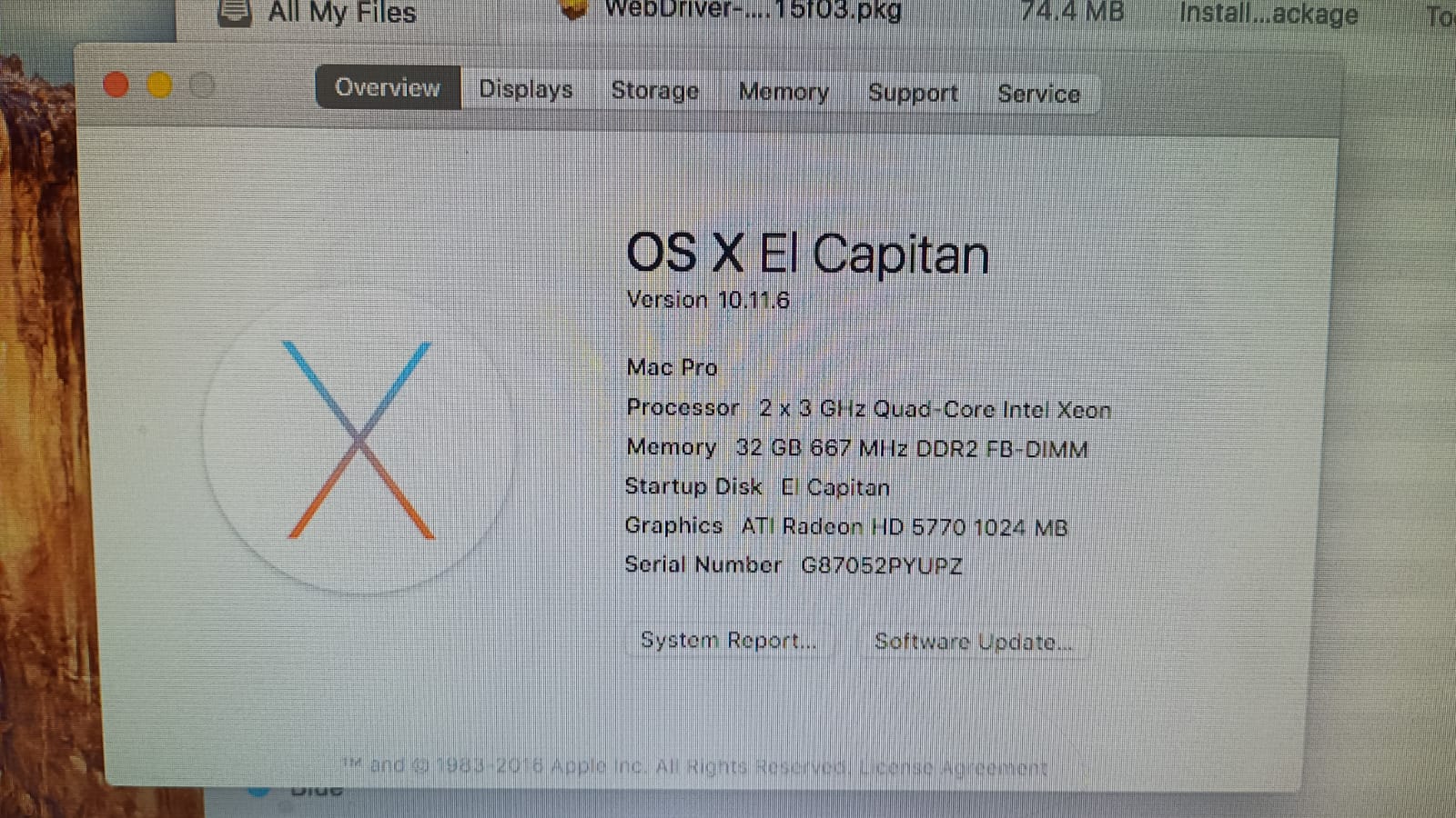

What is the exact build of installed OSX? Click on the version no. in the window.

System Software Overview:
System Version: OS X 10.11.6 (15G31)
Kernel Version: Darwin 15.6.0
Boot Volume: El Capitan
Boot Mode: Normal
"(15G1004) 346.03.15f03" din't work out, BUT "(15G31) 346.03.15f02" worked like a charm!
