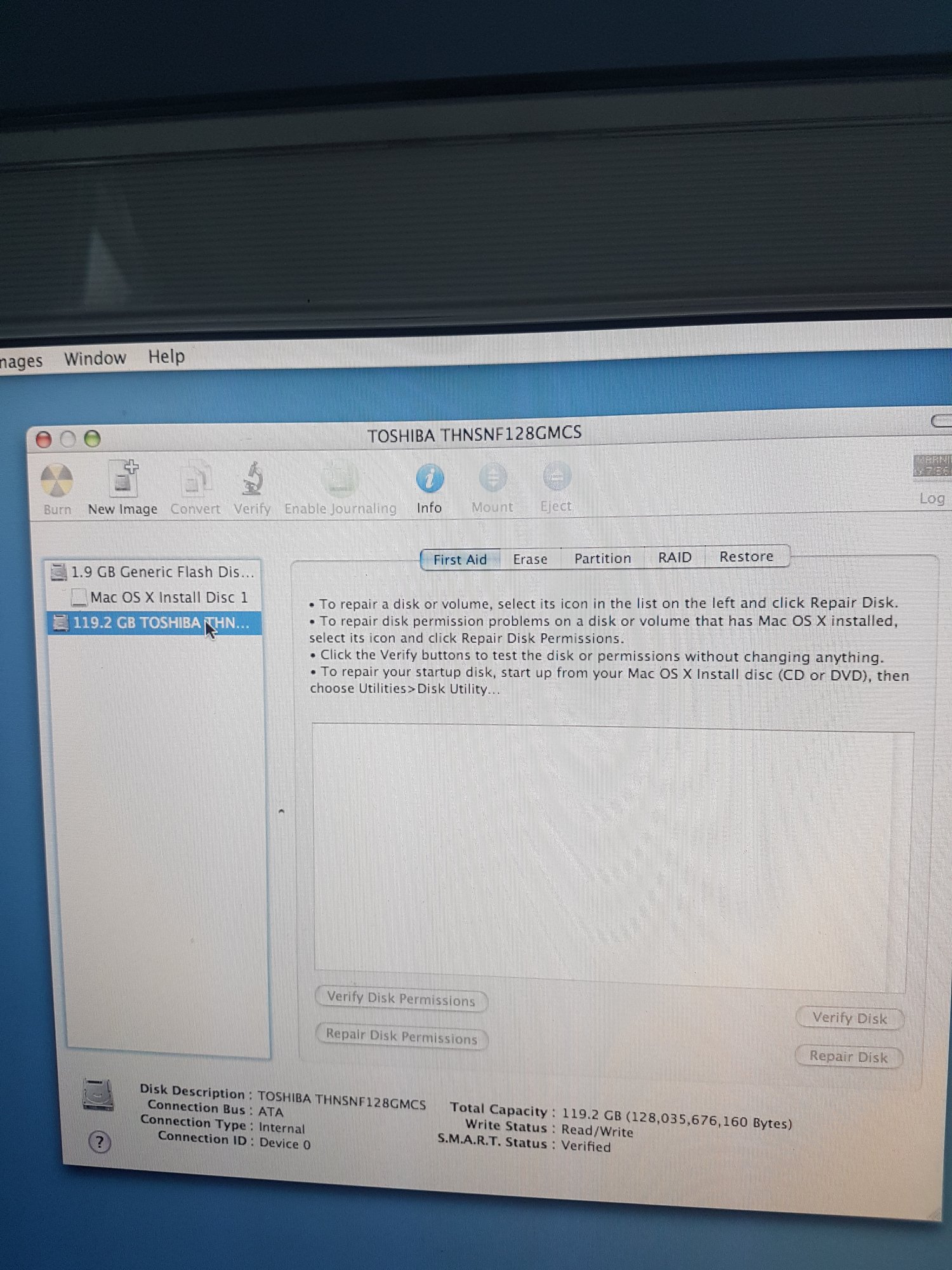

Help please! I used the FW400 MDD and managed to boot Tiger from a USB and get to the disk utility. The SSD showed up and I selected to format the drive with a series of partitions, checking the 'Install OS 9 drivers' box. However, disk utility hung up at 'Creating Partition Map': this should usually be a few seconds but it had been over an hour. So after googling this issue (which others seems to have had) I stopped the process and turned off the machine. However, when I went to try again the drive no longer showed up on Disk Utility, either on the FW400 or the FW800 MDDs.
The disk does however show up on Open Firmware, at least I think so: when I type devalias there is an entry which goes
hd /pci@4000000/ata-6@d/disk@0
Have bricked this drive like an idiot? Can I salvage it?
Thanks!

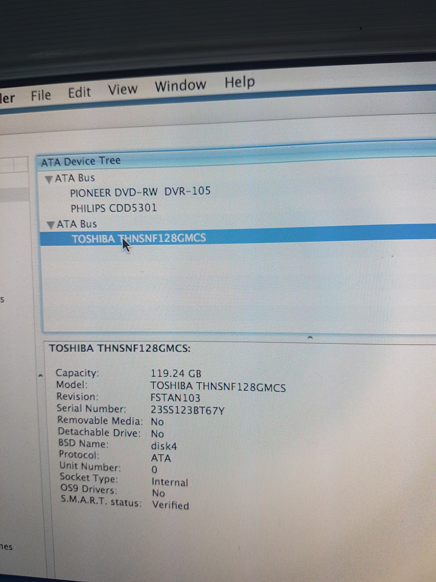

EDIT: Update - the drive now shows up in the system profiler. But nothing in Disk Utility - do you have any advice?
Can you try hooking up the SSD to a native mSATA system, just to check that it's still okay and it's the fault of the adapter or the wretched cable?

The drive has magically reappeared again on Disk Utility! I will try the partitioning again - wish me luck! I think I will just let it do its thing this time...
Reactions: Amethyst1
Now my old IDE spinner is showing up on Disk Utility but I get input/output error when trying to format it on disk utility. So either this drive is bad (could be, it's 15 years old), or the 2.5-3.5 IDE cable also. What a nightmare!

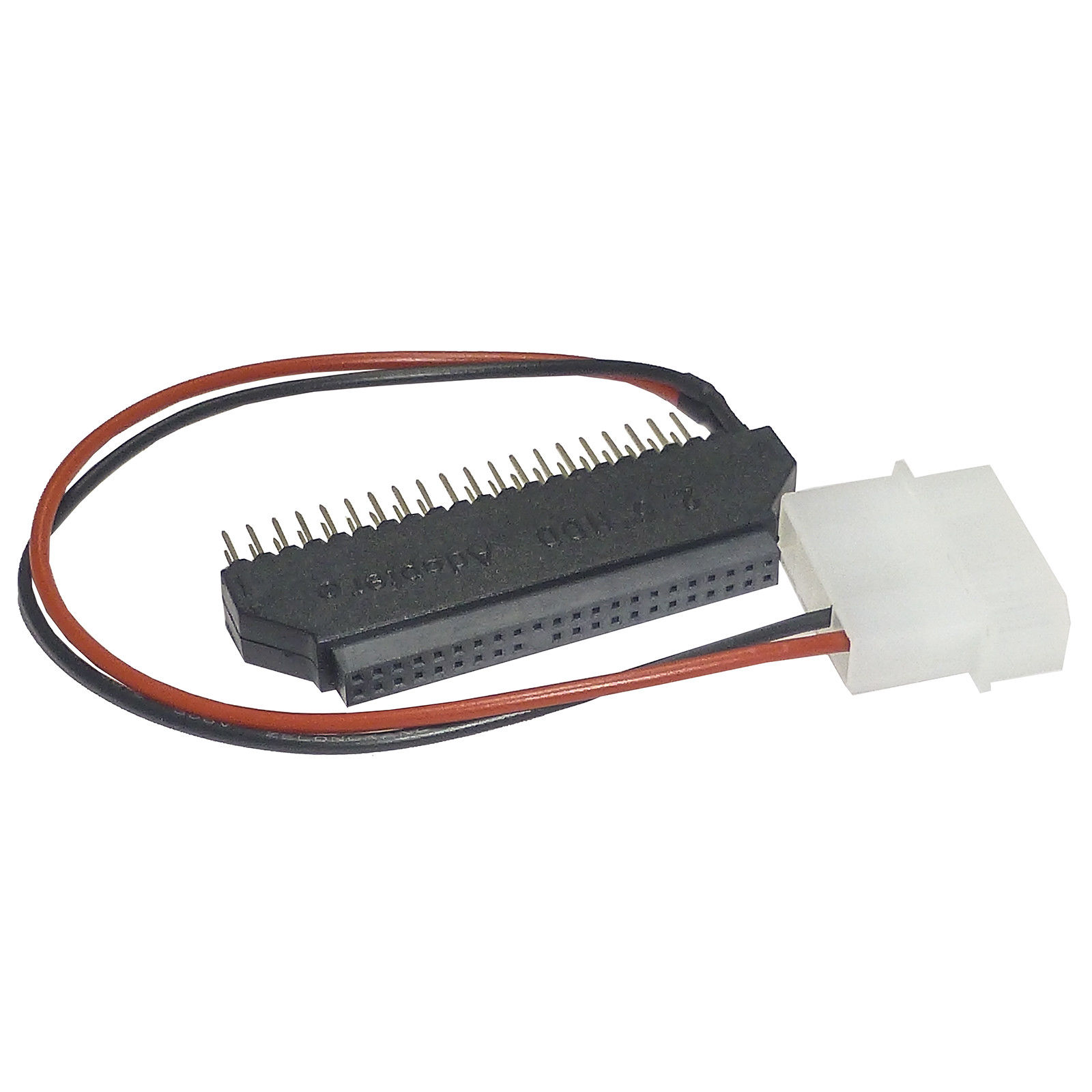

I got the seller to send me a different adapter, and it worked! Reassuringly, it was a cable issue then and not a disk one.
This sort of thing - which plugs straight into the existing 3.5 cable, and also makes it impossible to plug the cable the wrong way around. To keep in mind if anyone is trying to plugin a 2.5 drive into a 3.5 cable!

Great to hear that - and sorry for having pointed you to the non-working cable first. 😳
Not your fault! I probably would have bought the same one first - it's the first one that comes up on eBay, and I only found that adapter because I looked through the seller's other listings. All's well that ends well! Machine is installing Tiger as we speak 🙂
