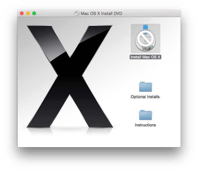

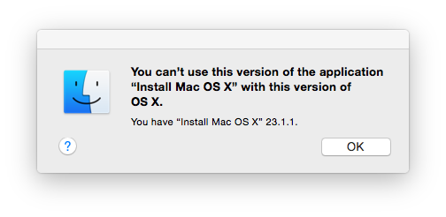

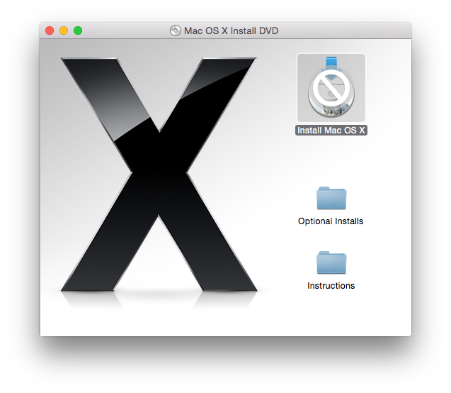

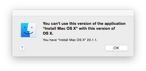

I am trying to install Snow Leopard in a partition. (The partition has nothing on/in it) on my mini's internal HD. The OS is Yosemite. I get this message;
If I double click the installer.
If I drag the installer to the Snow Leopard partition the installer goes there but when I click on it I get the same message?
Also....If I install SL on my external HD (that has Time Machine on it) will that mess with Time Machine? Thanks.
You cannot install Snow Leopard on a 2012 Mac Mini. If you need Snow Leopard, you must install Snow Leopard Server into a virtual machine.

No, because SL does not have the device drivers (kexts) to interface with the new components. There's no way to load SL onto a modern Mac at this point.
