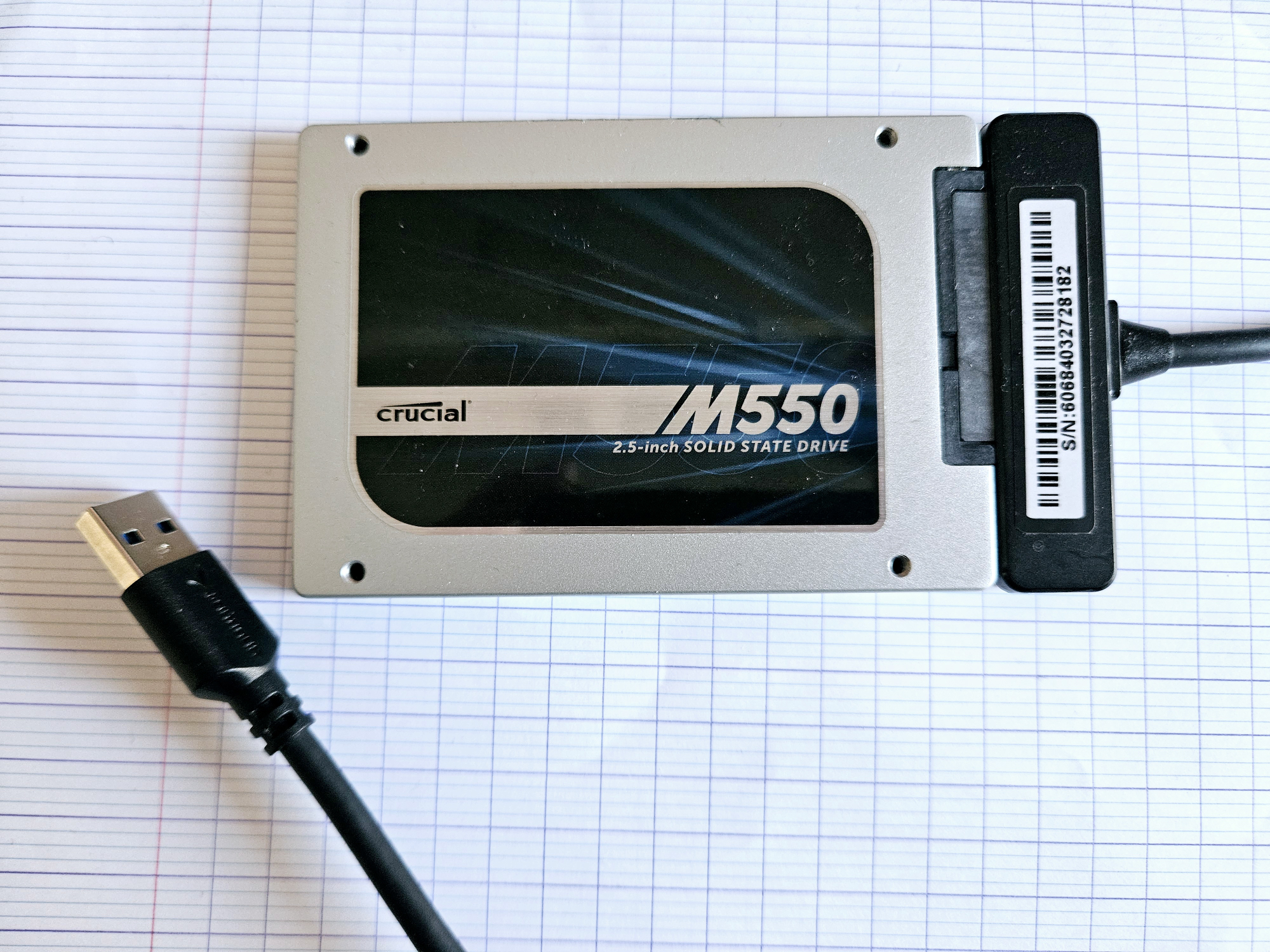

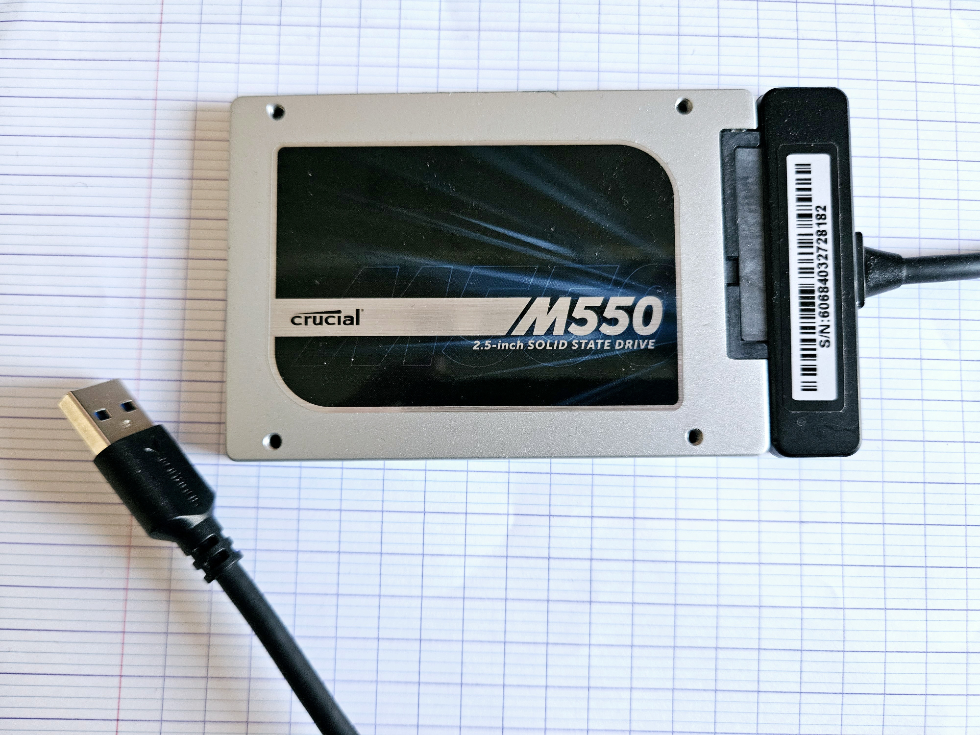

I have at least an SSD Crucial With Windows that is functional With Windows 11 Pro (Tiny), created with Rufus. (see above).
I don't know why it's ok with an external SSD but not with a UGREEN 40Gbps PCIe 4.0 + Samsung NVMe 980 PRO in a 40Gbps PCIe 4.0.
May be I can clone/duplicate the SSD(with Windows) to the NVMe, but neither SuperDuper, nor Disk Utility is able to to this with NTFS formatted disk.
Any idea would be appreciated 🙏🏻

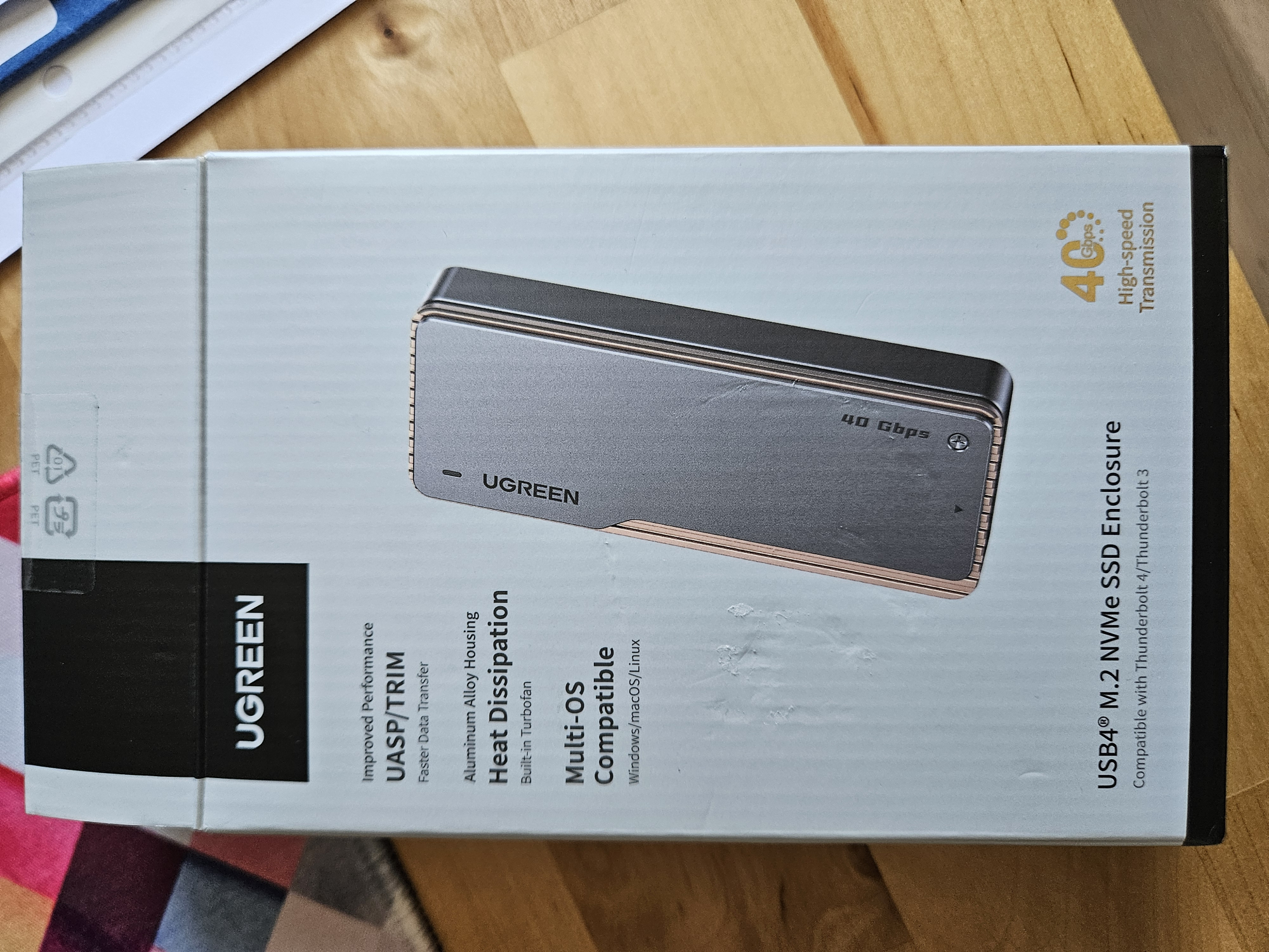

I think I've identified the problem!
Rufus 4.6 and Windows Install do their job perfectly: they install Windows 10 and Windows 11 on an external NVMe.
The problem is the NVMe support and its connexion speed.
The installation and use are perfect when I connect:
1) ✅ an SSD in SATA<>USB to my MacBook Pro 16" (2019)
2) ✅my NVMe Samsung 980 Pro connected to my MacBook Pro 16" (2019) via ACASIS NVMe M.2 PCIe 10Gpbs USB-C
BUT THE PROBLEM APPEARS with my brand new ❌UGREEN USB4 M.2 NVMe SSD Enclosure 40Gbps USB-C
Now, either I buy and try an ACASIS 40Gbps or try to install my NVMe with Windows functionnal (installed thanks to ACASIS 10Gbps) into the UGREEN 40Gbps.
Any help/idea ?🙏🏻
