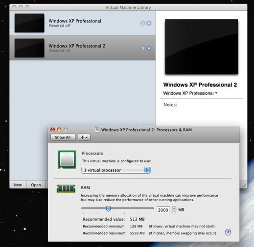

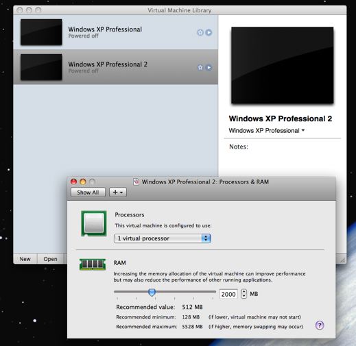

I have a couple more questions about this please...
1) TWO XP PRO's: You can see by the screen capture I attached that it looks like its showing TWO instances of Windows XP Professional in the Virtual Machine Library. Is that supposed to be there or did I somehow accidentally install XP twice? And if dumbass me installed Win XP twice, can I delete it by opening it from the Virtual Machine Library and then drag the one I don't need into the trash can?
2) RAM: I have 6gb of ram on this Macbook Pro 17. One of my Windows programs requires a minimum of 1gb of ram. So considering how much ram is used by the Mac side, plus Win XP, and plus the ram used for the program (1gb+), how much ram do you think I should allocate to the virtual machine?
Thanks again!
Steve
