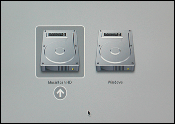

Also, what do you mean by the OS selector? That doesn't sound like the normal XP boot process. Does it look like this?
no, thanks thoug, it just says Microsoft Windows Xp, 25 seconds type thing. its a new harddrive i didnt install mac again. thanks again for the help
