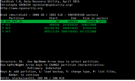

I am having a problem that all of my partitions in my external hard drive are all gone now. I have fellow your code above there, however I only able to retrieve the first partition, is there any possible way that i can retieve other partitions as well? My harddisk is a 2TB , and the size other of the partition is under the fellow: 200GB , 50GB and 1750GB
the attachment is the orginal partition layout i find it out using test disk

HI Detrius ? are u still here?
It's excellent that you have the precise start blocks and lengths, thanks to testdisk, which is actually a tool I had used a long time ago, back when this was still my job. The directions I had originally given were for a drive partitioned as a single volume, and they were based on Apple's default partition structure way back then. I don't knoww if it's still the same (no reason for it not to be), but since you have the precise layout, thanks to testdisk, you can manually recreate the partition table. The directions will be similar, but the last line is where you'll start making changes. The information about the above commands is available in the man page for the "got" command, but here's the stuff you need to know (going off the top of my head):
-i sets the volume number. You'll increment this by one for each volume you add.
-b is the start sector, which you'll find in your table. You'll notice that my values matched up with the first two entries in your table.
-s is the size of the volumes in sectors. I didn't specify a size for the second volume, meaning it should extend to the rest of the disk, which if I remember correctly is always a hair too large, but it gets the job done in a generic way on single-volume drives. Instead, you'll specify the value in your table for each volume you create, and then you won't have volume size errors left over for Disk Warrior to fix.
-t is the type of volume. The value I specified for the second volume represents HFS, so you'll use this for the second volume and beyond. Additional values are available for reference in the gpt man page.
Using this information, you can create a series of "gpt add" commands to recreate the volumes on your disk.
Hope this helps!
