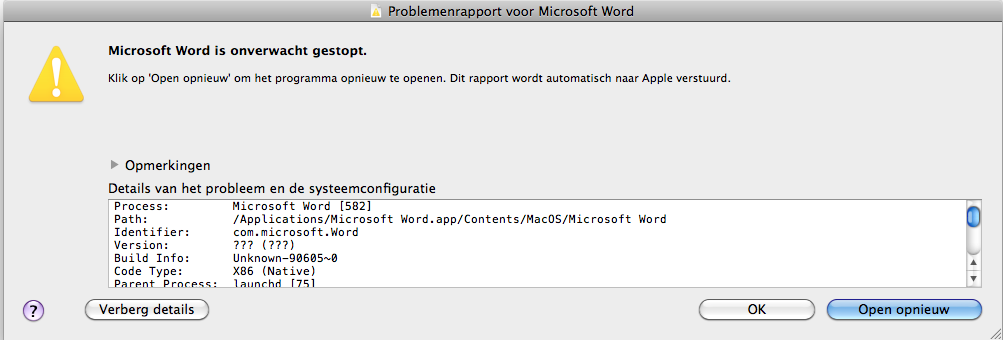

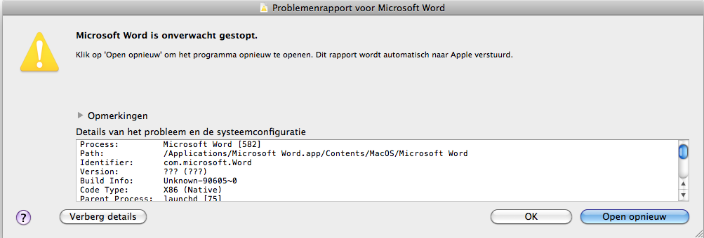

Microsoft Word refuses to open since yesterday morning on my MacBook Pro 13''. I'll attach a printscreen of the error I'm getting everytime, but it's in Dutch. It says "Microsoft Word stopped unexpectedly".
I hoped to fix this problem by re-installing Microsoft Office, but:

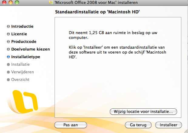

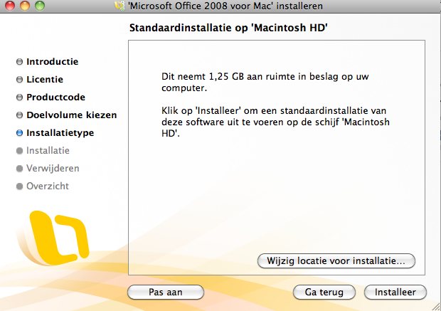

I've been having problems installing new programs for a while now (including Microsoft Silverlight, flip4mac). Everything goes along fine, until I get to the Install-button. I can click the button, but it won't proceed from Installation type to Installation (I don't know if I'm getting the titles right, I'm translating them literally). It's really annoying, since I really really need Word to study.
Is there anyone around who can tell me what's the error in the Installation program? I'm don't think I'm doing anything wrong, since it's always worked before, and I recently succesfully 🙂 installed programs on another MacBook Pro.

To confirm I'm understanding correctly: When you click the "Install" button nothing happens, or is Installer crashing at that point? I assume you're not forgetting to select which drive to install the software on--if there's more than one, there will be a screen with the available drives.
Word is a straightforward crash, even if I can't read the text.
Most obvious thing to try: Confirm if it's a user prefs issue or something systemwide. To do so (I'm assuming you can figure out the Dutch equivalent names of everything):

That's right, absolutely nothing happens when I push the button. I'm not forgetting to select a drive.

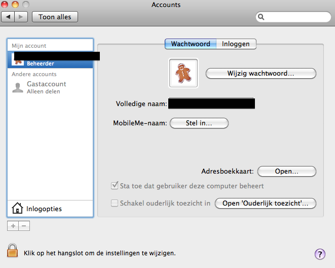

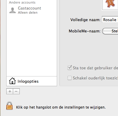

I can't create a new user name. If I get to the Accounts preference pane, the "guest account" icon is grey and unclickable. I also can't unlock the padlock in the left corner. If I click it, a line very briefly appears that says "Identity control" and then it's gone again.
This probably sounds all very newbie-ish, but I'm thinking the installation problem is caused by the fact that I have never added a password to my own account, and therefore am not allowed to administrate anything. (I might be wrong though 🙂!)
(The reason I'm thinking this is because I think you have to add your password after clicking install, or at least something like that is supposed to pop up, right?)
If I'm all wrong, please tell me. All I know is that I can't add an extra account 😕

Ahh, that's starting to make more sense--your guess sounds correct, that the authentication system is completely failing, so anything that would normally ask you for a password (unlocking system prefs or installing software) fails instead of displaying a password dialogue. Your screenshot looks like you do have admin privileges, which is good.
No idea how you managed to create an account with no password, but the first thing to try is resetting yours.
Here's the Apple Knowledge Base article on it; you want to expand the second section, where it explains how to reset the password for the original admin account:
http://support.apple.com/kb/ht1274
(I notice, also, that it specifically says not to create an admin user with no password; this is a security hazard, but maybe your problem is why.)
Short form, boot the computer from the OS install disc and run the Password Reset utility from the Utilities menu in the OS installer. This won't fix your keychain--you can take care of that later since you do actually know the password for it, or lack thereof--but it will reset the password on your account to something non-blank.
Log in and try with the new password once you've done that. Hopefully it all starts working now.

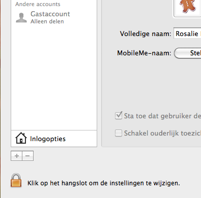

OK, I've done that. Now when I turn on my computer I get asked for my password (which has never happened before) and I can proceed after filling in the password. However, I still can't create a new user, seems like nothing's changed there. I think I need to unlock the padlock (is that even the right translation? 😀) first, but it won't budge.
Do you have any suggestions on what to do next? Since it's 2 o' clock at night I'll probably fall asleep quite soon, but I'll respond in the morning 🙂
Yes, unlocking that padlock is what you would normally do--you'd click on it, which brings up an admin password prompt. Which isn't what's happening, it would seem.
(For reference, once you get your Mac working, clicking on Login Options (the house icon) will give you the option to automatically log into your account when the computer is turned on. Won't work until you get admin authentication working again.)
The hard part here is that it's not clear whether it's just your account that's messed up, or if the OS install is--if it's the latter case, you're going to need to do a reinstall (which isn't that painful generally--your settings will all be preserved). If it's the former, then a reinstall won't help unless you also create a new user in the process from which to diagnose the problem.

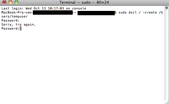

Let's see if authentication via the command line works, in which case you should be able to create a temporary admin account.
Unless somebody else posts an easier suggestion than this, anyway.
Open up Terminal (it's in the Utilities folder in the Applications folder). Then carefully copy and paste each line below:

After copy and pasting the first line, terminal should ask you for a password; enter the one you just created, and hopefully it'll execute the command.
If so, continue with each line until you're done. At that point, there should now be a second user called "tempuser" with the password "password". Log out of your account, and it should appear in the list there. Again, if so, log in as that user and try going to the System Preferences and clicking the lock.
If the lock actually responds with a password prompt from this clean account, then we'll know there's something wrong with your account and can work on that.
If you still get no prompt, time for a reinstall.
And if the commands listed above do not do anything, then presumably the authentication system is hosed and it's also time for a reinstall.

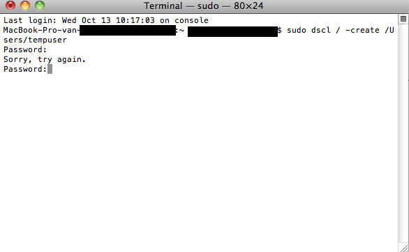

I've opened the Terminal, copied the first line, and I get asked for a password. Unfortunately, from that point on I can't type in anything. The text cursor (or what's it called? the vertical line that indicates I can type) stands next to Password, but nothing I type or copy appears in the screen. If I click Enter, I get
Password:
Sorry, try again.
Password:
Grumbl

Hold on! The behavior you were seeing is completely normal--it by design doesn't show what you type.
Just type the password you set blind and hit return--it should execute the command. This is good, because it looks like at least sudo is working correctly (the system would have to be pretty hosed for it not to.)

If I just type it in blindly and hit return, it says:
sers/tempuser
Password:
Data source (/) is not valid.
(I just have to type my normal account password which I created yesterday, right?)

Ok, that means that the command executed properly, it was just the wrong command--I confess to having just copy and pasted the instructions from that site, but I just checked and indeed that doesn't work.
Hopefully someone else will chime in with the correct method of creating a new user from the command line, otherwise I'll try and figure it out in the morning.
Follow-up: This might be an easier work-around; the following command should cause the OS to re-run the initial setup the next time it is rebooted, which, I think, will allow you to create a new user account.

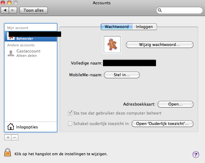

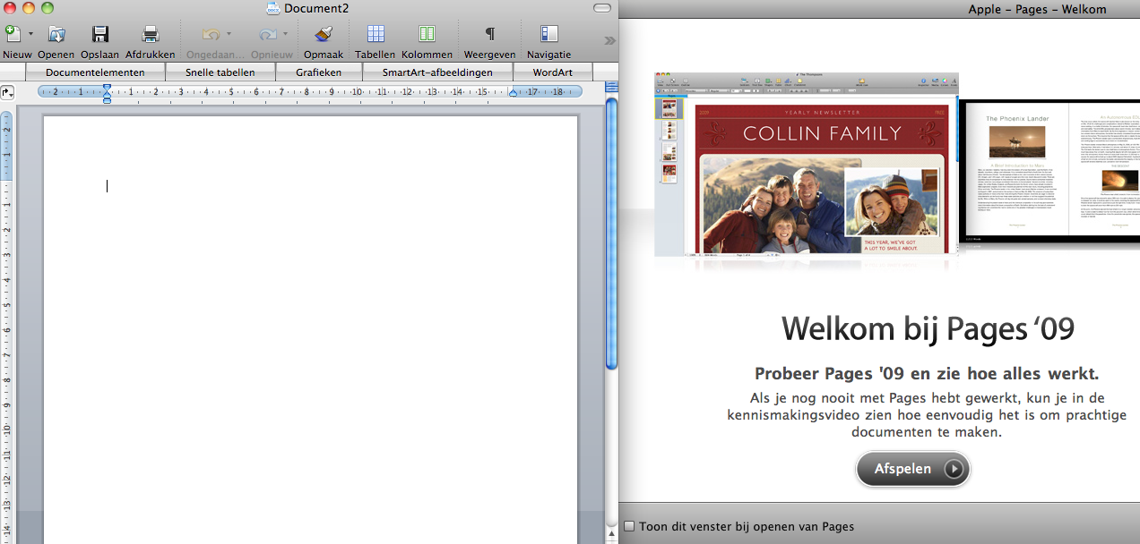

IT WORKED! 🙂🙂
I created a new user, the way you told me to in your last post. My old account still works and nothing's disappeared. (I just checked. By the way, I do back-up my important files every now and then, I just don't have enough space for all of my music on my external hard drive, so only that would be lost 🙂). I installed Microsoft Office on Account No. 2, and it worked! It didn't stop at Installation Type like it usually does, a screen popped up where I could type the password. Word is working again!
Even better:
I just downloaded the trial of iWork to check if the problem is totally solved (which I couldn't install on my old account due to the installing issue) and it worked perfectly, just like the Office-installation.
This means (hopefully) that all of my problems are solved. Thank you very much for your time and patience!! 🙂

Glad to hear that. Seems that something was screwed up in the preferences of your old account (I'm assuming you still can't authenticate in it).
You'll probably want to completely fix the old account as well now, for which you have two options: Either identify the preference that's causing the issue and delete it, or just create a replacement account and migrate everything you know you need over to it.
You could try using your new admin account to make your old account NON admin, and see if that was enough to fix it--might alter a preference that's causing issues, maybe. If so, it'll probably stay fixed when you switch the account back to admin.
Or log into the old account, drag the entire Preferences folder within the user's Library folder to the desktop (or some other location), log out, log back in, and see if it works normally (your desktop and everything else will have reverted to the default). If that fixed it, you know the problem preference is somewhere in that folder; you can then put the old one back (and log out/back in) to get back to where you started, and try to locate the relevant bad file and remove it.
