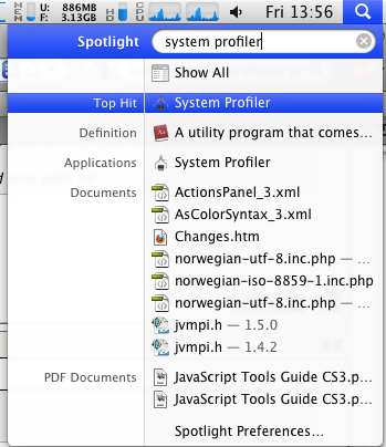

open up system profiler and use the information listed on the first window to find your machines specs then check those against whats listed on the sites listed above
see attachment 😉
