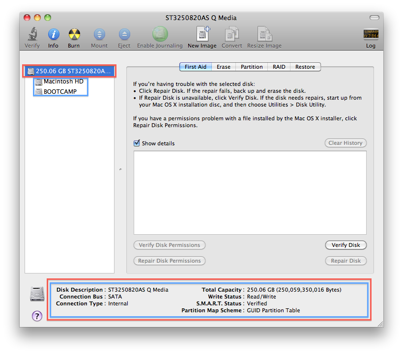

Have you tried selecting the actual HDD, which has red rectangle in the below screenshot?
It seems you still select the actual invalid volume, now called "disk0".
Yes I selected that and the one below where it says "Macintosh HD" on your screenshot, it says "disk0" on mine.

You should be able to get at the Partition and Erase options if you have the disk itself (the red rectangle) selected. You don't want the actual volume (blue rectangle) selected when you do that.
