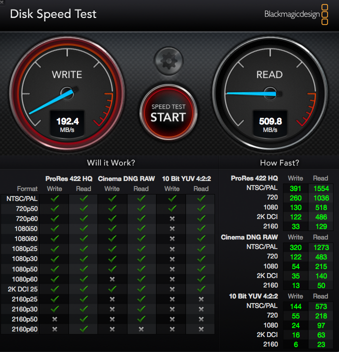

Installed a Sandisk SSD in a mac mini 2014 and my speeds seems sloooooow
Disk test speed Im only getting around 150MB write and around 500MB read speed
No idea what is wrong, but the 2014 Mini should be a lot better than that (if you use the right kind of ssd). i have a 2012 mini with original Apple internal SSD and this is what I get. I'd expect your 2014 mini to be about 50% faster than my 2012 since it has a faster interface.

hmmm. even user benchmarks show better performance than what you're getting. seems most people get results in the mid-300s with this drive

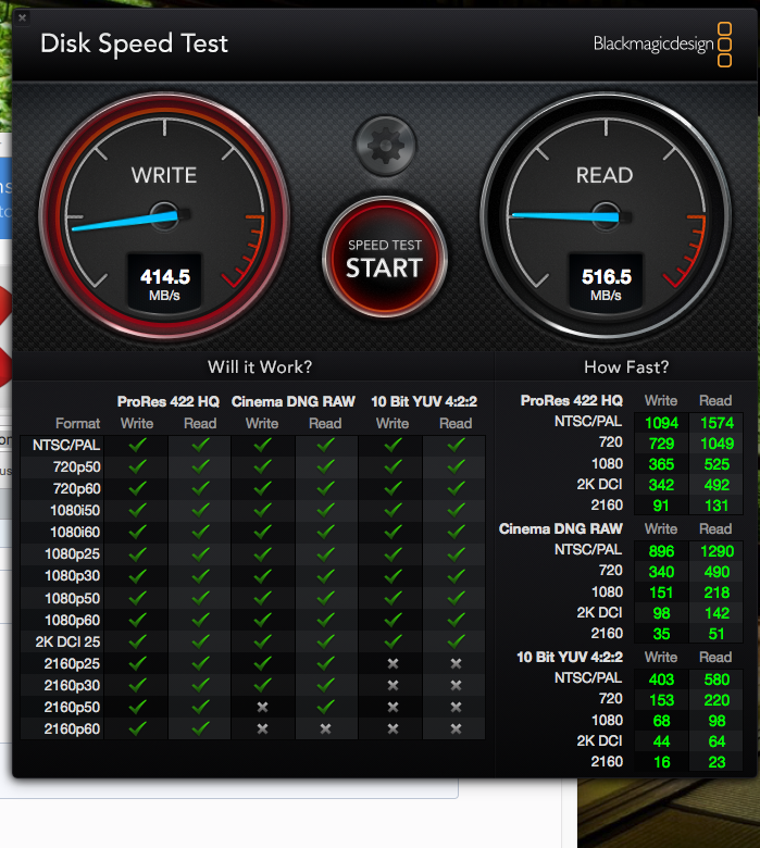

So i exchanged for the sandisk ultra 3d and my speeds are blazing now! Picture below

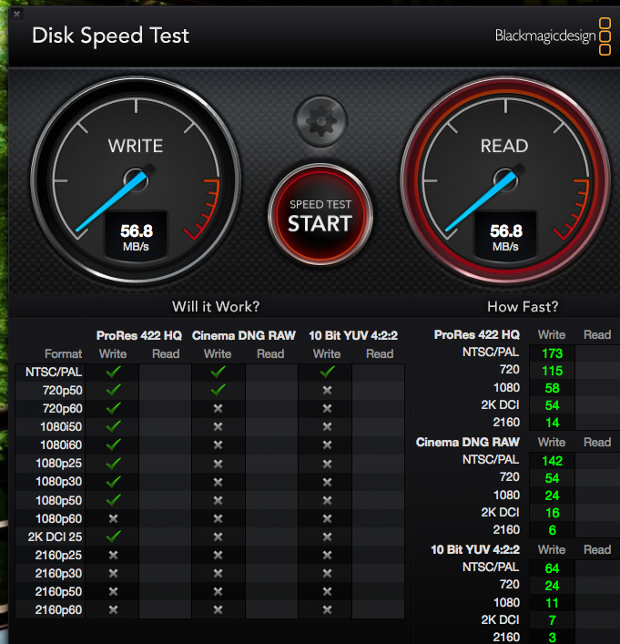

[doublepost=1527239915][/doublepost]Write to my external WD My Passport Ultra is slow though
I assume this is normal correct since it is not SSD? 2nd pic on right
I hate to burst your bubble... that's certainly better but those speeds aren't "blazing", they are the same as my 2012 Mini. But the 2014 Mini has a much faster interface and I think the SSD should clock about the same as my 2013 MacBook Air: ~700 MB/sec write and more than 700MB/sec read. I don't know a lot about the internals of the Mini, but have read that you need to get the correct kind of SSD and connect it a certain way to acheive this kind of result.
As a practical matter, the speeds you're getting are still pretty fast and most people probably would not notice the difference in day to day use.
I also have a Passport Ultra, but mine got about 100MB/sec the last time I clocked it so that seems quite slow also.
The write speeds to the original Sandisk SSD were normal -- right where they should have been.
Reads were a little on the slow side, but still acceptable.
You'll notice that with the replacement drive reads are essentially the same.
The drive you have inside won't affect the speeds of an externally-connected drive.
I knew somebody was going to say something about me saying blazing.
The 700 speeds uses pcie ssd blades that is why the speed is higher. I plan to put a stick in for my OS only.
When I said blazing speed I was saying in reference to my past speeds before the upgrade so to me it’s blazing fast. And I certainly notice the blazing speed and loving it .
I’m going to get a pci ssd next to put in the mac mini to go along with my ssd drive then fusion them both
But for right now I’m loving my blazing speed and I don’t think the drive will clock over 550mb because the specs says that is the max but I’m happy with it now. I don’t need much more speed

The write speeds were slow and not normal because others reported faster speeds on the same drive
My read speed is a little higher now but really it’s faster then my other sandisk because of the technology and faster burst speeds with this new sandisk and it has double the cache and advanced 3D technology even though the benchmark test shows same speed .
My other San disk write speed was barely pushing 100mb after more test

You are referring to the PCIe interface with 700MB/sec speeds. The 2014 Mini also has a SATA3 interface and the OP's link in post #5 indicates that's he's referring to a SATA3 SSD.
SanDisk, in my mind, has confusing branding. So they'll have a SSD name, say, "Plus" but they might have variations on the model over the years and it may not be clear which specific model it is. It seems that the latest model of the "Plus" can be slower than what people expect of a SSD from what I read on Amazon reviews. SSD capacity also plays a role. In the SanDisk SSD Plus link in post #5, SanDisk itself says the 120GB model has 70% the write performance of the 240GB model. To me, 150MB/sec write is slow. A 5400rpm external USB drive which I keep connected to one of my computers has 100MB/sec read/write speeds. As I've said in other posts, Blackmagic is a simple benchmark but still, the 150MB/sec write for a SSD, given that there's no other disk activity taking place on properly functioning system, is slow to the point where I would probably return it given a similar situation to what the OP is facing.
