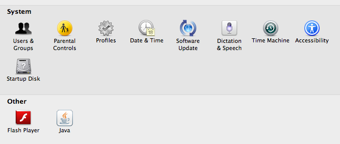

Here is my pref window.
Ah, thanks--that worked. It's confusing because Oracle is calling this the Development Kit, but it's needed even just to run Java-based applications like Cyberduck. Oh well--problem solved, thanks!

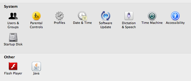

In 10.8.2 oracle has a separate preference pane for java.
[edit] nvm. looks like i installed the JDK [/edit]
