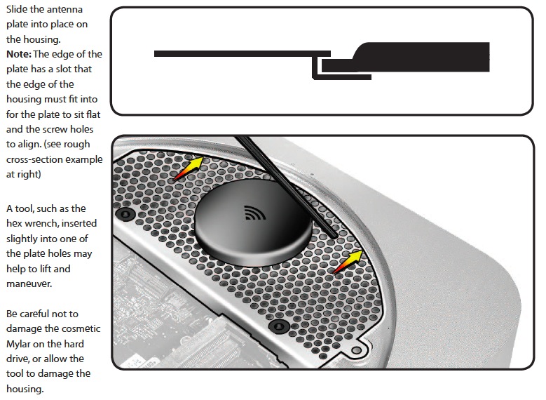

Need help please figuring out how to set the aluminum screen back on flush. When I installed new Western Digitial 750GB hard drive, I was unable to get the screen (mounted on top of drive) to sit flat.
The 2 outer screws can't both be installed, so I was only able to get 3 of the 4 screws back on, and the screen is not flat. So now the bottom Mac Mini cover also does not sit flat.
Need help! Any tips? Even Apple themselves after I brought in under warranty for SuperDrive replacement struggled to get that screen grill to sit flush. They crimped my Bluetooth wire and 2 of the screws were barely attached. Sloppy work from the Apple warranty tech...but now I know why he had issues.
(it's the silver screen shown in photo, above the memory chips)

You need to align the wifi grill properly on the curved edge with the curved edge of the mini chassis. There is a step (or lip) with two edges on the wifi grill curved edge. One under an one over the chassis edge of the mini.
You may have to bend the lip edge up or down to make sure there is a space between the two upper and lower edges so the wifi grill sits flush. It is likely the upper and lower edges of the wifi grill step are squashed together and it does not allow the edge of the chassis body to sit in-between the two edges of the wifi grill as in the photo.

Wow getting that screen on flat is no joke. Thanks very much for the help. Now I getting a better understanding on what the secret is to getting it back on flush.
