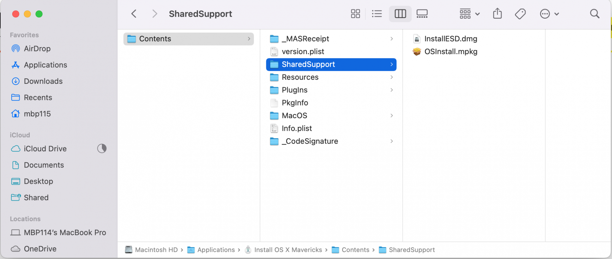

I'm unable to find the installesd.dmg for installing Mavericks on a bootable USB. I'm doing this carefully, so hopefully I don't screw something up which fails the installation.

Bootable Mavericks Installer
  • Click the image
  • Go to File Explorer / Finder
  • Find the Downloads
  • Find the Image you installed (screenshot012922)
  • Click Open
It is taking longer, I never had it in my Apple Account.
This image below shows it's been loading for 5 minutes, assuming it's invalid?

I would not assume it is invalid. It is just you never had it in your account In the first place.
try mas-cli:
Code:
// OS X Mavericks 10.9
https://apps.apple.com/us/app/id675248567?mt=12
// Install mas-cli:
brew install mas
// Or with MacPorts:
sudo port install mas
// Download Mavericks with mas-cli. Previous download may be required:
mas install 675248567
