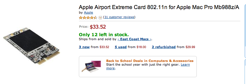

Thanks for all the help guys. Is this the airport card I need to buy? Its Amazon and I just don't want to order the wrong card. Plus I read it might be easier to attach the wires first, then pop int he card. Makes sense. Which 2 wires though? I've read different things on which wires are attached to it.

^^^^The link I posted above references that very card. The supplier in the add you posted states:
Technical Details:
802.11n 2.4ghz and 5ghz wi-fi adapter
Cutting-edge chipset
Higher speeds with lower energy consumption
AirDrop Supported with speed up to 450Mbps
Compatible with all Mac Pros
-Mac Pro 1st generation, 2006
-Mac Pro 2nd generation, 2007
-Mac Pro 3rd generation, 2008
-Mac Pro, 4th generation, 2009
Requires Mac OS X 10.5.6 or later
2 Installation screws included
So, it appears to be the correct card.
Lou
