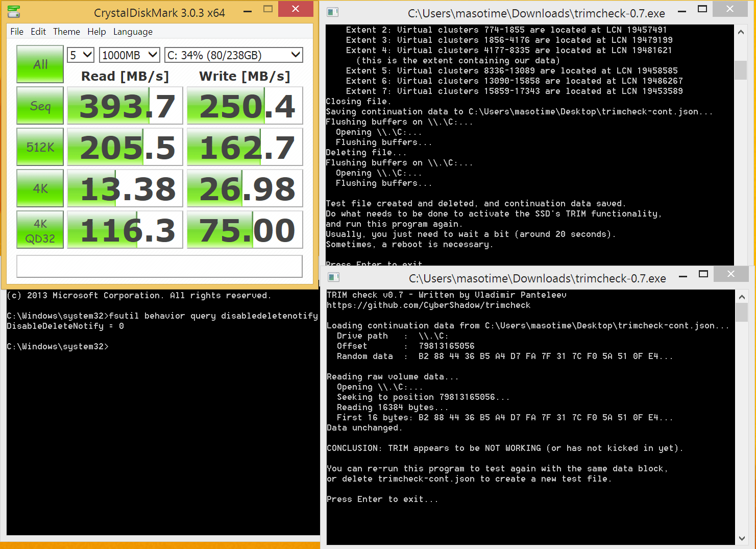

Here's a pic of Windows running off the Inateck on USB3. The only bad part is that TRIM is not enabled via USB3, which can be troublesome. fsutil reports otherwise, but running TRIMCHECK (I waited about 2 minutes) shows that TRIM is not enabled.

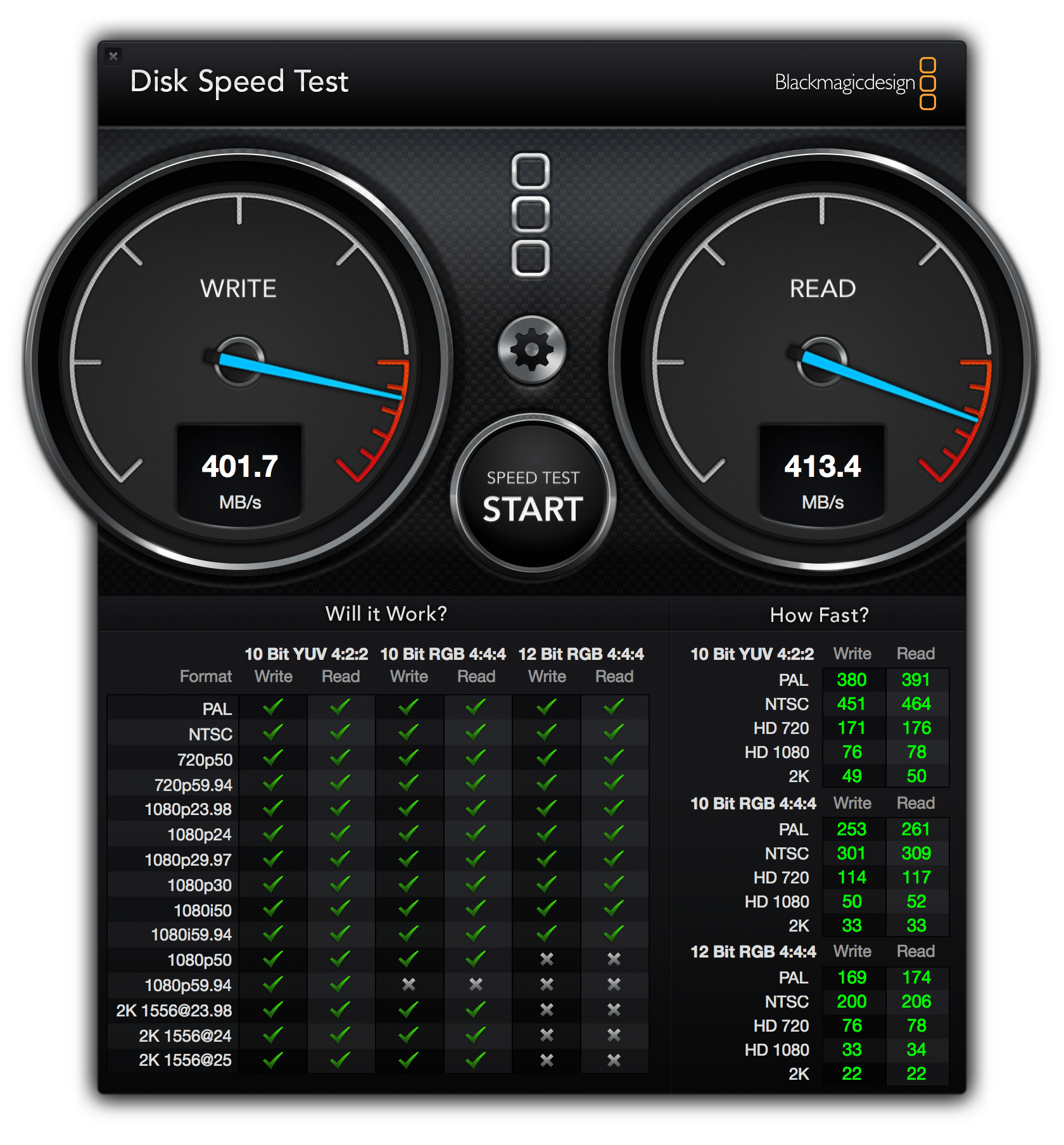

Also recently snagged a M500 950GB for $329 on OWC (it's now $335, still a great deal with free shipping and no apparent sales tax). Grabbed a newer model Inateck FE2005 (http://www.amazon.com/Optimized-Tool-Free-Inateck-External-Enclosure/dp/B00KYF1LLI) and got some pretty good Black Magic Speed test results:
Looks like a great performer! I probably won't be using this as I already have a spare LaCie Rugged TB lying around that I'm planning to put Samsung EVO 850 in. Did you have to plug in the power brick or was it working purely with bus power?
It was running purely from Bus Power. If you're not looking into running Windows, I've found that using the "Erase Free Space" option in OSX Disk Utility is equivalent to running TRIM manually. Googled a quick guide here: http://osxdaily.com/2013/08/21/erase-free-space-hard-drive-mac-os-x/

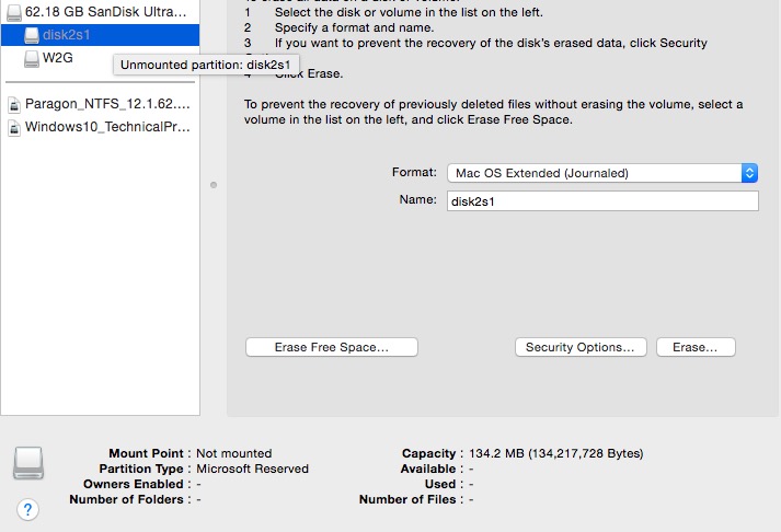

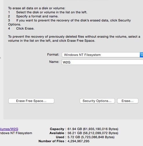

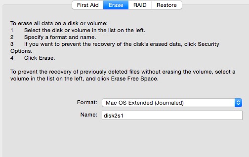

Okay went through your instructions with zero issues after the dummydisk driver but after reboot the drive doesn't appear in the boot menu. Here is what my 2 partitions look like.
