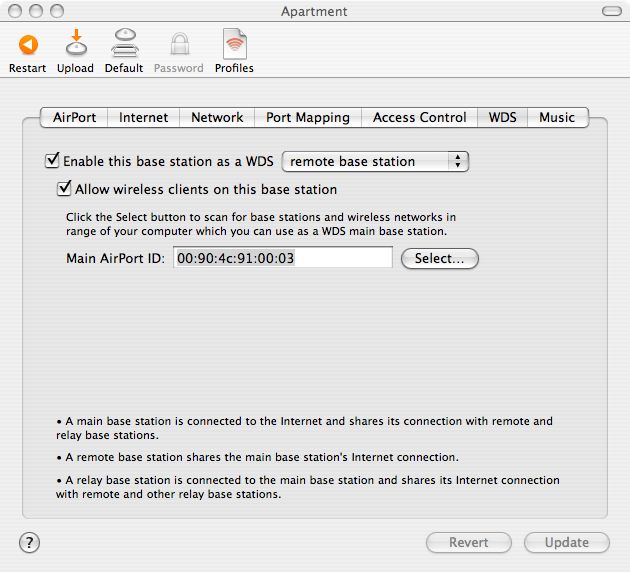

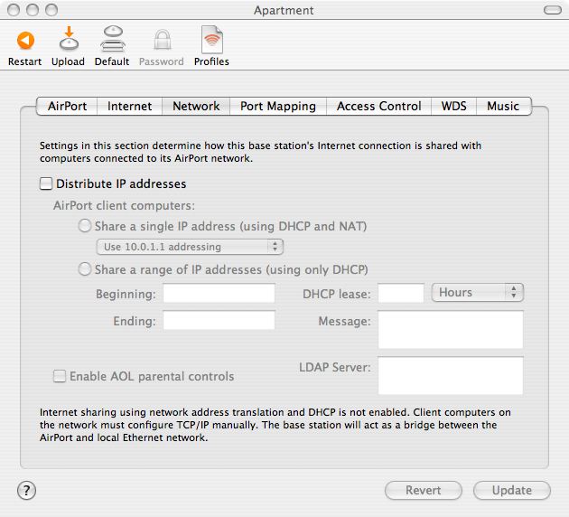

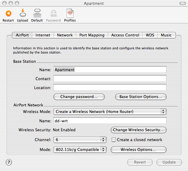

I have an Airport Express in WDS mode to extend my wrt54g coverage to our guest apartment. Works great. Just google (airport express WDS) and you'll find a couple guides. Initially you have to configure it using the ethernet connection and set it to it's own ssid (new network), not the same one as your router, although you put it in WDS mode and assign the router's MAC address. You also have to make sure you turn of DHCP on the AE, as the router will be providing the IP addresses and internet access. Once you have it set up and tested, you can change the ssid to match the router.

Here's screen shots from Airport Admin showing my config. I think everything relevant is shown. I believe you are limited to WEP security. I'm in the middle of nowhere, so I don't bother. You can always use MAC address filtering on your router to prevent someone hacking you easily. Note that on the Airport screen, I've already changed the ssid to match my router; you want to start with something different. Also, you have to set the channel number to the same one your router uses. Finally the MAC address requested on the WDS screen is the address of your router's wifi interface. HTH
