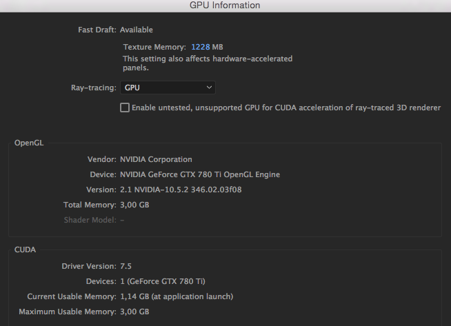

What I think he meant was the hardware accelerated panels using the GPU texture memory (see pic below)
Particular is not hardware accelerated but Element 3D is
