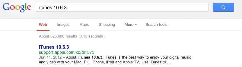

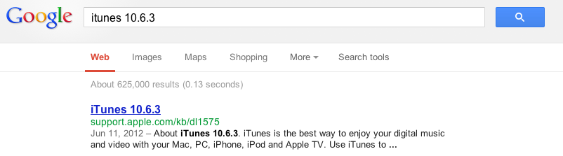

Great I did a clean install everything seems great except itunes gave me an error of 11333 when I tried to log in. Any ideas? It wouldn't allow me to search my password either.
Thanks again Linda
I thought maybe it needed an update but when I tried to update it said:
The iTunes update server could not be contacted. Please check your internet connection, or try again later."
I'm puzzled. Maybe I need to just download the last version for leopard for PPC, but not sure which one it is. Anywone know?
Thanks Linda

OMG this is never ending now after updating OS & iTunes all night (finally restarted at midnight) back to same problem now it says:
"iTunes requires QuickTime 7.5.5 or later. For more information on upgrading your computer, visit http://www.apple.com/quicktime"
After locating a link on CNET for 7.5.5 which I felt was a trusted site it installed a program called Wiseconvert which I don't want (Can I just find where it installed and delete it?
Back to square one, where is a safe place to download QuickTime 7.5.5 I can't run iTunes 10.6.3 without it.
Now I'm wondering if the Leopard install was a good idea or not.
Running Leopard 10.5.8 right now. Yes Google is my friend but where is a safe place to find the real deal QuickTime 7.5.5????????
Frustrated at this point,
Linda
Finally found it:
http://support.apple.com/kb/DL27?viewlocale=en_US&locale=en_US
I think it's going to work,
Linda
