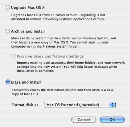

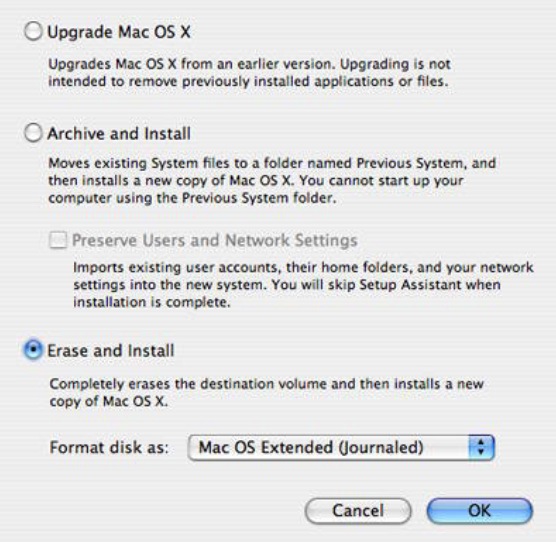

When any previous version of OSX exists on the drive that Leopard is being installed onto, the default choice for installation is the "Upgrade" method.
You just missed where the method is changed- which is easy to miss as it is not obvious by any means. When you get to the screen that shows you the window of eligible drives (even if there is only one BTW), there is a button at the lower left marked "Options". If that is clicked you are presented with the choices to install via. Below is an example of that screen (although mine shows Erase and Install selected because I took this screenshot for another post, the default is the top one-- Upgrade Mac OS X). After you make your selection there and press OK, the installation proceeds to the next step (the summary step in which you can press the "Customize" button at the bottom if you want to leave off particular languages, etc.).
