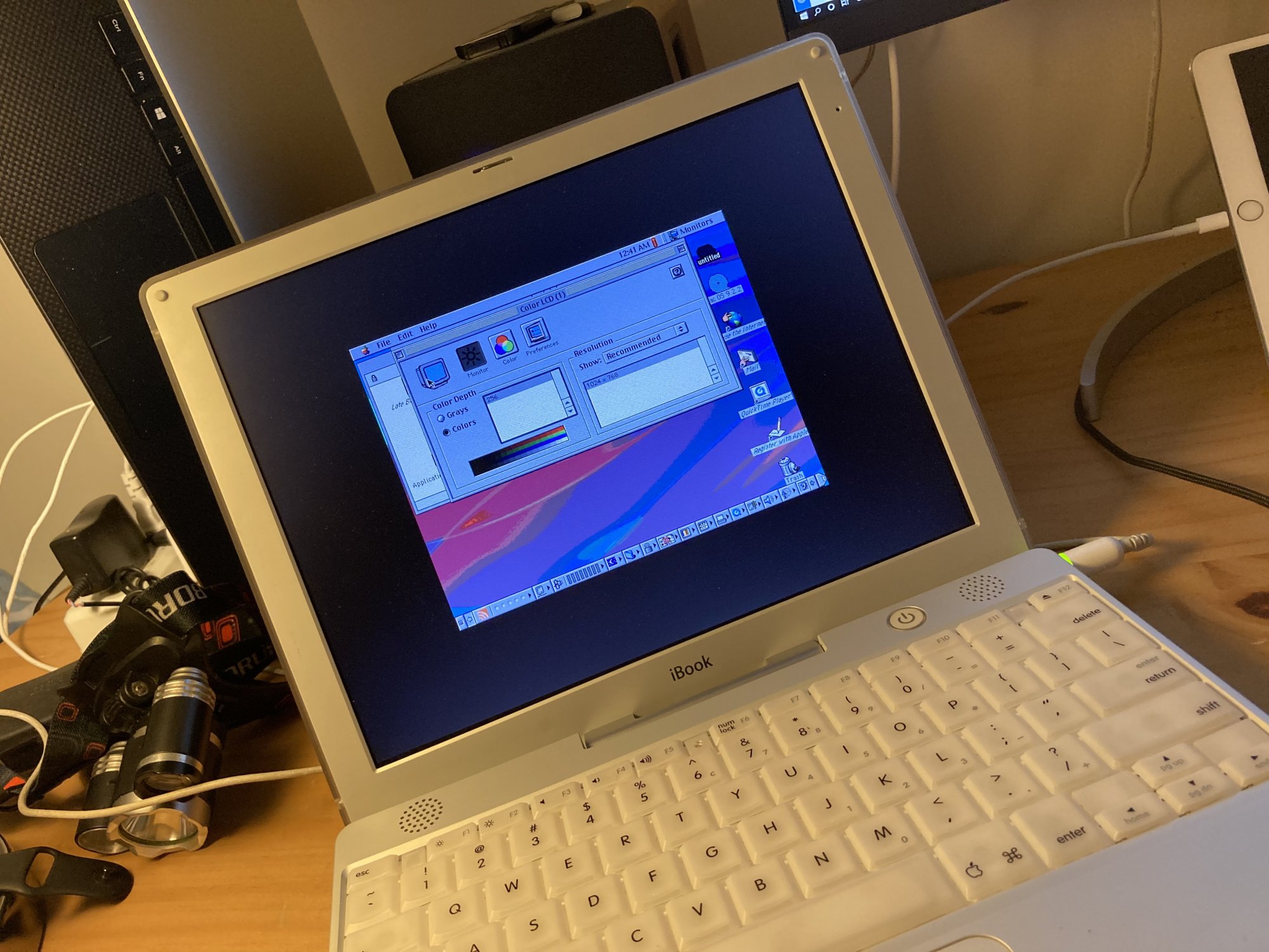

does anyone know why the screen is like this and how to fix it?
This is the OS9 I used to burn onto a CD to install: https://macintoshgarden.org/apps/mac-os-922-universal
