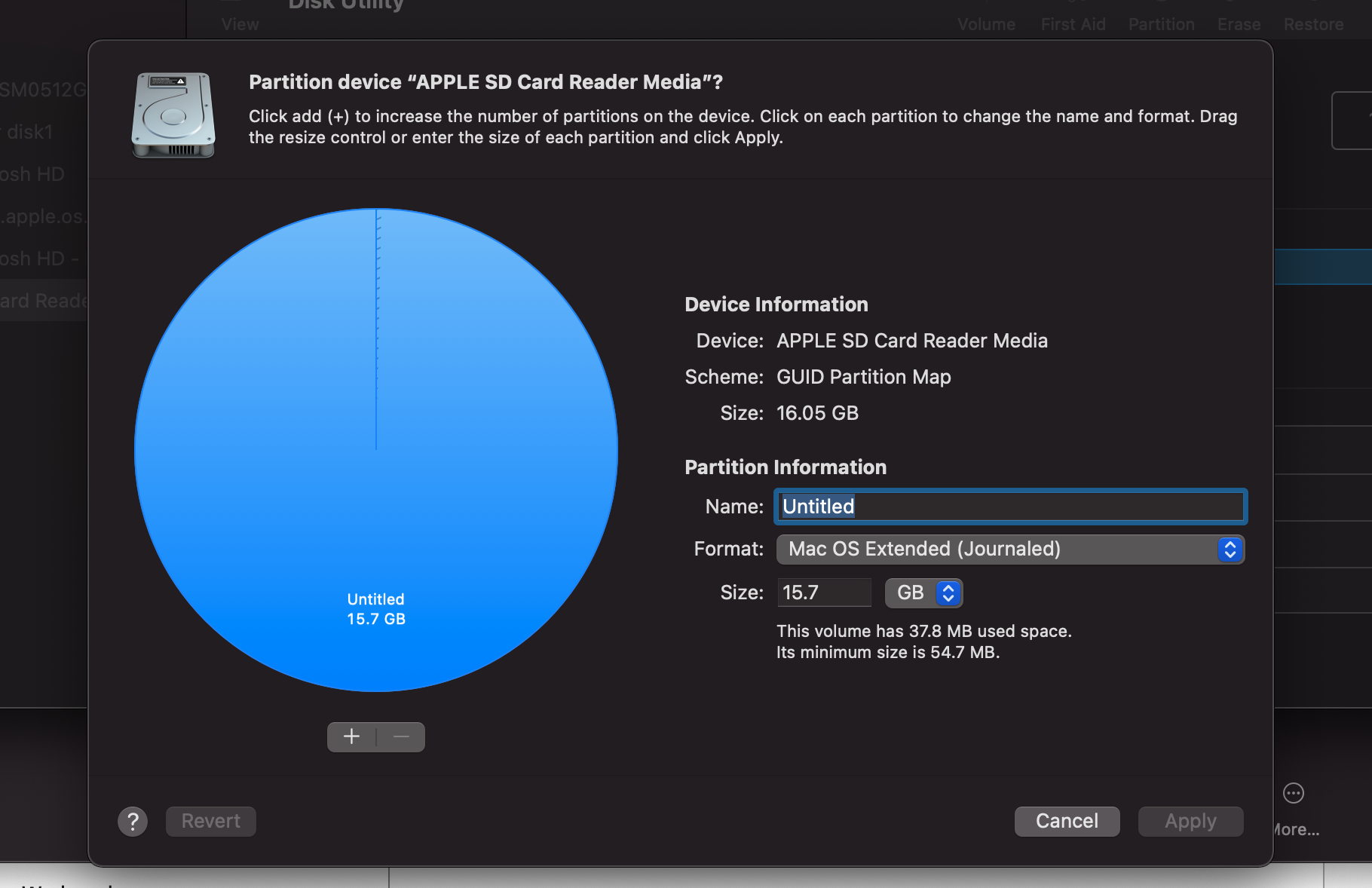

If you've been using macOS, I'd suggest trying to restore the 10.5.4 or 10.6.3 DMG to the USB drive using Disk Utility's Restore feature instead. Before using it, make sure the USB drive is partitioned using the "GUID Partition Table" scheme and only contains one big partition formatted as "Mac OS Extended (Journaled)".
Then, double-click the DMG to mount it and use the "Mac OS X Install DVD" volume as the source and your USB drive's partition as the target.

The flash disk can be formatted correctly no problem Screenshot 2022-04-12 at 18.35.07.png

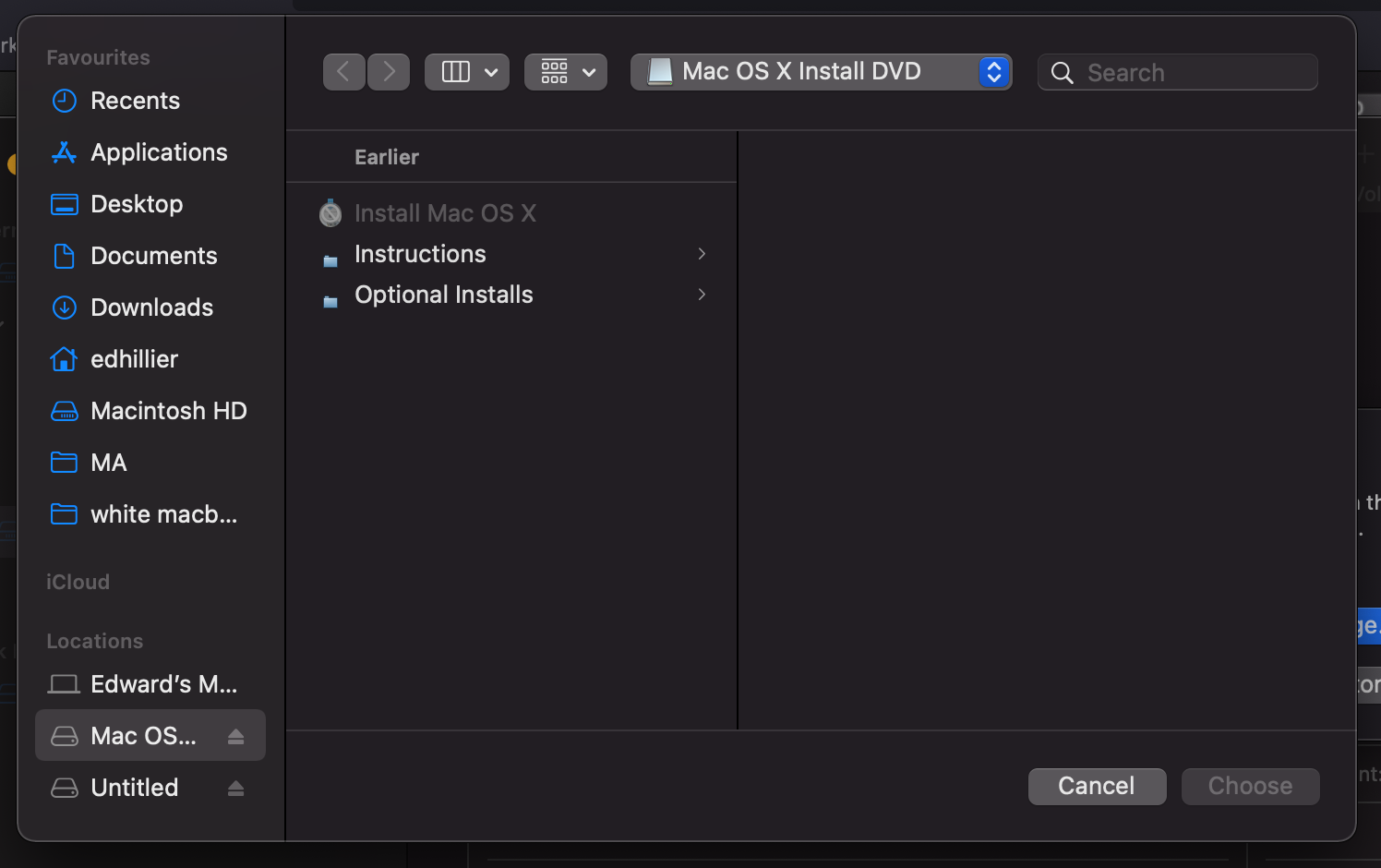

However, when the DMG is mounted, if I begin the 'restore' process and try to select the 'Mac OS X Install DVD', then 'choose' is greyed out:
I guess this is because this software is too old to run on the machine I'm trying to do this on (2015 Macbook pro), right? Many thanks!
I see. Try unmounting the DMG and selecting the DMG itself as the source. If that also fails (I have a feeling it will... Disk Utility just ain't what it used to be), try restoring the contents of the "Mac OS X Install DVD" volume to the flash drive using SuperDuper!: in its window, select "Copy Mac OS X Install DVD to Untitled" and click "Copy Now".
No, the contents of the image are irrelevant. It should™ do an exact block-by-block copy regardless of the contents.
