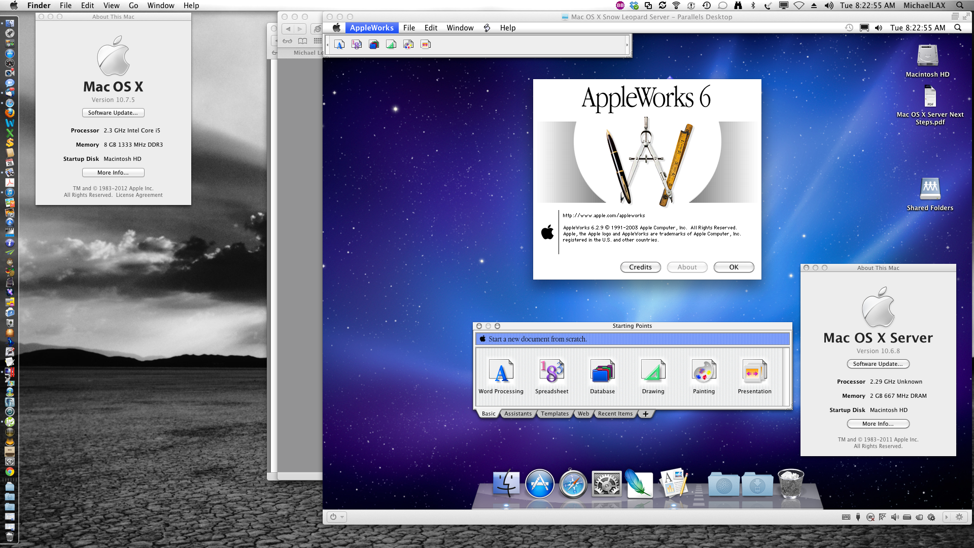

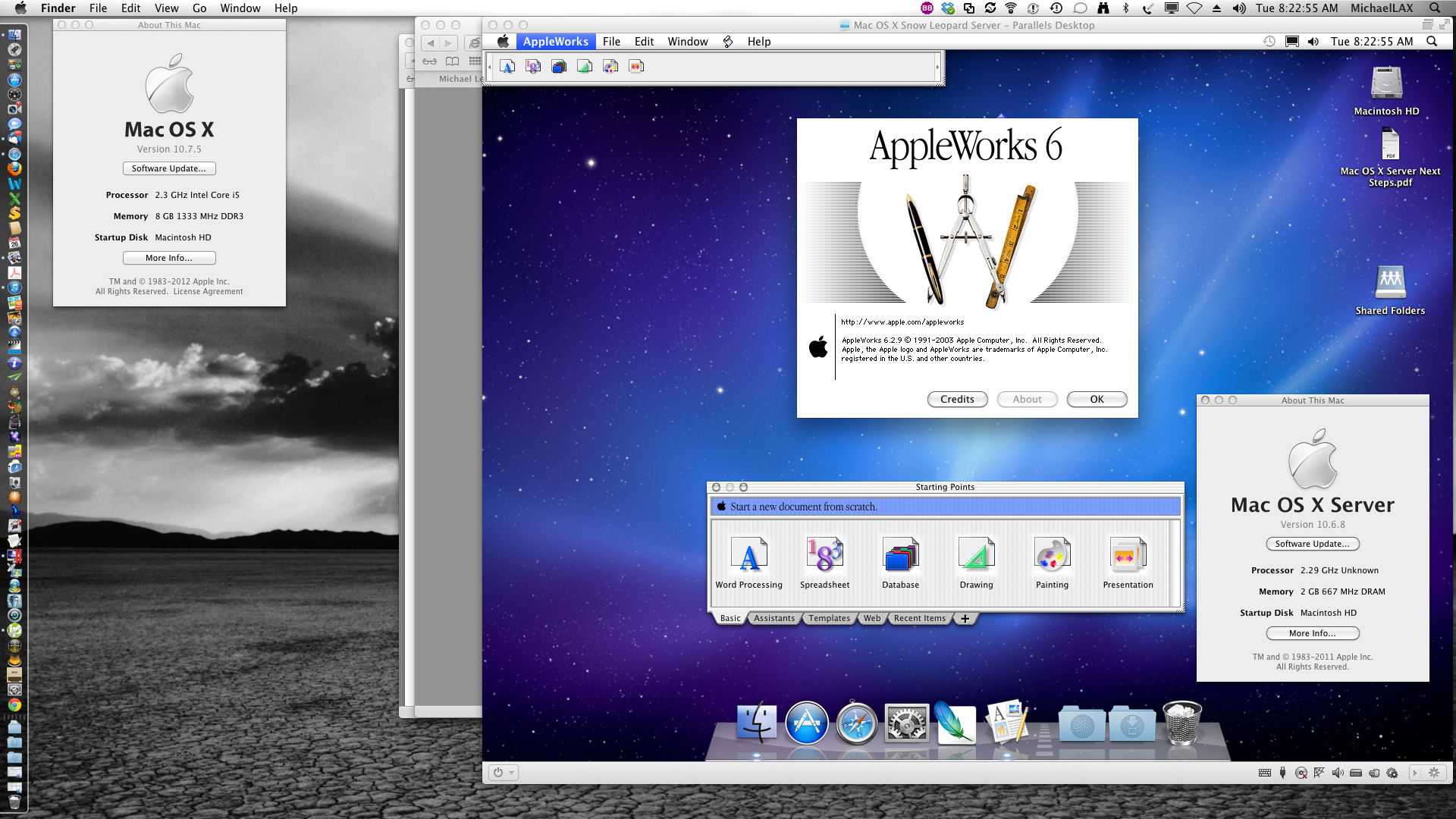

If you have an absolute reason to run Appleworks 6 in Mavericks (such as database and some graphics files), as noted installing Snow Leopard into a virtualization program, such as Parallels, will allow you to run Appleworks 6.
Snow Leopard can be made to install and run in virtualization, but it is much easer to install, run and maintain Snow Leopard Server; and its price is now the same $20 as the client version.
There is no functional difference in running SLS in virtualization; just ignore the Server apps (I actually remove them from the Dock so as to not be confused by them).
[click on image to enlarge]
