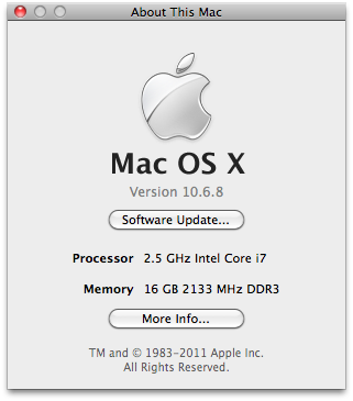

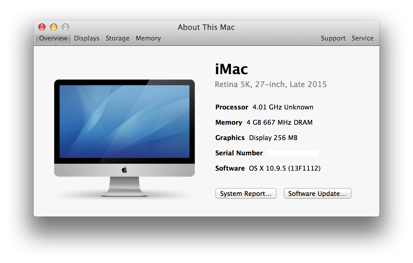

I have a Late 2011 17" MacBook Pro what had been released with Lion 10.7.2. Installing Snow Leopard 10.6.3 from a DVD for all Macs did not work.
So I tried another way. I just put my SSD into a Mid-2010 white MacBook installed 10.6.3 updated to 10.6.8 and put the SSD back in the MBP.
Runs perfect without any problems, even with my 16 GB 2133 MHz DDR-3 RAM upgrade. 🙂 With an SSD 4 GB of slower RAM would even be enough for me on Snow Leopard.

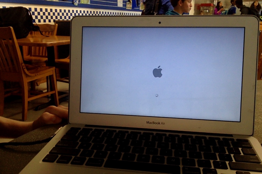

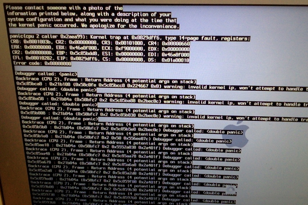

[doublepost=1463499499][/doublepost]UPDATE:
Got to the loading wheel while it freezes after a while its a start 🙂

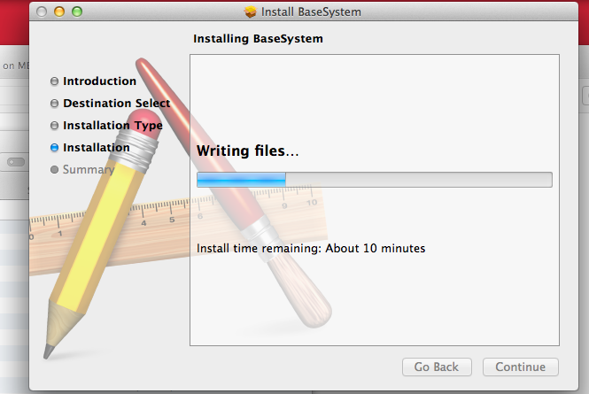

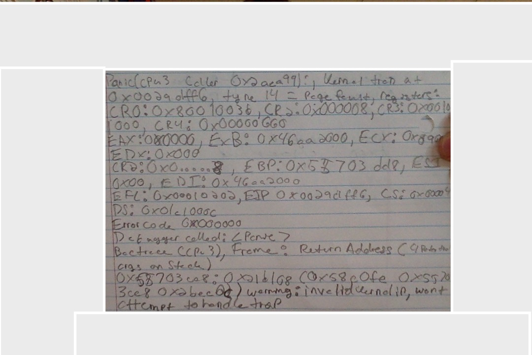

Trying to install it manualy through packages (in system/instal.../packages/) to another partition and then try booting up 🙂 fingers crossed

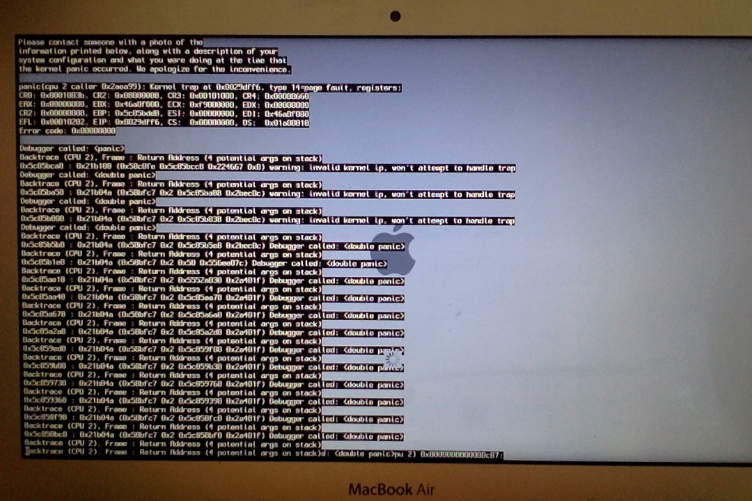

Update:
Installing SL in vbox on a physical drive, plan to then boot from that physical drive after adding some kexts...
wish me luck 🙂

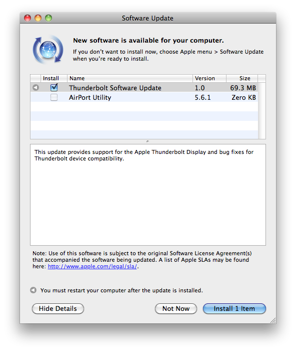

No I am installing the updates and after that I'll pull the SSD out an connect it via Thunderbolt to that one:
http://www.everymac.com/systems/app...5-17-late-2011-unibody-thunderbolt-specs.html

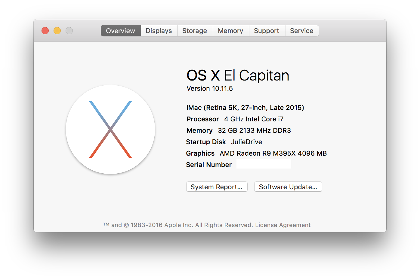

Here is a picture when I started installing the updates. I always forget the video intro of Snow Leopard. It's is really great. I love it. 🙂
Edit: Now the updates are finished and it's on 10.6.8 but after the first relaunch there are eight more updates to install. Mostly security and another new iTunes version.
[doublepost=1463556484][/doublepost]Im am posting now from:
After installing the last update, what did not show up on the older MacBook:
That were the last updates I installed on the other one:

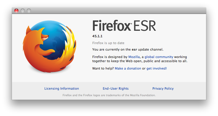

Edit: It's booting and running really fast from a Samsung EVO 850 connected to a Thunderbolt port.

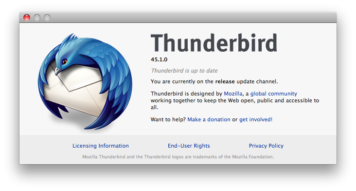

Now I am installing Firefox 45 ESR, remove the password if possible, clean Safari and all other cashes and clone the clean install to an image file when I am back in El Capitan.

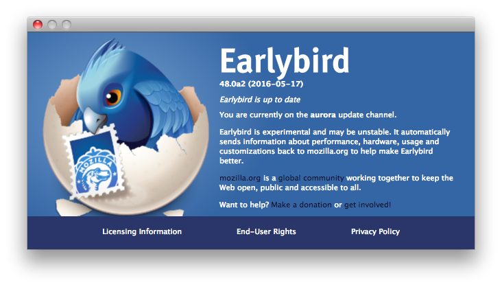

[doublepost=1463558507][/doublepost]The latest version you can run on Snow Leopard is version 48, what is the latest Developer Edition and an alpha version:
49.0a1 (Nightly) is not able to start anymore. The current version is 46.0.1, the beta 47.0, but I think the best is using that one because you get at least security updates until... (I don't no), but longer than updates for the normal Firefox:

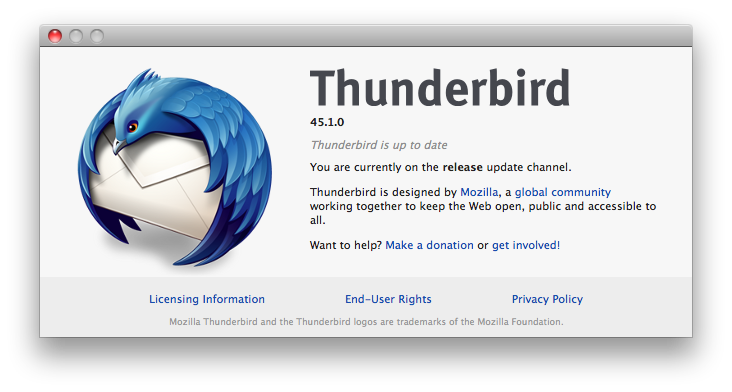

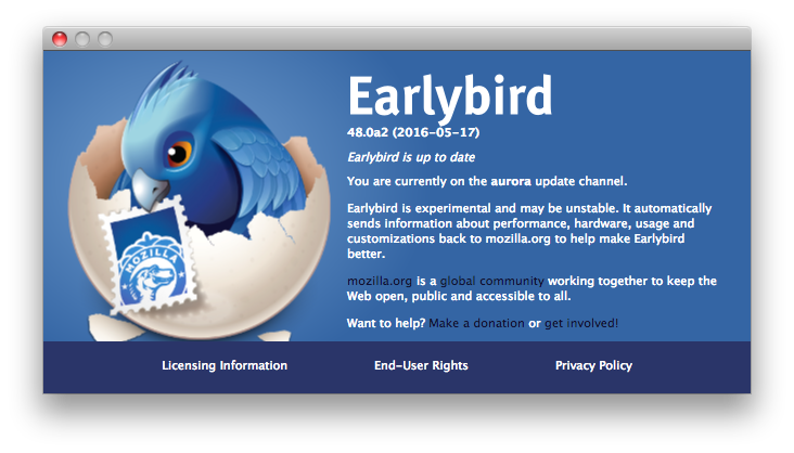

Finally I tested if the latest Thunderbird Nightly version is still running and yes it does. 🙂
Edit: Sorry no it does not. 🙁 There is also a 49 version called Daily. Never heard of that before. It does not run anymore. But there is a 45 ESR too.
It's not really a different version. It has just been merged into the normal release. I got redirected to the following one after I saw the 45 ESR from the ftp server had been an Earlybird:

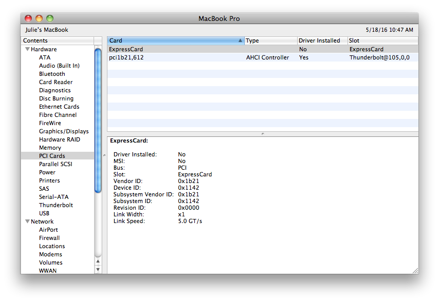

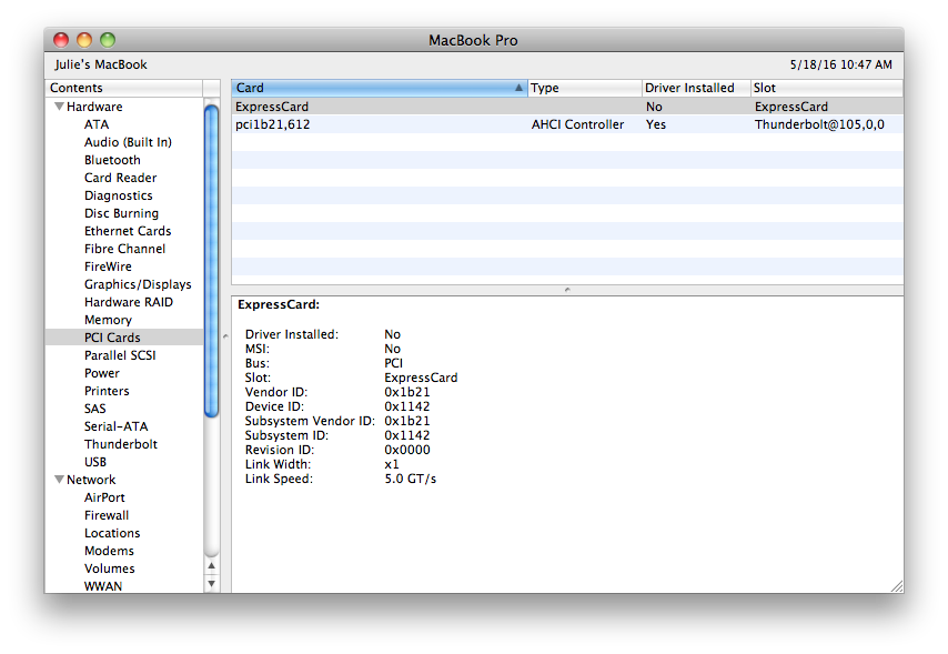

Next I'll test if my USB 3.0 Expresscard/34 is working if I find it. 😉 It worked in El Capitan without any driver.
And the next one:
USB 3.0 seems not to be possible with Snow Leopard at least not with my card from nanoTECH, the package says it requires at least 10.8.5 and the Matrox DS 1 Thunderbolt Hub what I have requires at least 10.8.2 (http://www.matrox.com/video/en/support/ds1/system/) but I did not try that one yet, just the card:
And the next one:
Edit again:
I really love Snow Leopard. 🙂 And don't need USB 3.0 if I have Thunderbolt. That's why the card wasn't even in the MBP and the Hub had not been used for a long time.
And the next one:

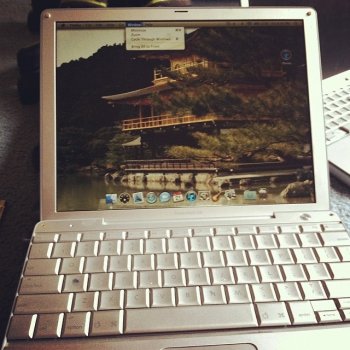

Thanks for your posts they were very informative and love the pictures 🙂 Makes me wish i still had my old PBG4s (Powerbook G4) I had 3 11' and 2 15' miss them alot :/ And also nice MB i have a mid 2009 with 8gb ram (Yes I know it only says max 4gb But apples wrong lol) white one (photo Below)
(These Photos were taken like 3 or 4 years ago on my iPhone 4 lol)

From what did you install it? Was it an image of a retail DVD or the grey ones?
Is it really a Mid-2011 MacBook Air? And did you install every update and patch? After the first reboot when it was already on 10.6.8 and I started the software update a second time there were again 8 updates and patches and it rebooted a second time.
I just saw somewhere above you (?) wrote about a HD Graphics 4000 kext file. The HD 4000 came with Ivy Bridge in the Mid-2012 Airs. It's the next generation chipset that never had been in any Mac with Snow Leopard before.
The last iMacs with Snow Leopard 10.6.6 already had Sandy Bridge and HD Graphics 3000 like my Late 2011 17" MBP what was released with 10.7.2 and the Mid-2011 MB Airs with 10.7.0.
Both never came with Snow Leopard because they were released when Lion was already finished but I think only the CPU is different to the Mid-2011 iMacs and also my dedicated Radeon HD 6770 GPU works and were in those iMacs. Could also be that it's checking for that combination and don't have dGPUs in addition.

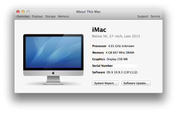

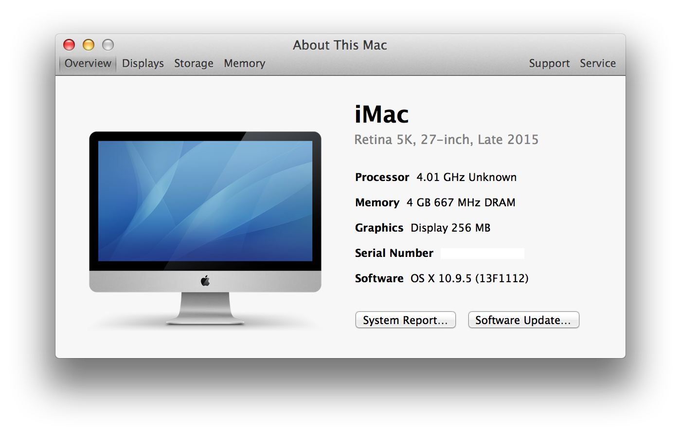

New Update: What I am thinking about doing is installing it in a virtural box (Mainly because virtural Box allows you to set a cpu cap so that it wont make my MBA over heat .....
Concerning installing OS X in a VM, expect performance to be less than impressive. This is Mavericks running on my unsupported 5K iMac using Parallels. Note the "Display 256 MB" under graphics, meaning there is no GPU acceleration, and lag everywhere.
Still, if all you want is Rosetta support (and not for GPU-intensive games), it'll do ok.

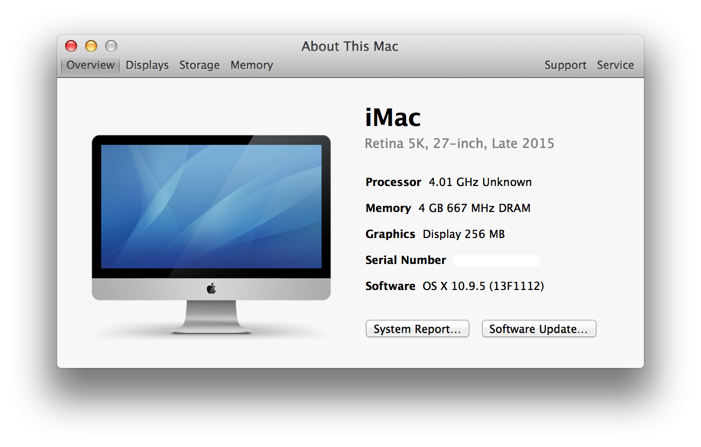

How did you do that? I tried Parallels 9, 10 and 11 and it always tells me it can only install my current OS from the recovery partition and I think a Server version of Snow Leopard. But no other version of OS X is supported. I tried it on a MBP where I can install everything since Lion natively and it also runs Snow Leopard if installed and updated before on an older Mac. But not on my Late 2015 iMac yet that is only able to run El Capitan natively.
You're off by one version. It was introduced in Tiger.
Wait wait wait the New 5K iMac only has 256MB Vram ?!?!?! WTF Srsly ?? (Sorry Lol just cant beliveve that my old MBA has more vram than the new imac )

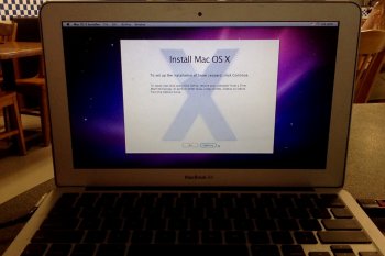

Hey I was going to give it one last shot and tried writing the stuff custom my self and well i got past the install and now its just kernal panicing here is the log im getting ......
Any one Plz any help is extreemly appreciated ill upload photos of install in a second ....
[doublepost=1463685451][/doublepost]Here are some photos
That's a VM they have 2 or 4 GB.

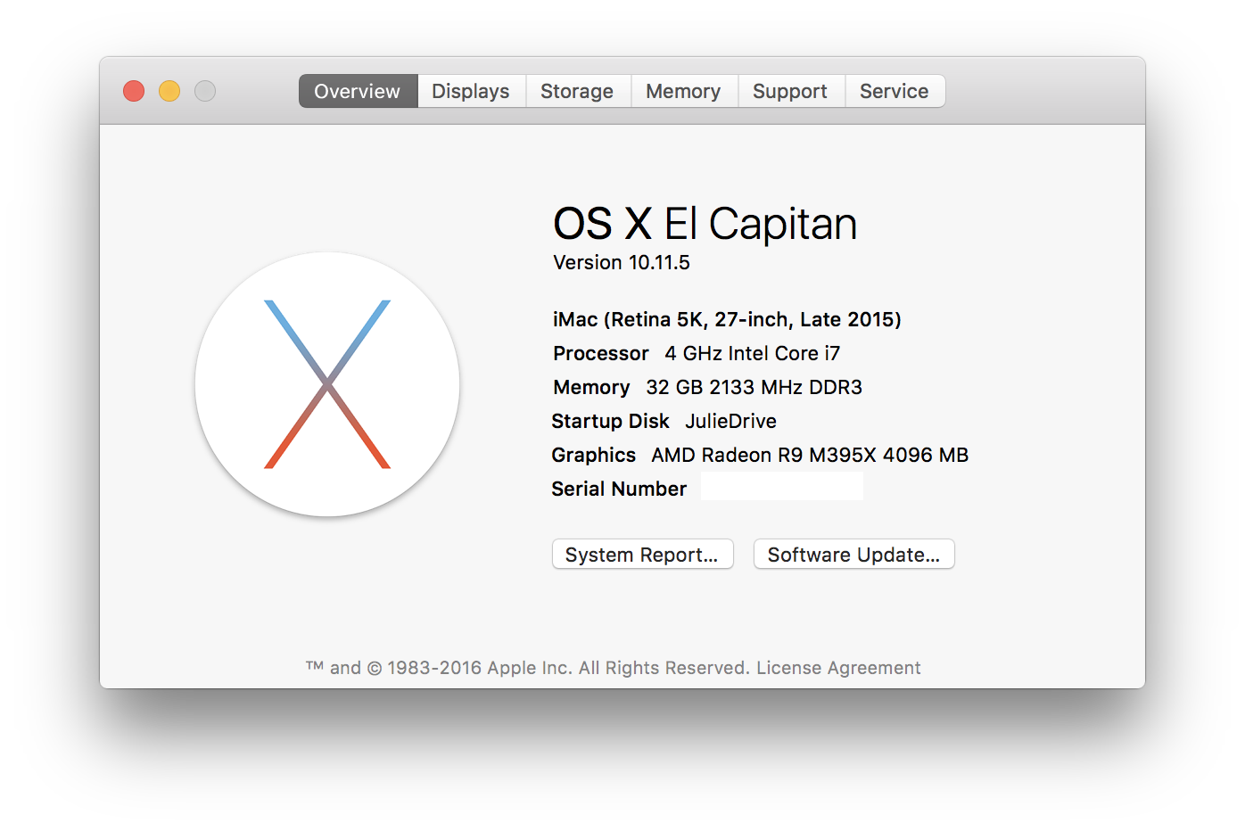

Edit: Im a searching now if I have an Air from 2011 and then try it with my external Snow Leopard SSD.
No, but the VM thinks it has only 256 MB VRAM. Hence the point of my post. 🙂
It also identifies the RAM as 667 MHz DRAM, when it's definitely quite a bit faster than that (2133 MHz in reality).
Ohhh got it ,
[doublepost=1463685561][/doublepost]View attachment 632065
Ok thanks LOL i knew apple would be smarter than that, i was wondering how they even rendered the 5k OS with that little memory 🙂
[doublepost=1463685864][/doublepost]Anyone have any ideas on how to resolve the Kernal Panics Pictured above ??
