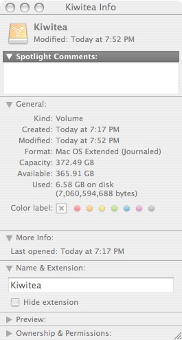

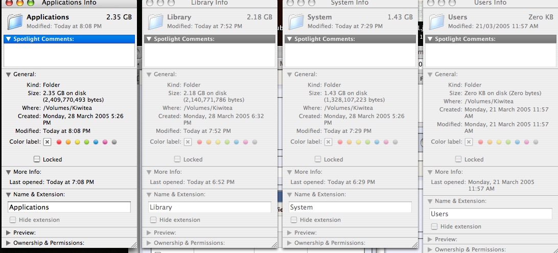

Oh and bam, it was all installing still from Disc 1 and then message says "Computer will restart in XX seconds" it then restarts and cannot start up from the external hard drive.... I will post a screen shot of the what is on the external HD in a moment.
