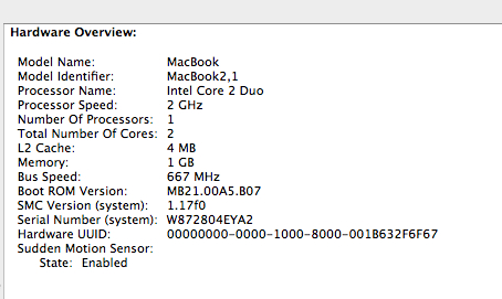

Just got a second hand macbook, white model (see attached pic)
I keep hearing how easy it is to put in extra ram (I wanna go from 1 to 2 GB)
Is it easy enough fro a complete novice to attempt on this model?

It's easy enough, there are plenty of guides on ifixit.com, and based on you having 1GB to begin with, you have one of the non-unibody models. You could get the RAM on amazon or ebay if you like, although since prices are pretty cheap at the moment, I'd check out crucial.com and buy it straight from there. The graphics card cannot be changed, however, so you are stuck with what you've got. That won't be an issue for photoshop, so no need to worry. You'll need DDR2 667MHz laptop memory to upgrade, and I believe the max you can do is one 2GB chip and one 1GB chip

I mentioned it in my earlier post, but you will need RAM labeled DDR2 667MHz 200-pin SODIMM. It may also say PC2-5300, which means the same as the DDR2 667. Don't bother looking for apple-specific memory, that's the companies charging people an extra $10-20 for exactly the same thing.
