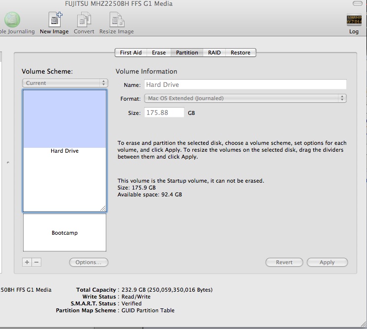

Also, one question. When I go into disk utility it says "to erase and partition the selected disk..." and then goes on to tell me how to partition it. will this erase the disk so I have to re-install mac osx? or should I use the gparted live cd that I have so it doesn't erase the whole drive?
I attached a SS of what disk utility is showing.

Alright I partitioned the disk and I had to repair permissions because my keyboard wouldn't work after I did but now all is well. I am proceeding to restore the image to my small partition and then boot into that partition to do the install. I will report back with results
