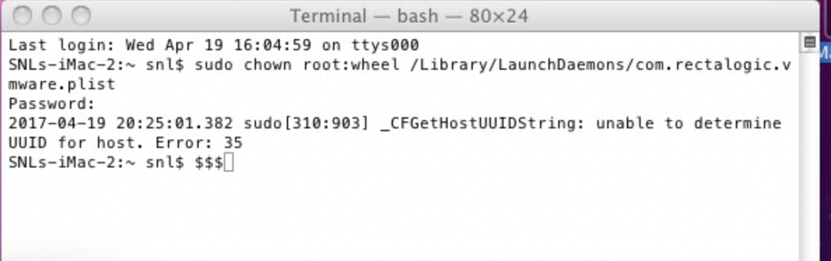

d. Open Terminal in Snow Leopard from /Macintosh HD/Applications/Utilities/. Enter the following text in Terminal and then hit RETURN/ENTER:
sudo chown root:wheel /Library/LaunchDaemons/com.rectalogic.vmware.plist
when i do this step i get the following message
_CFGethostUUIDString: Unable to determine UUID for host. error 35
the settings on text edit are set to plain text and when i saved the file I unchecked the .txt option.
please help.
