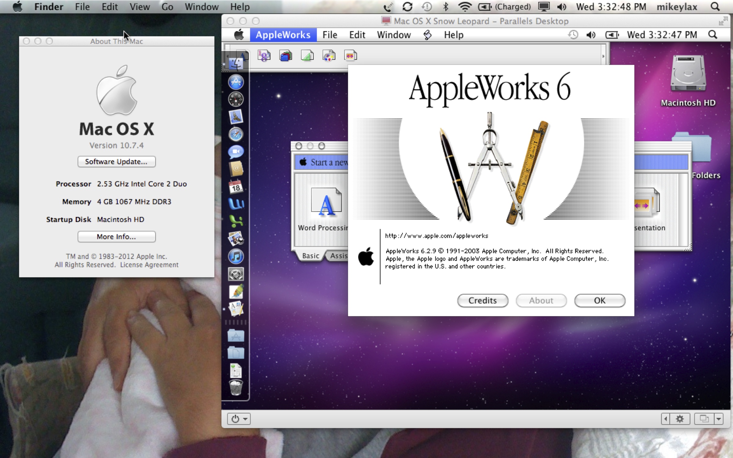

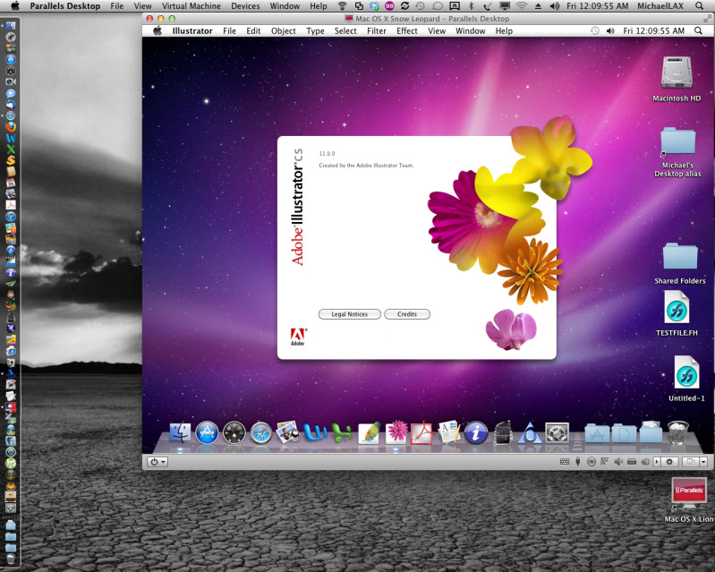

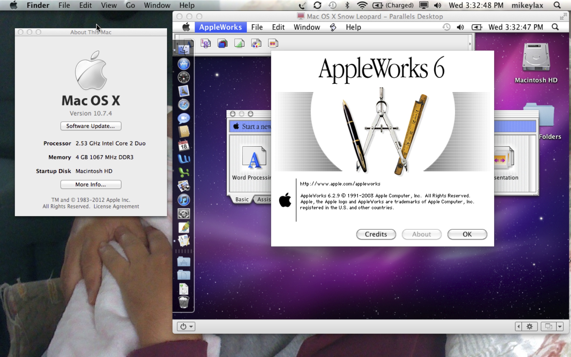

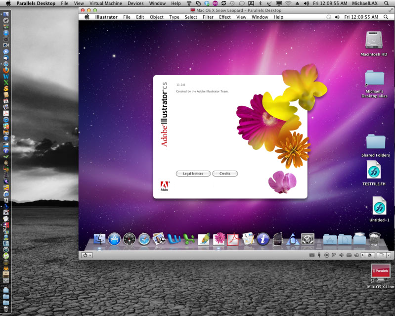

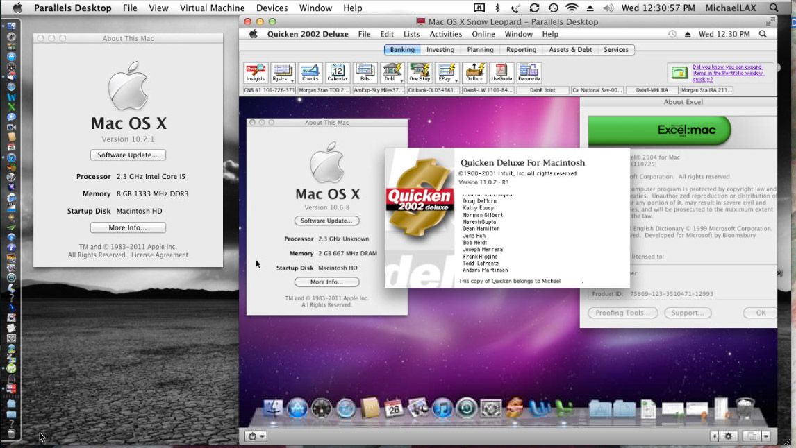

Installing Snow Leopard client (with Rosetta) into Parallels
Full instructions here
