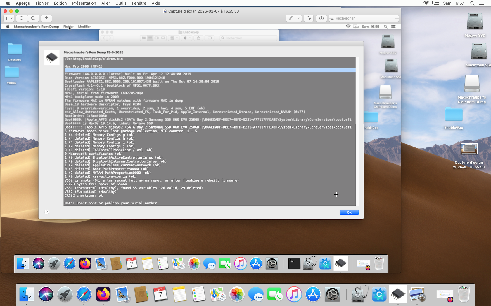

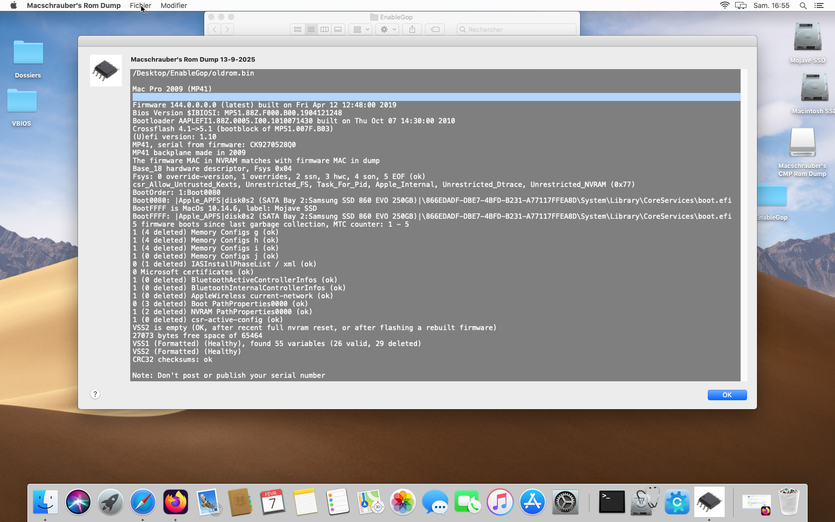

if i send you a copy of my ROM oldrom and newron can you explain to me what is wrong. Can i enableGop again because the fist it does not work.
Thx

it's not a GPU firmxare it's i done it with macschauber Tool. I want to enableGop
If you want it professionally done, cross-flashing issues solved and fully upgraded to mid-2012 standard and with EnableGop EFI module injected, I've already sent you the instructions, files required and service fee.
