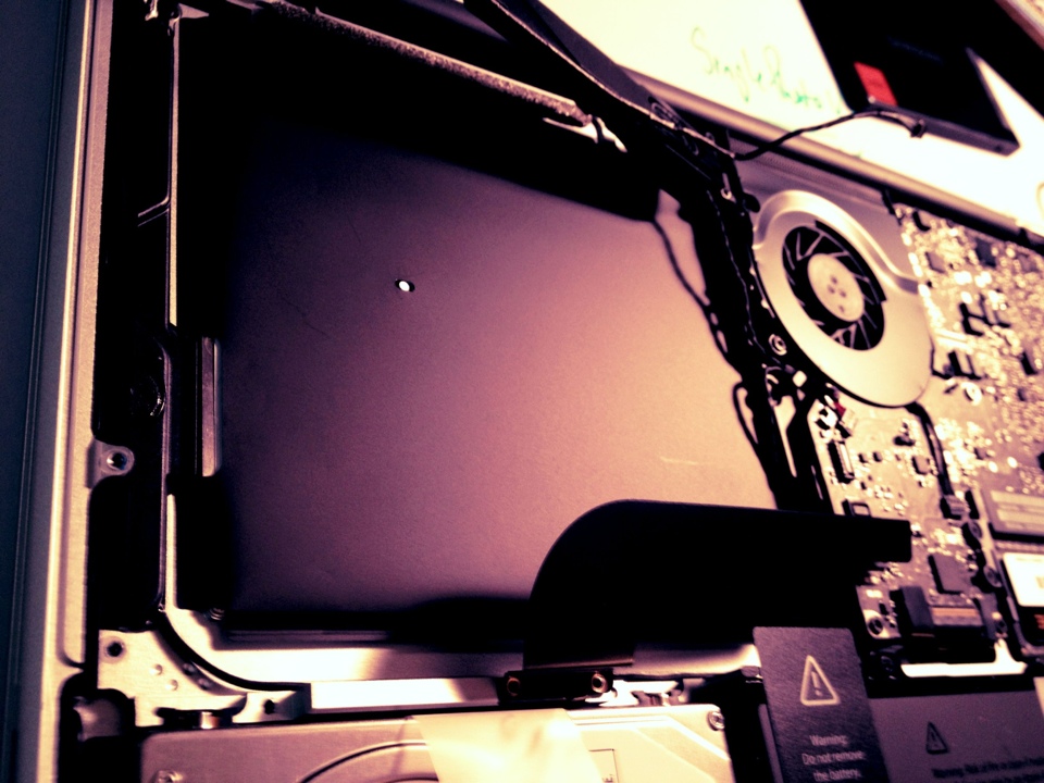

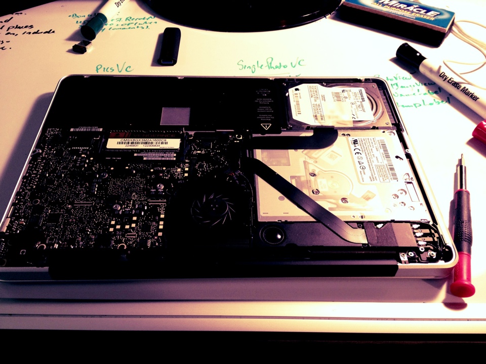

I installed the Samsung 830 128gb ssd into my mid 2012 Macbook pro, replacing the optical drive.
I used the following video as a guide:
http://www.youtube.com/watch?v=ds_6IET3siE
The inside of my macbook was different from the video - there were a few more cables to remove and the optical drive was a bit more difficult to get out.

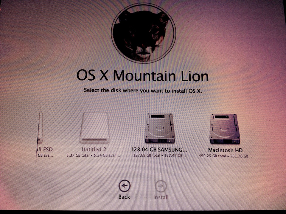

For ssd to get recognized, I had to first format it, then install Mountain Lion on it.

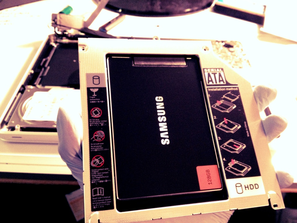

You have just have just done the install I will be doing in the next week or so on my 2012 13"MBP, as yours is up and running could I just ask a few questions?
The SSD carrier/mount you used is that specific for a 2012 as lots of ones I see on the bay don't mention 2012 models and I was wondering if there would be a problem lining up the screws?
Also are you getting full read/write speeds i.e.; is the SATA connection recognising as 6mb/s SATA3

I have 2012 13 non retina macbook pro. The caddy I used fit the ssd in perfectly, however, 2 of the holes on the sides were so deep that my screwdriver wasn't reaching the screws. So I had to use a tremel to widen the hole openings to get the screwdriver in. Otherwise, ssd fits in just fine, and the caddy fits in well into the unibody.
