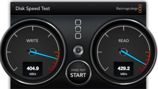

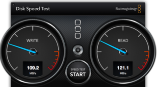

I went through numerous videos in strategizing my internal SSD game plan and then ran into this as a solution:
$15 Inateck 2.5 Inch USB 3.0 Hard Drive Disk HDD External Enclosure Case - [Supports UASP SATA III]
http://www.amazon.com/gp/product/B00FCLG65U?psc=1&redirect=true&ref_=oh_aui_detailpage_o01_s00
Having the boot drive be external is ugly but the results are worth it:
Before: 1TB Internal iMac HDD
After: 500GB External Samsung 850 SSD
- No iMac Surgery, No tools
- $150 500GB Samsung 850 + $15 External Case = $165
- Internal drive works as additional storage
- Doesn't void warranty
