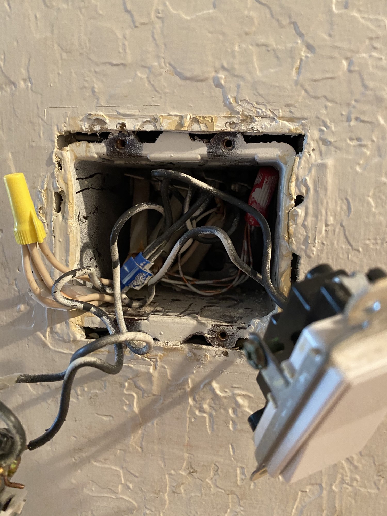

One of the many problems with the wiring in my house is that wire color was a complete afterthought on a "box" by "box" basis. For example, the box in the pictures below, for my kitchen, are mostly all black. Luckily the "dumb" switches work as and when I replaced the dumb switches several years ago it was a simple wire for wire swap out and no need to use the neutral wires.
The neutral wires are bundled together with the yellow caps.

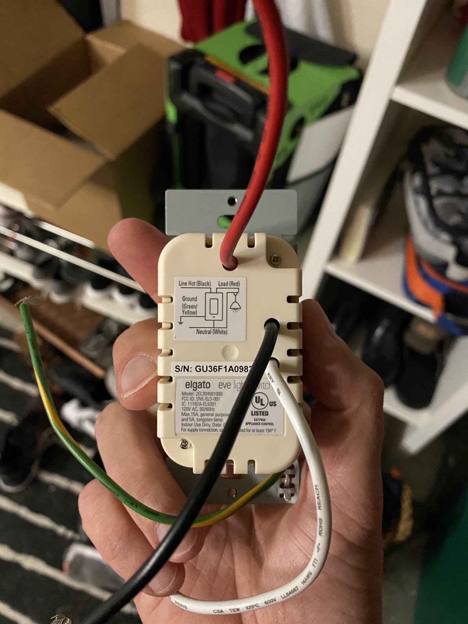

Did not have a flashlight handy to really show what wires are coming in from the top and which ones are coming in from the bottom. So these pictures might not be super helpful. And I also took a picture of the smart switch wiring as well.
Simple wiring for the switch. Black wire goes to the incoming power lead, red to the black wire to the light fixture, and the white to the white neutral returning from the fixture and also connected to the other neutrals. The switch needs power to operate so it gets it from the incoming line and returns on the neutral. The switched light gets power from the red lead and also returns on the white neutral.
can you try forcing the flash on your phone?
if the switches in your kitchen just have the black wires, then it's proper for them to all be black
the white is up in the light fixture,
and the black loops down to the switch and back.

Do you have a multi meter? You need to differentiate the line and load on each switch. A dumb switch doesn't need constant power so no F's were given when breaking the wire coming from the panel (line) and going to the light (load).
