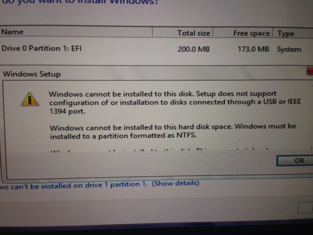

* Update: Sorry for any confusion, but it seems installing Windows 8 on an external USB 3 drive may be more difficult than expected. However, Lyyrad has managed this, so please read his helpful post.

Remember to check if the enclosure supports SATA III drives, as some older/cheaper enclosures only support SATA I/II. This isn't the end of the world, as SATA standards are backwards compatible, but if your SSD is rated as SATA III (6 Gbps), then I'd choose a SATA III enclosure too.
Also note that some USB 3 enclosures require a small power brick, whereas others are bus-powered (either requiring one or two USB ports depending on the model you choose). Again, it all works out the same, but bus-powered drives are generally more portable.
Finally, USB 2 drives (and Firewire ones too) will be rejected by the Windows installer as the connection speed is probably deemed too slow. There are workarounds, but really you will need at least USB 3 for a satisfactory experience.

  • Do read this post if you're using a USB 3 drive (the below instructions are intended for Thunderbolt drives)

Update: If you're using a USB 3 drive, please read Lyrrad's post for how to install Windows 8 without any setup errors.

D. Prepare Your Disk
Next enter your license key, agree to the EULA, and then the installer should next ask what kind of installation you want. It's important to choose a Custom installation, not Upgrade, as this will allow us to choose the install location and to prepare our SSD.
Next you'll be shown a list of drives. If your Mac is like mine, Drive 0 will be your internal drive with its various partitions. If your internal Windows boot manager partition is not NTFS formatted, simple select this partition, then press Drive Options > Format. Except for this, leave the rest of Drive 0 alone! If you need to make changes, use the Mac's Disk Utility instead, as it's more sophisticated than the Windows installer.
Assuming you have no other drives installed, then Drive 1 should be your Thunderbolt / USB 3 SSD drive. Some drives ship as just blank space, in which case you'll need to select Drive 1 and press the Drive Options > New button to create a new (NTFS) partition on your SSD. (Note that Windows will automatically create several smaller recovery partitions later on, just like OS X does, so you don't need to do this yourself).
If your SSD already has partitions, select Drive 1 and then press the Drive Options > Format button. This will wipe any existing data and perform a quick (NTFS) format (this isn't drive intensive, so it's fine for SSDs). Please be careful which partition is selected before formatting it! :p
When you're ready, and with the Drive 1 partition selected, click Next and then sit back & relax. The Windows installer will now transfer the installation files from the DVD to your SSD. The optical drive is the weakest link here, so don't be alarmed if this process takes a while.

I just tried and failed. I got to the section where you select the ssd from the list of drives, however it said that windows cannot be installed onto USB?
I am using usb 2.0 (only until my 3.0 enclosure arrives) - would this make a difference
Here is a pic:
Cheers
I think Windows refuses to install on external USB 2 drives because the connection is deemed unsuitable (probably because USB 2 and Firewire are quite slow). You should be okay once your USB 3 enclosure arrives, assuming you have a USB 3 capable Mac, but I've not been able to test this myself.

I get the same error message about not supporting installation to a USB drive when using a USB 3 enclosure. I'm using a MacBook Pro 15" Retina, so it does support USB 3.
I don't see a way around this issue without getting a Thunderbolt enclosure.
