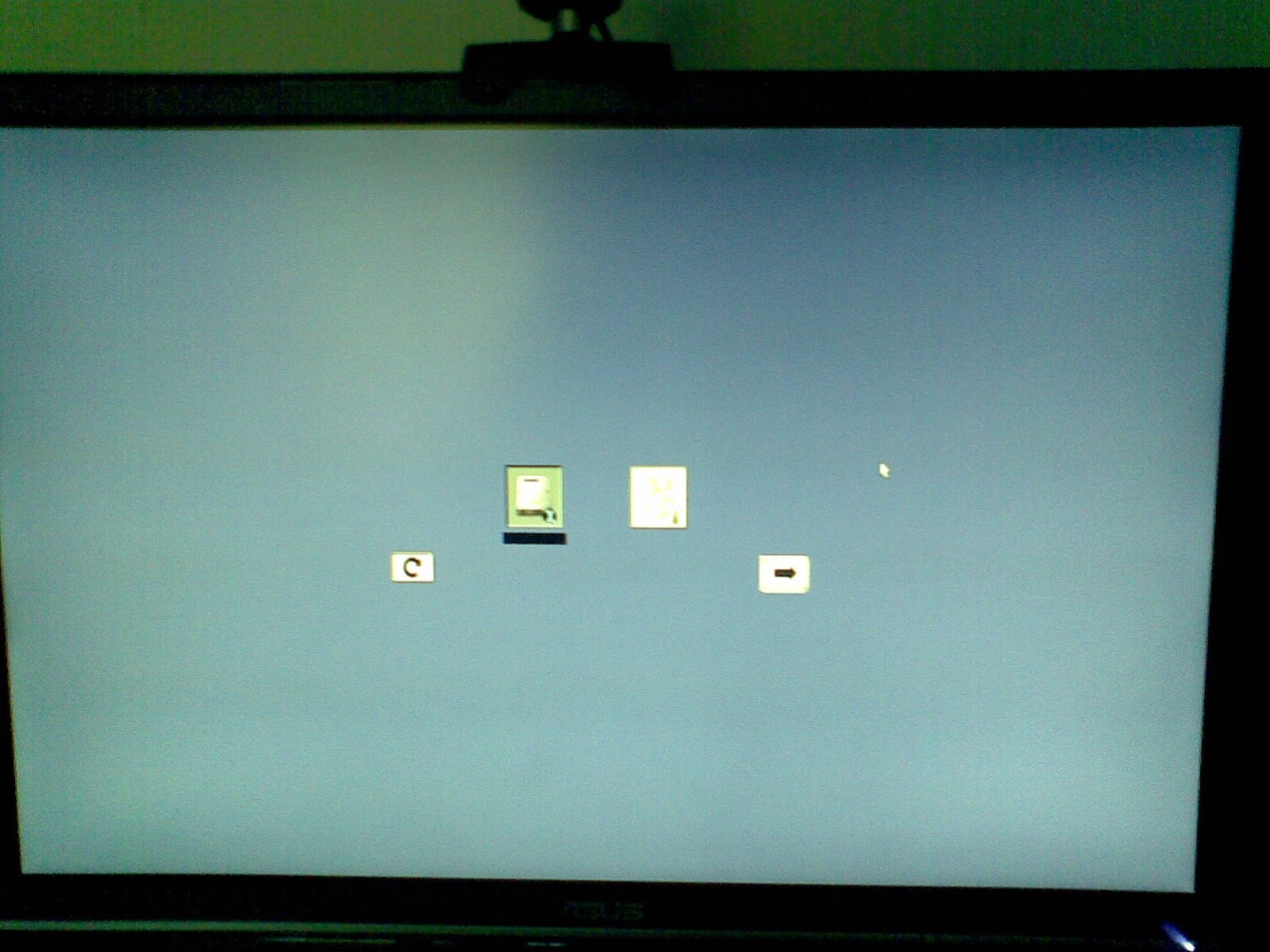

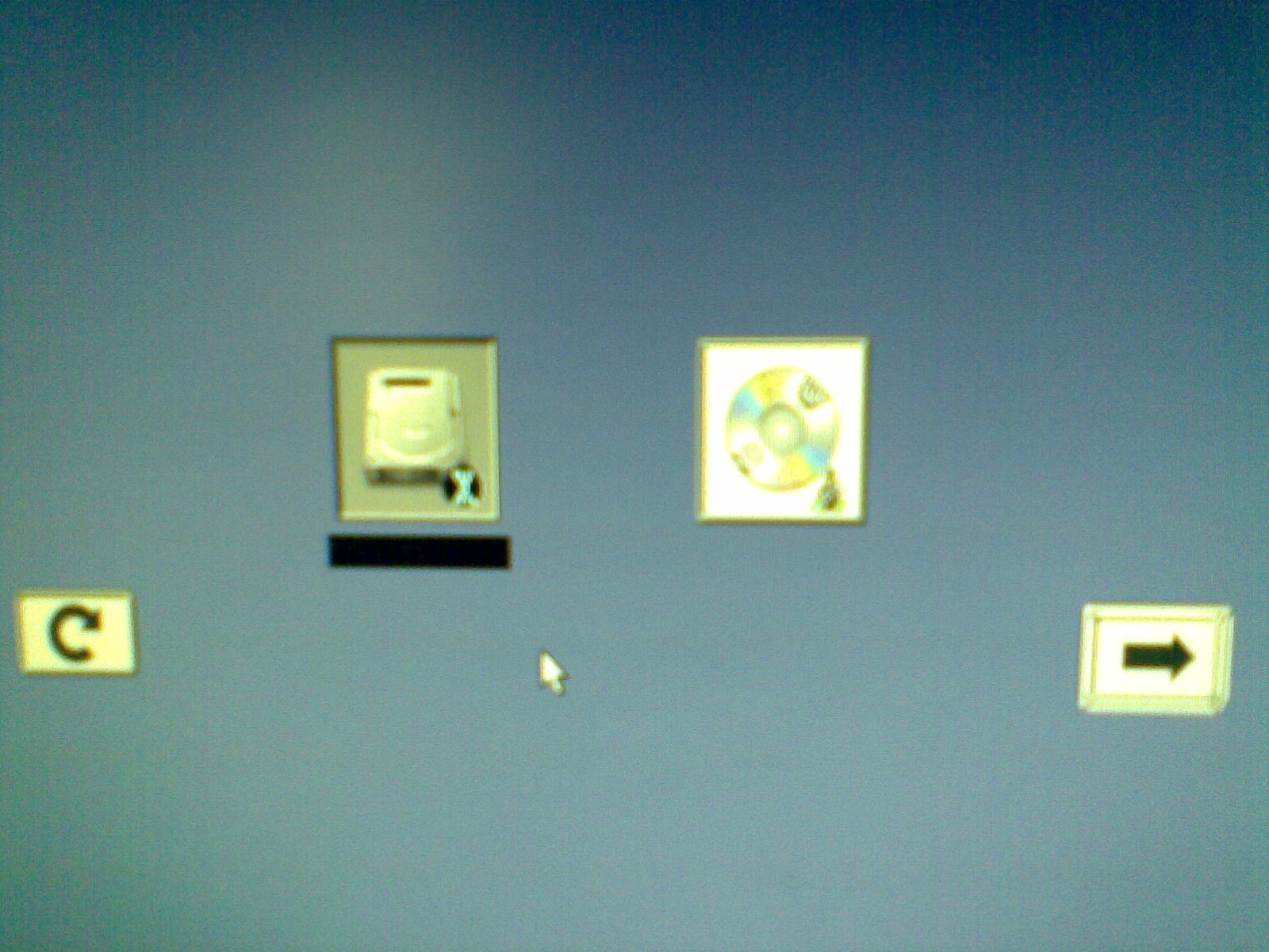

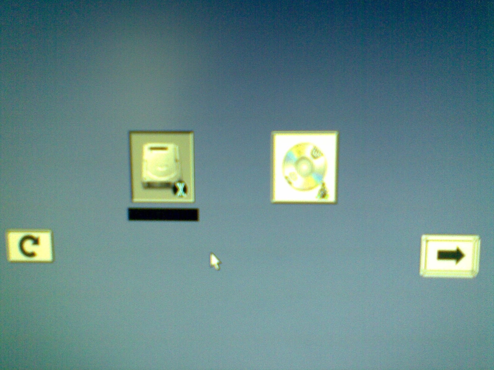

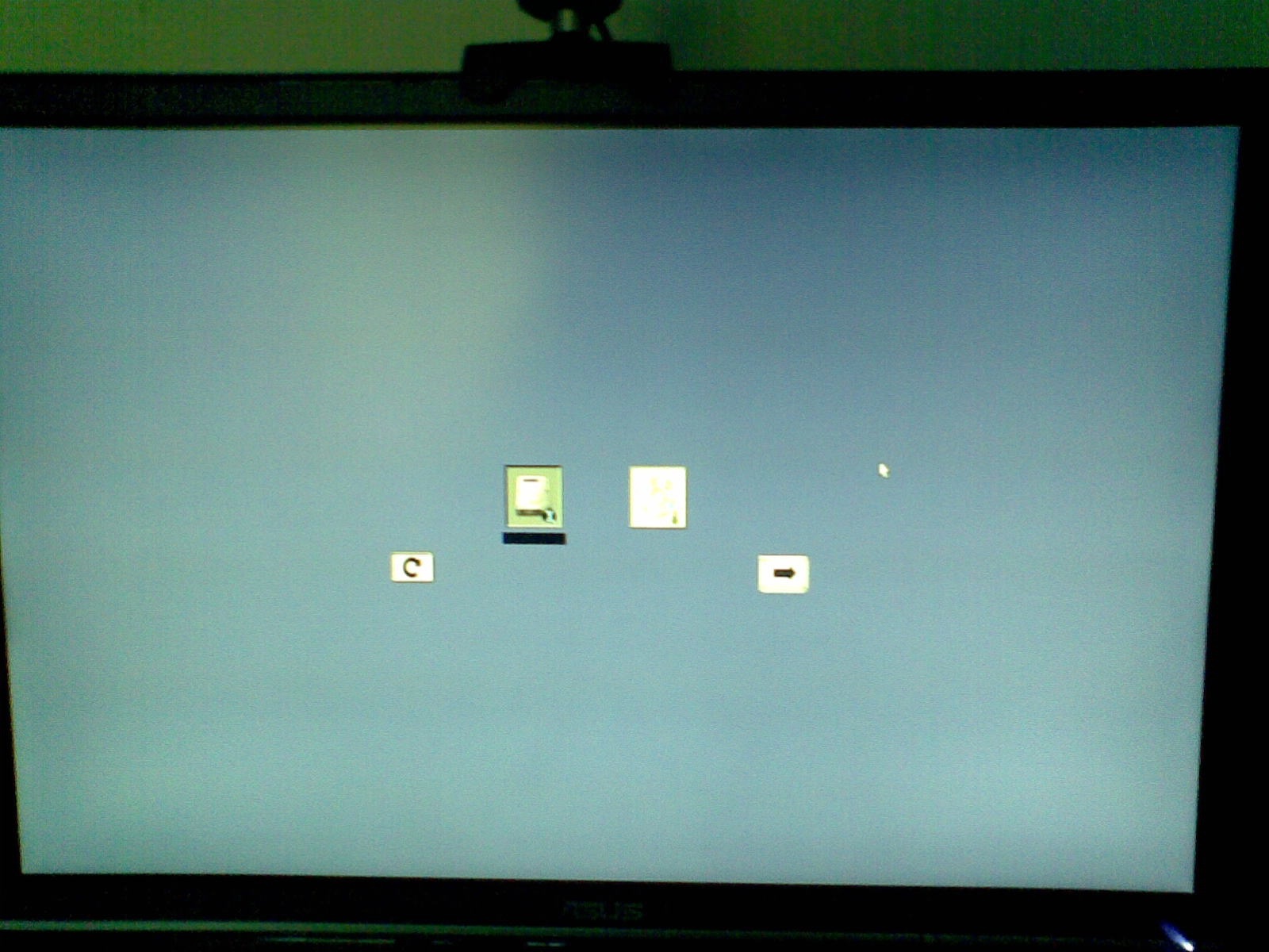

I have just inserted my Ubuntu install CD, held option, clicked the CD then the little arrow - but all I get is this (picture attached, first two)

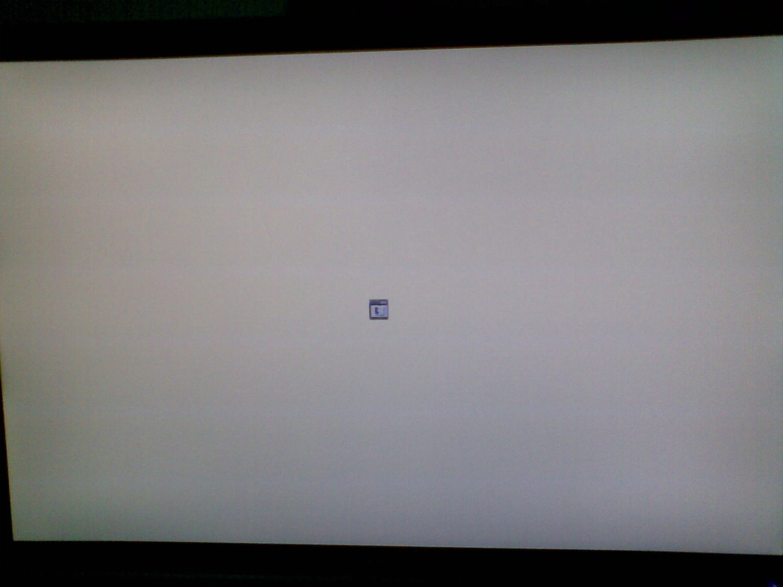

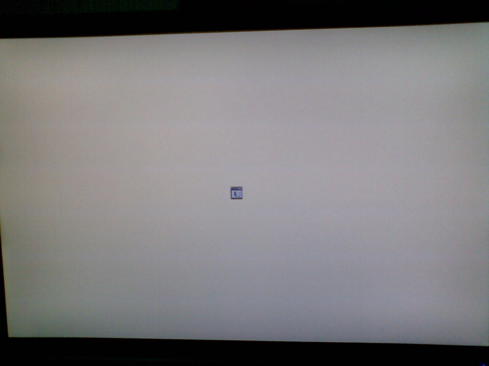

So then I began debuggering (oops, debugging, I mean) my computer. First thing I thought, disconnect all HDDs, but now I get the hated folder icon with a question mark. Picture attached (last one)
Now I have tried a selection of 4 CDs, all of different Linux distros, including Live CDs and Alternate Install CDs. As I have said in a previous post, Ubuntu has been install on this computer, but before I had OS X - I had OS 9.2.2, and during the install I formatted that HDD (since I only had one HDD at the time).

Hmm, dunno on that one. You sound more than experienced enough to have not missed any of the obvious things (using a PPC CD image, burned it correctly, etc). You might make sure that Mac will still boot from an OS X CD or DVD, just to eliminate a more general cause.
Elsewise, if you join a forum, I'd personally suggest trying Ubuntuforums -- they seem to have among the highest quality of contributing users. Plus if you figure out how to boot your Ubuntu disc, I'm sure the rest will follow. 😱
It's very easy to get Linux working on intel macs. Not sure about PPC.
The only PPC I tried it on was an iBook G4 (and this was Ubuntu... maybe 6.04 or 5.10). On that system, the process was not really any less straightforward than it is on an Intel / Windows PC. However, I think the big difference (speculating) is that my iBook was an OS X computer from the start -- my understanding is that these things sometimes get more complicated on Macs that were sold running OS 9. I wouldn't rule that out as related to why the disc isn't booting (e.g. a firmware issue or something).

Well thank you all for the help, looks like I will have to be joining the Ubuntu forum. I have no idea why the problem still persists, I am pretty sure it is firmware though, seeing as it booted for this linux disc when OS 9 was installed but now not when OS X is.
But if it is then I have to get my hands on an OS 9 install, seeing as the firmware updater only runs on OS 9...
But thanks again!
EDIT: Oh, and yes I can boot OS X DVDs
