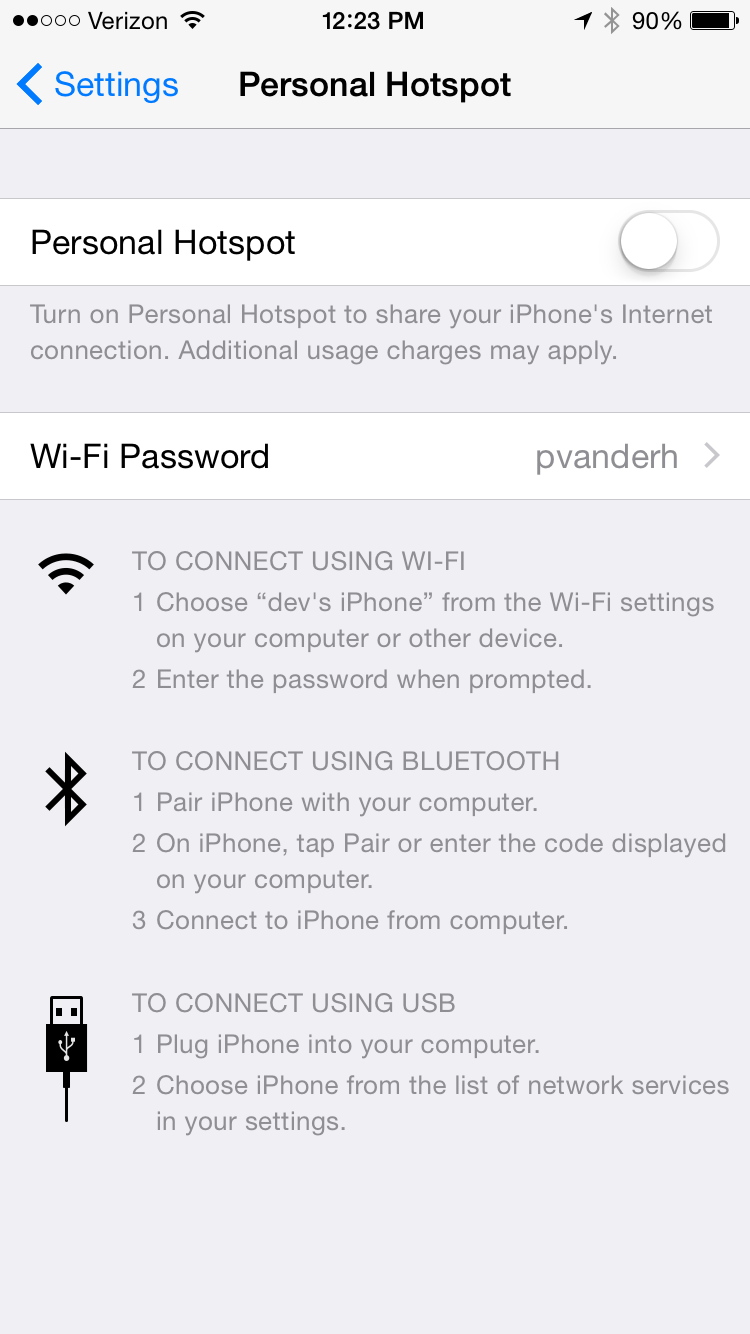

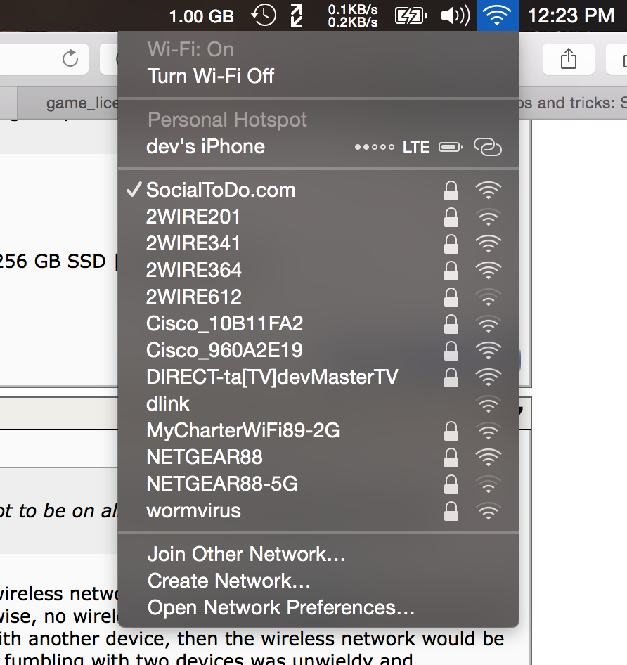

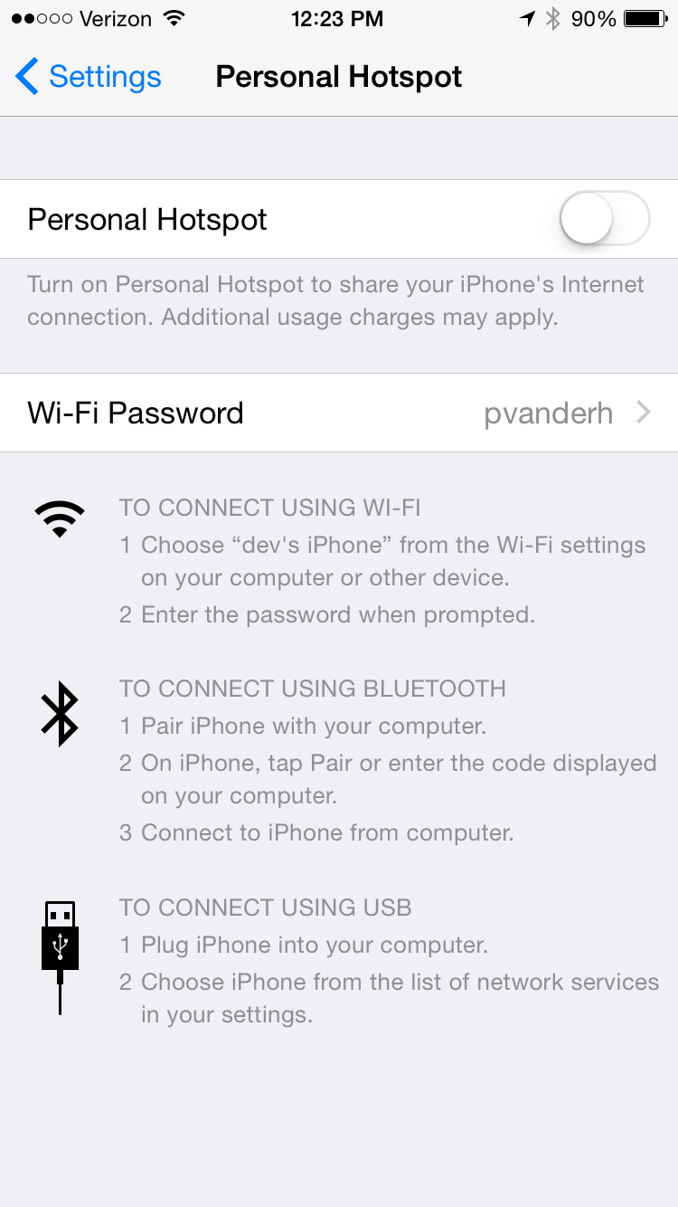

Personal Hotspot does not have to be turned on (or a carrier feature) nor do you have to be on that screen. You do need "bluetooth on" on both devices. Do you have any customized bluetooth restrictions or changes on the Mac. If everything is at default and never changed then it should work
