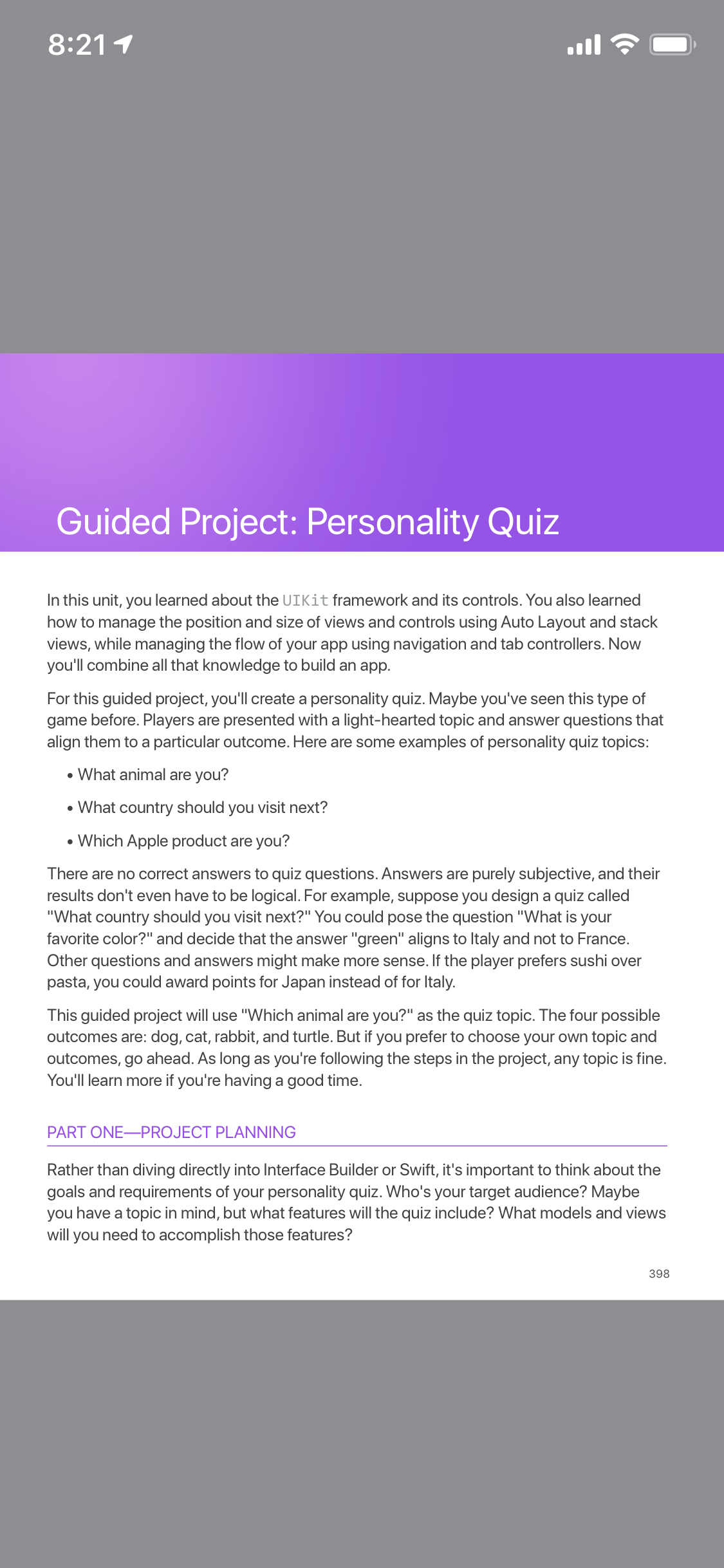

You mention that doing a view that updates it’s content is too much work. I think this is a bad way of viewing it. When you program and make an app the shortes and fastest way of accomplishing something while ignoring best practices is a recipe for disaster.
As you’ve already found, instantiatiing a new view for each question takes up an increasing amount of memory, which is why you usually don’t ever want to go that route
I strongly suggest that you download apples book App Develoment with Swift from the iBooks store, it’s free!
Check out the guided project on page 398, it covers how to have 1 view that updates it’s contents to display a different question along with answers. You should find this very helpful if this is similar to what you are trying to accomplish.
