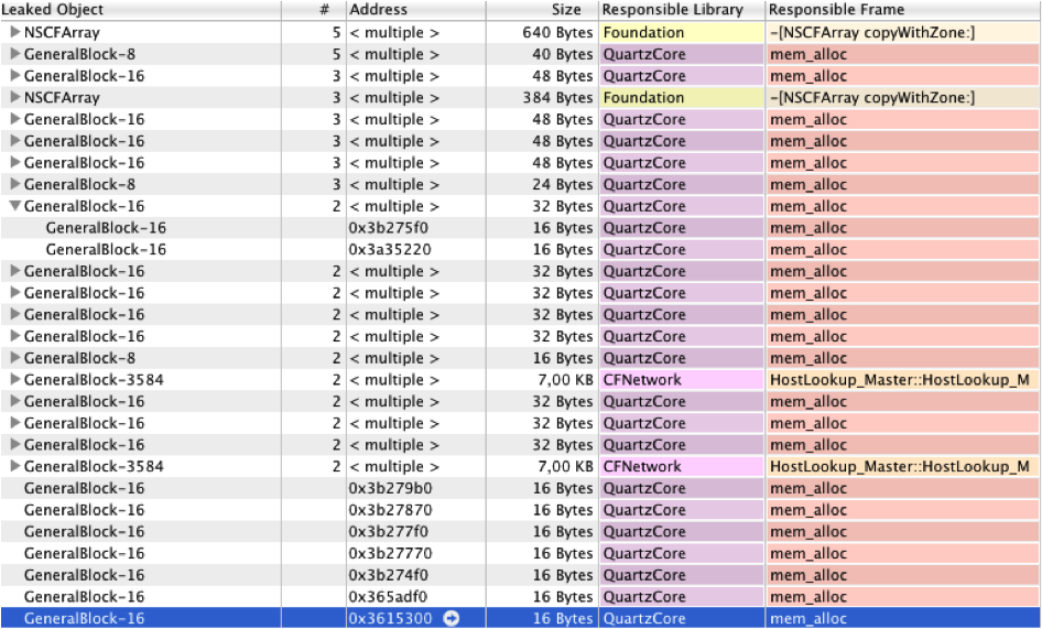

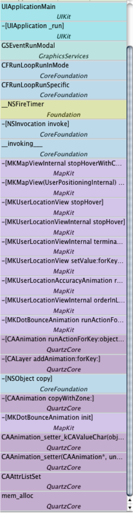

Hallo again,
can someone please tell me how and when I should see the reported leaks from Instruments leaks, as serious and as produced by my code? Are, for instance, those leaks my fault (attachments)? I do not get any indications on where in my code, the problem is created? Please help me to clear this...
QuartzCore mem_alloc seems to grow when I reload a view in my app, what I think is worth to note.
Foundation -[NSCFArray copyWithZone:] is also growing but not that rapidely...
Are those leaks produced by me or are they out of my control, ie produced of the frameworks mentioned....?
Thanks in advance!
MACloop

The leaks tool can show you the stack trace of the location that the leaked object was created. You need to look at that as a start to figuring out the leak.
The leaks you show for open_handle_to_dylib_path are probably not real leaks. Can't tell about the others but in general I never see dozens of leaked objects when I run leaks so they probably are real leaks.
Did you run Build and Analyze?
Hello,
yes I did run Build and Analyze and that did not really give me any indication. I am pretty sure that it is a real leak now... I think I have to go on seaching... Thanks for your help!
MACloop
