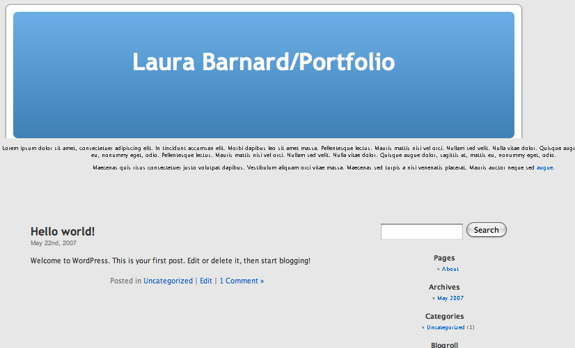

and have tried putting my HTML in underneath <body>, but still get the same WordPress header like so:
but if I replace any more, I think I'm going to be replacing important php. I think because I'm so clueless about php, I'm struggling to work out what I can touch and what I can't, or what each bit does.

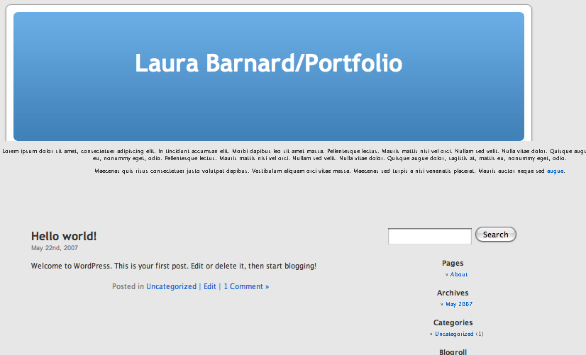

Maybe you've already fixed it or I need to sleep, but I don't notice a differece. Can you post a screenshot?
It was just that everything was more bunched up, but I managed to sort that by using two different stylesheets, one linked, one imported. I'm not sure why it worked but it does.😛
