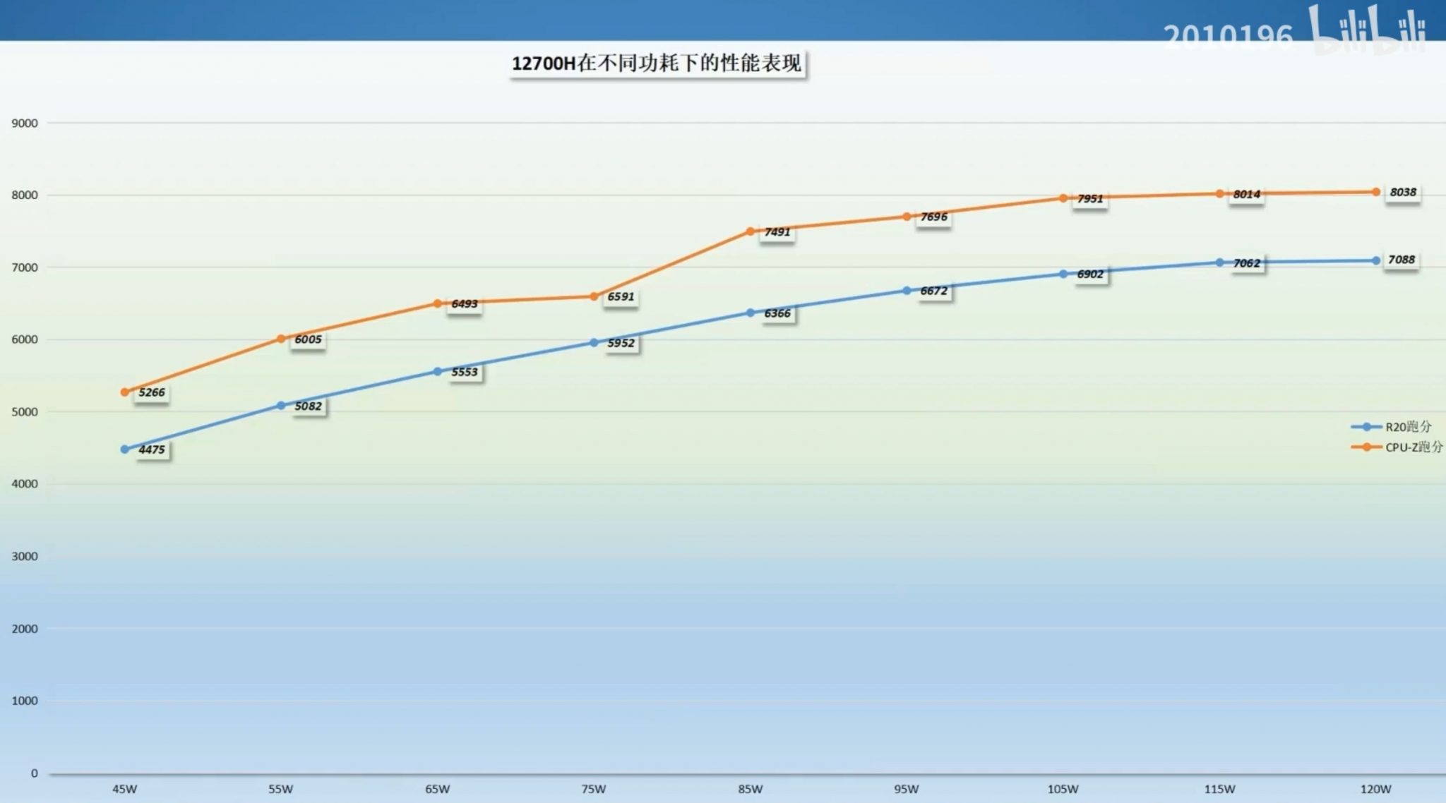

This performance scaling by watt graph should be standard for all CPUs and GPUs. For 12700H the sweet spot is at 45W. At ~120W it's slower than AMD 5950x that's just shy of 10K on Cinebench R20.
