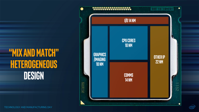

Highly doubtful. If look at the Intel graphic that Engadget attached to their story on the topic.
dims
https://www.engadget.com/2017/11/06/intel-core-h-8th-gen/
This is more about consolidating board space that was already in play. This makes Apple's work a bit easier to design a MBP 15" class laptop. The VRAM and GPU are weaved into one tidy package that Apple can just drop onto the an even smaller motherboard ( and perhaps use the space the motherboard gives up to add battery or more system RAM).

Probably not in that this combined package is likely bigger than the current CPU+iGPU package currently in the 13" MBP. See picture above. The MBP 13" doesn't have copious extra motherboard space now and this thing is bigger. This is multiple dies inside of one package.
https://www.anandtech.com/show/1200...with-amd-radeon-graphics-with-hbm2-using-emib
That doesn't get you smaller (or small size) chips. What this does is allow multiple dies to be placed with more efficiency. It is smaller from the old multiple discrete chip perspective, not from any one of the previously discrete chip packages.
The 'Holy Grail' for Intel would be to get almost the entire computer onto one package you buy from them. The CPU package is like a black hole sucking in other formerly discrete parts from a historically typical motherboard.
