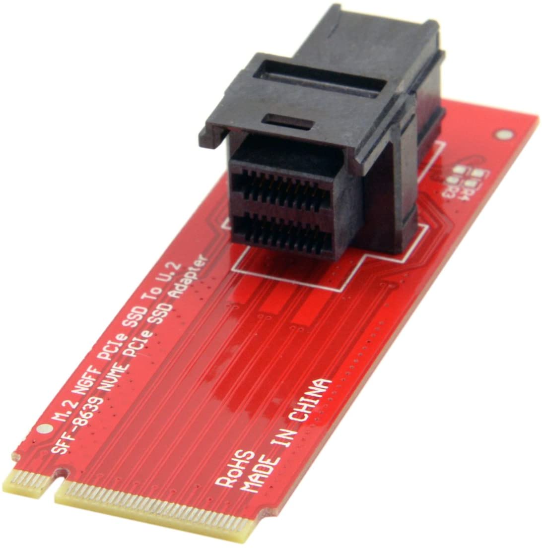

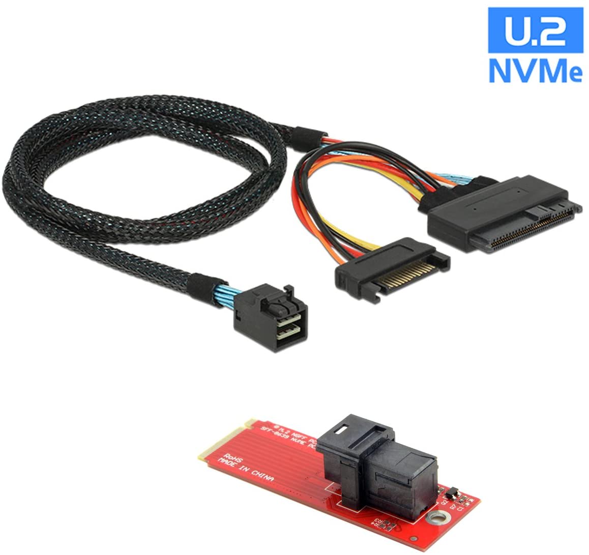

I'd assume a Sintech ver. C (long) adapter + an M.2-to-U.2 adapter... (see pictures)
To whichever U.2 SSDs BootROMs are compatible with (likely similar to 2013-2015 process...
And augmenting power from the iMac's SATA port for 15p SATA power.

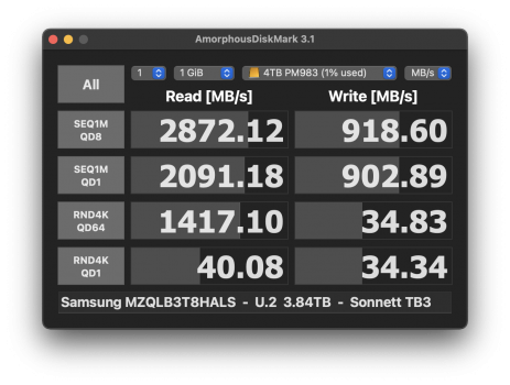

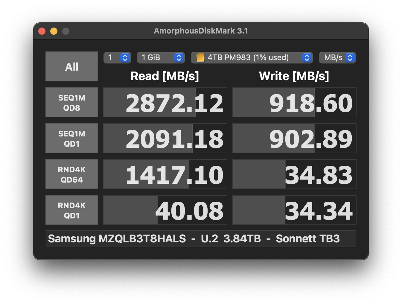

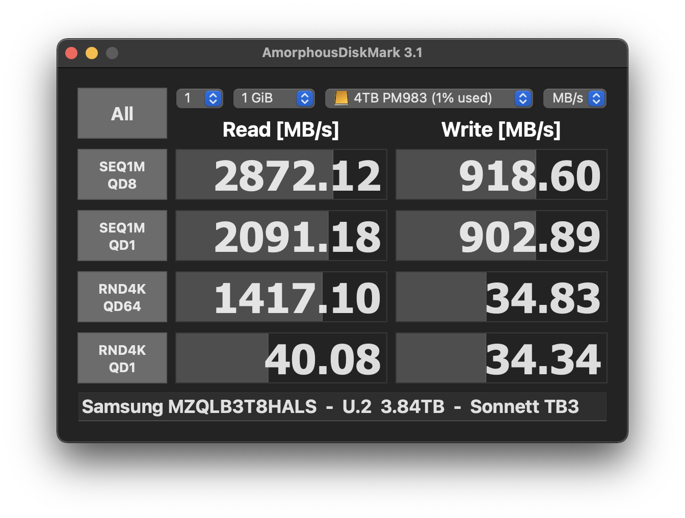

And now, have access to my PM983 3.84TB NVMe SSDs via a Sonnett TB3 with results shown below:
That said, it has ejected at times, so I can't report the reliability yet -- but still, the performance is much higher than even my EVO 970 Plus as an M.2 ... probably because this is powered (as powered vs unpowered is a huge factor for all protocols: USB 3.1, TB, etc)
The 4k performance seems pretty abysmal, but, I'm going to purchase a Samsung X5 to see if that TB3 controller offers superior performance. 🙂

No no, no help needed. 🙂 got it working.
SETUP / CONNECTION
POWER: 12v AC to 4p molex + 4p molex to 15p (SATA power out)
DATA: U.2 (8639) to M.2 adapter / cable with 15p SATA power (for SATA power in)
ADAPTER: M.2 to Thunderbolt 3
BENCHMARKS (Samsung PM983 U.2, 3.86TB which I paid $360/SSD ~3 years ago)
Write: ~1,100 MB/s
Read: ~2,800 MB/s
The U.2 to M.2 KITS via Amazon were $20 ..! (including cable, M.2 to SFF-8643 to SFF-8639 (U.2) SATA power in.)
(the item I bought was out of stock; check the above "U.2 to M.2 Kits" link to see if they're back in stock)...
The cheapest kit I found in my search results (lowest-to-highest in the category so they don't show COFFEE, etc).
Is now $36, and the M.2 to to SFF-8643 is soldered / one piece on one side of the cable...
And the same SFF-8639 + SATA power in on the other.
