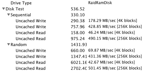

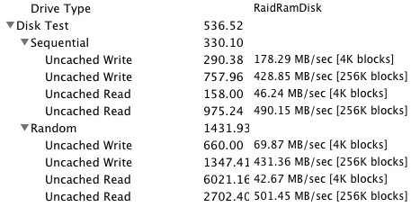

What do you think about the numbers of my Postville? Its after the firmware update today...
Post yours to discuss about them!

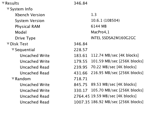

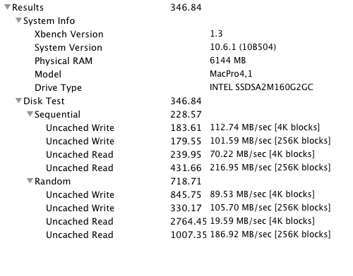

Ouch. Not that it's horrible, but I'd expected a stripe set of a pair would do better than that, especially compared to a single drive. 🙁
Quite a difference in the firmware indeed, even if the newer drive is 2x the capacity of one of your G1's (total capacity is equivalent). 😱 🙂

I like a narrower margin between read and write performance, and am still more acustomed to mechanical. 😱 But that's me. 😛 But I do agree for most usage, reads are much higher than writes, and SSD does really well in the area of read performance. Especially for a single drive. Nothing can touch the Intels in this regard.
They did a nice job with the 160 G2, and wasn't aware of it differing much with it's 80GB G2 counterpart (little brother). 😉 So I figured a stripe set of a pair of 160 G2's would fly, given the data produced by the single. 😀
