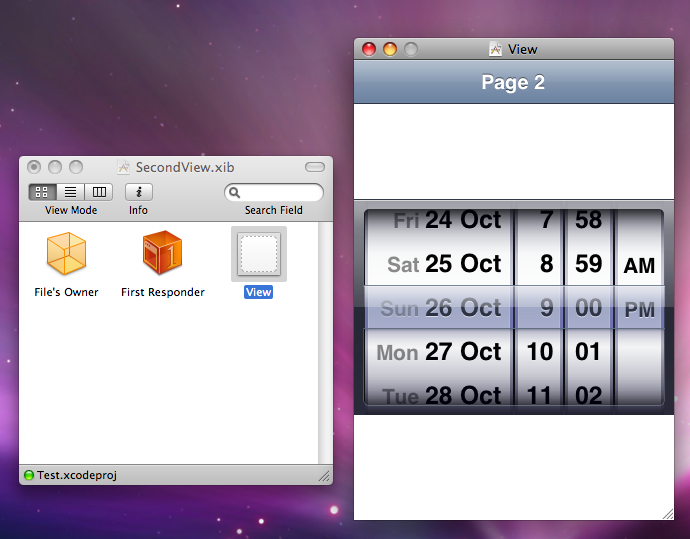

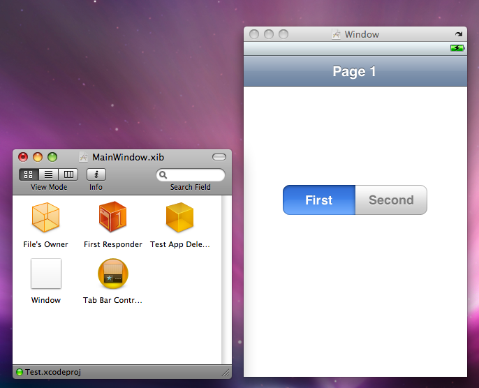

Ah, you need to open the window element that will actually display the elements. Dragging it to the view itself does not work. I have attached some screenshots.
Double click on the "Window" element shown in the second picture. Drag the UI elements to the window it opens (shown in the first picture).
The same applies when you want to add stuff to the second tab view, just open the second XIB file and instead of opening the "Window" element open the "View" element. It sounds like you should read through the Interface Builder manual a little bit to get a bit more comfortable with the way it works.

I did what you said but this is what happened (described in the screenshots)
SCREENSHOT 1: Here is the first page.
SCREENSHOT 2: Here is the second page.

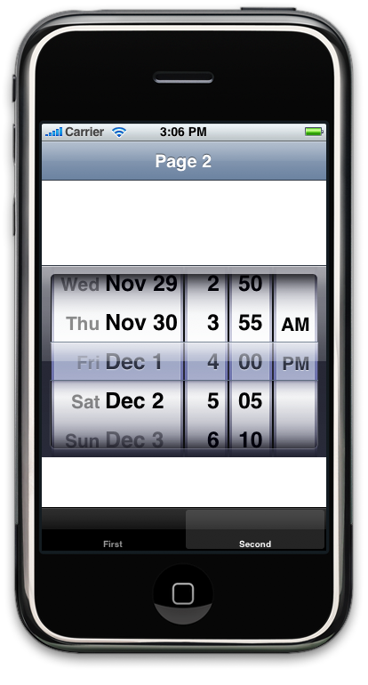

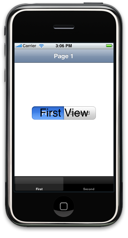

SCREENSHOT 3: When I open the first page in the iPhone Simulator, the words first view come up and I am unable to use the slider.
SCREENSHOT 4: This page works fine in the simulator.
