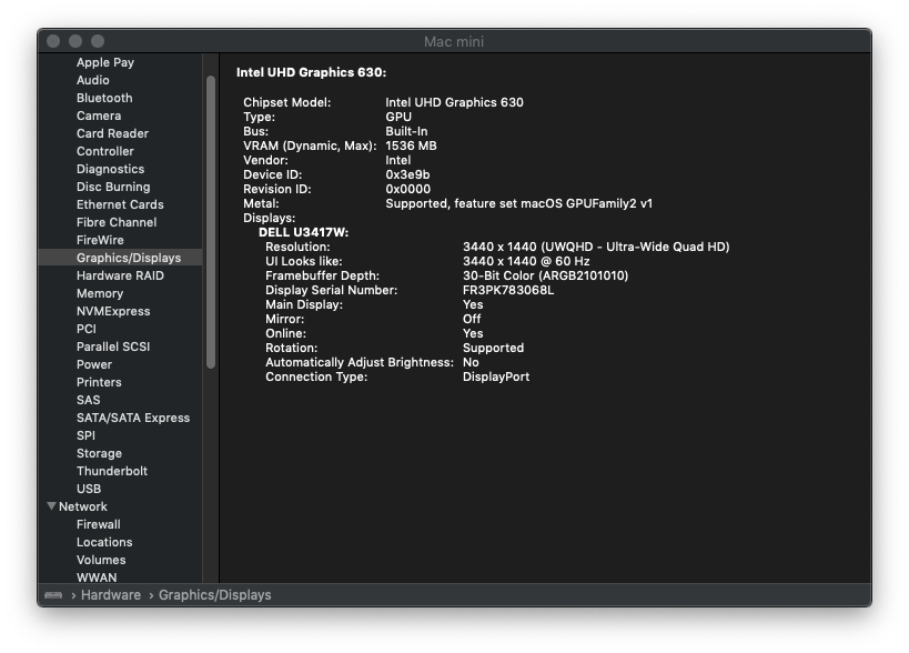

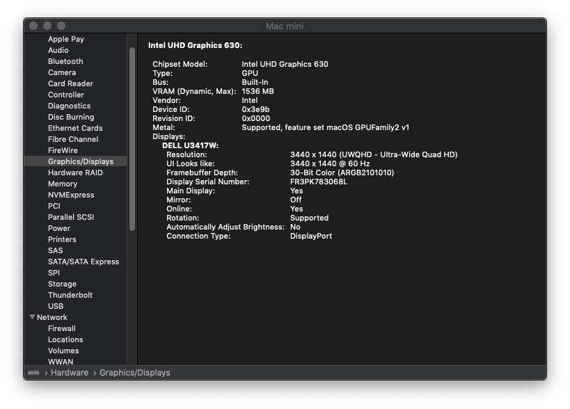

Just wondering does the "USB-C to Display Port" support 10-bit display (display billions of colours)?
Many thanks for the speedy reply.
Yes it does:

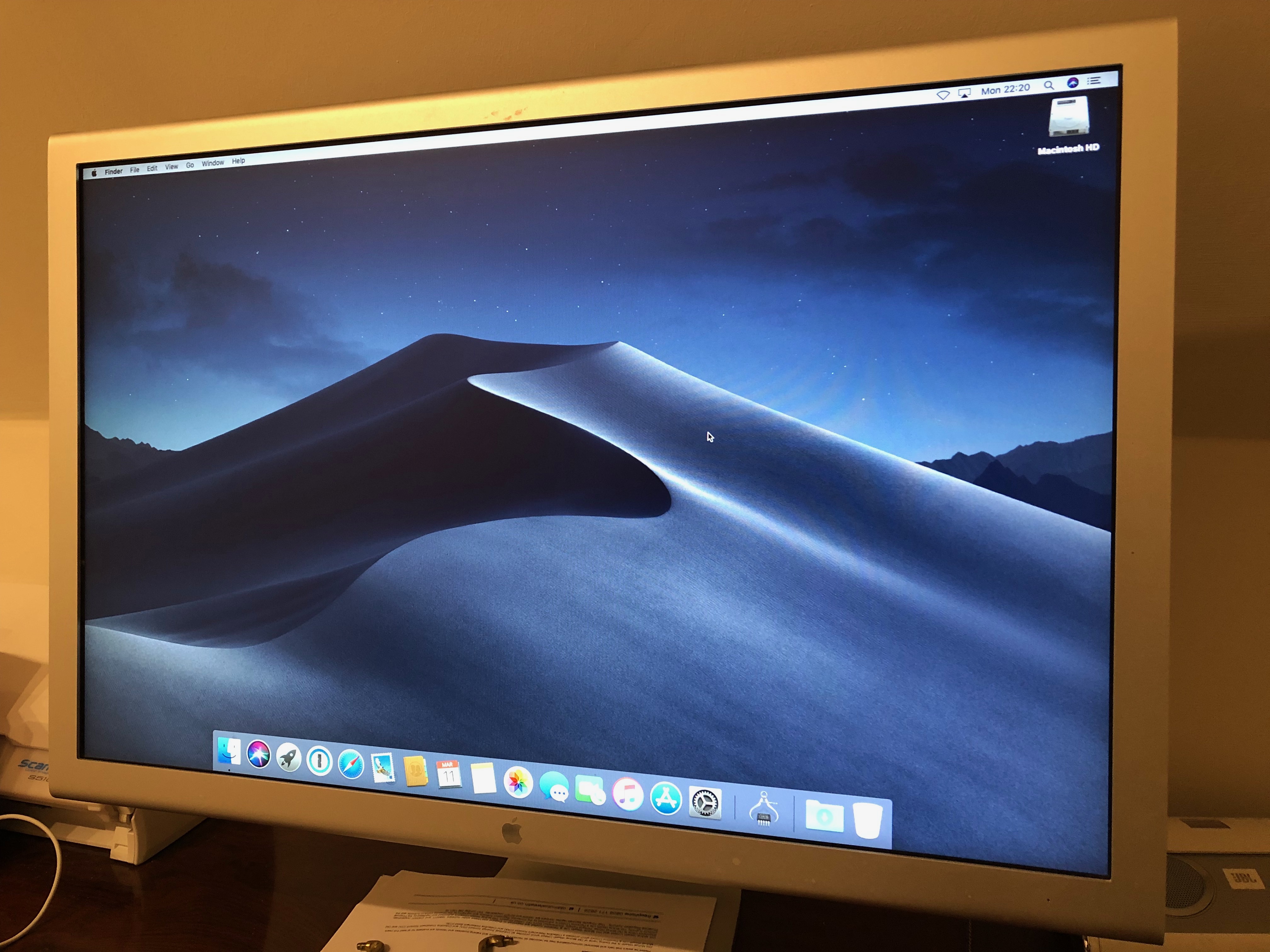

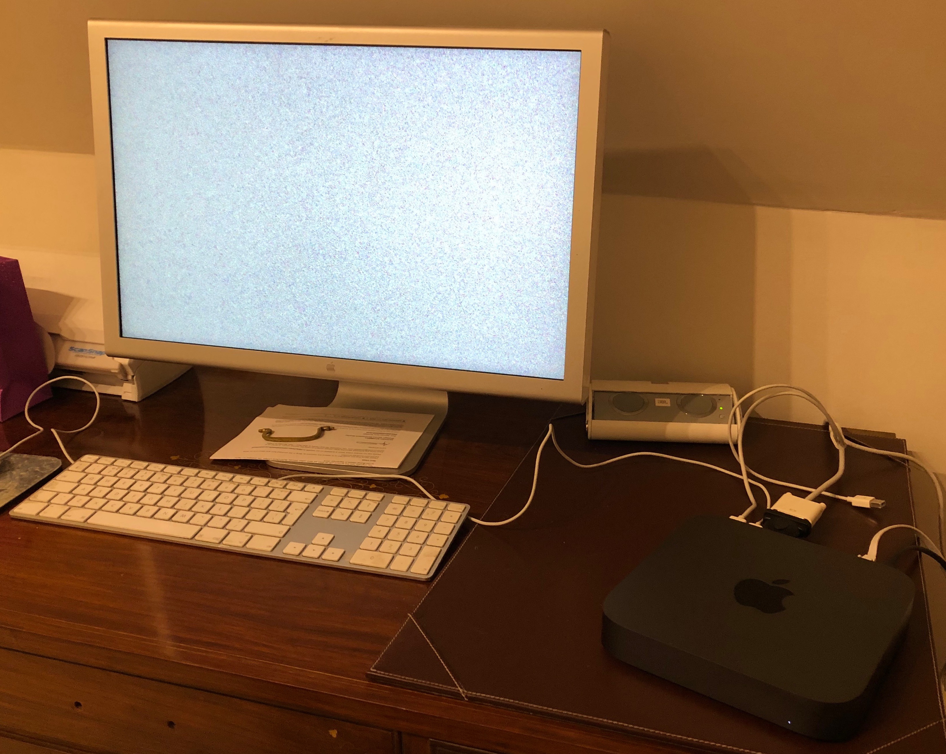

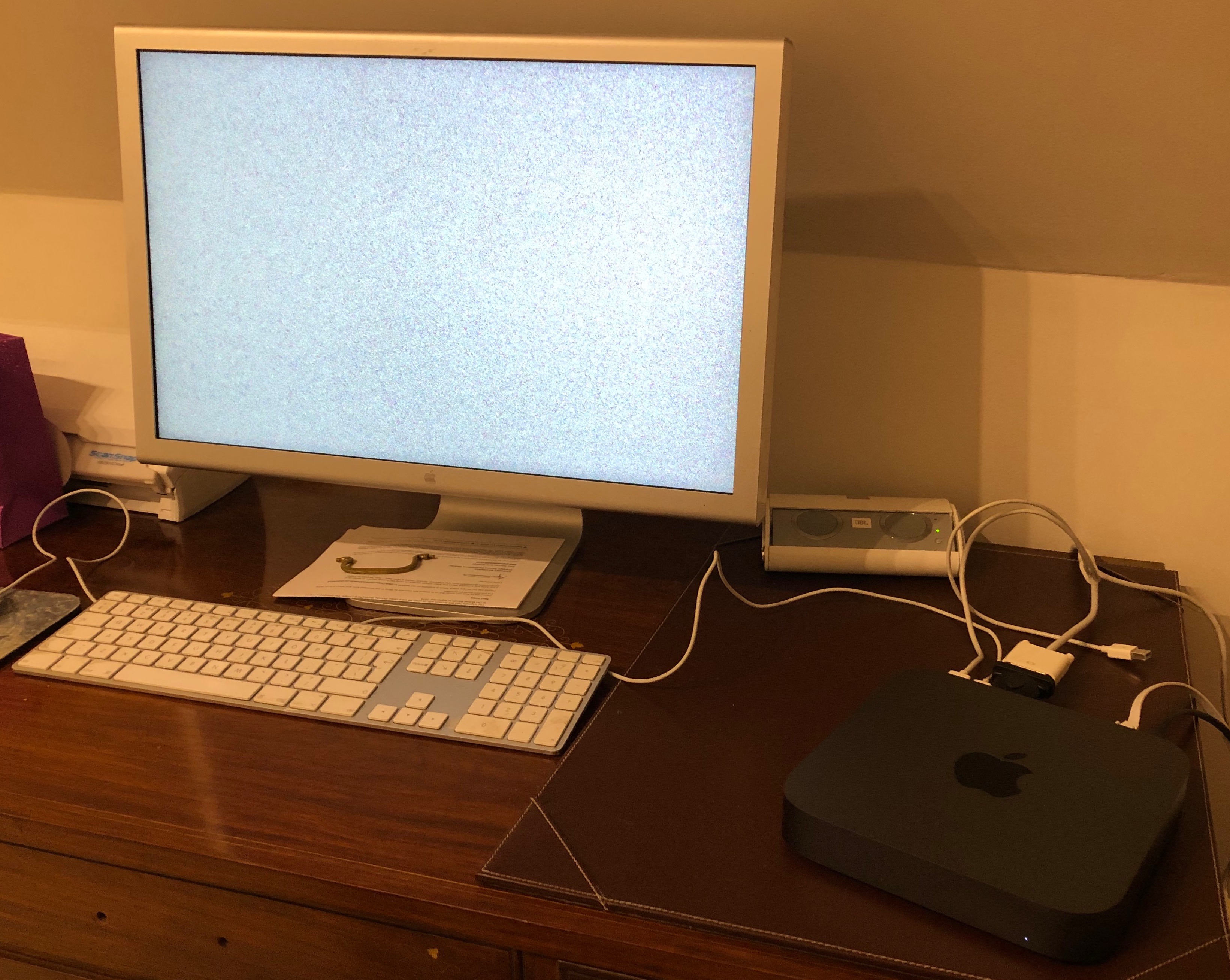

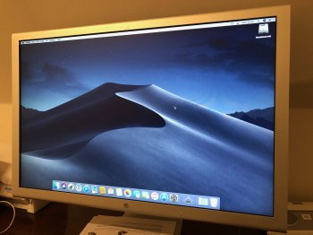

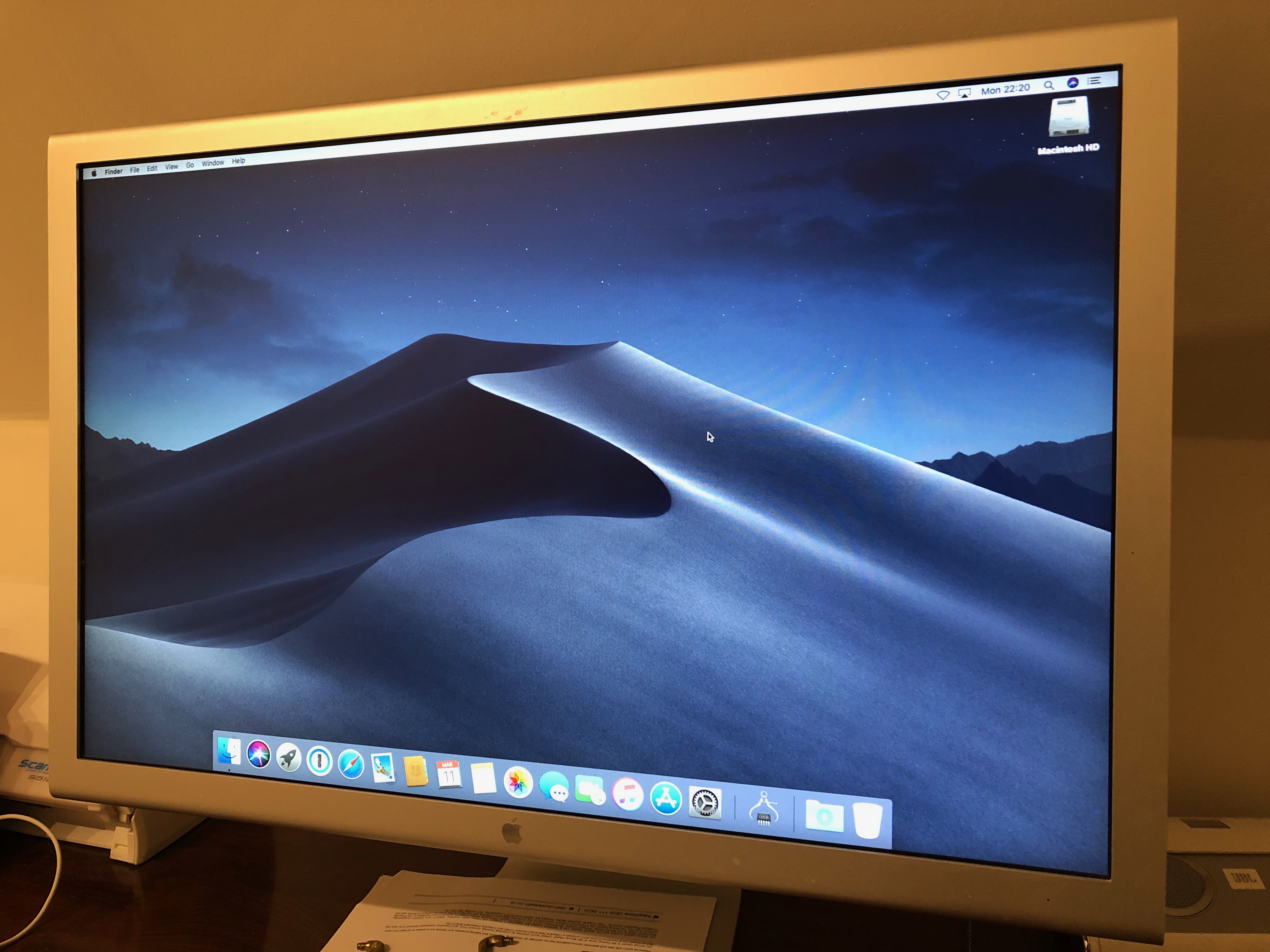

Interesting... just managed to get my hands on a UK refurb 2018 mini i5 / 8GB / 256GB config. Trying it out with a temporary monitor which is old Apple Cinema HD display, connected via a HDMI to DVI-D adapter (although my final solution is similar). Screen works fine bur I just walked in after leaving it to sleep on default energy settings and I got the fuzzy white noise screen. Tapped a button and it went away. Very odd. Not a big deal as I tend to use it as a headless server anyway, but annoying. I've switched all the smart power settings and sleep / hard disk sleep off for time being. Still in return window but I'd be loathed to give up the discount I get on this it looks like v nice machine.IMG_2782.jpeg IMG_2786.jpeg
