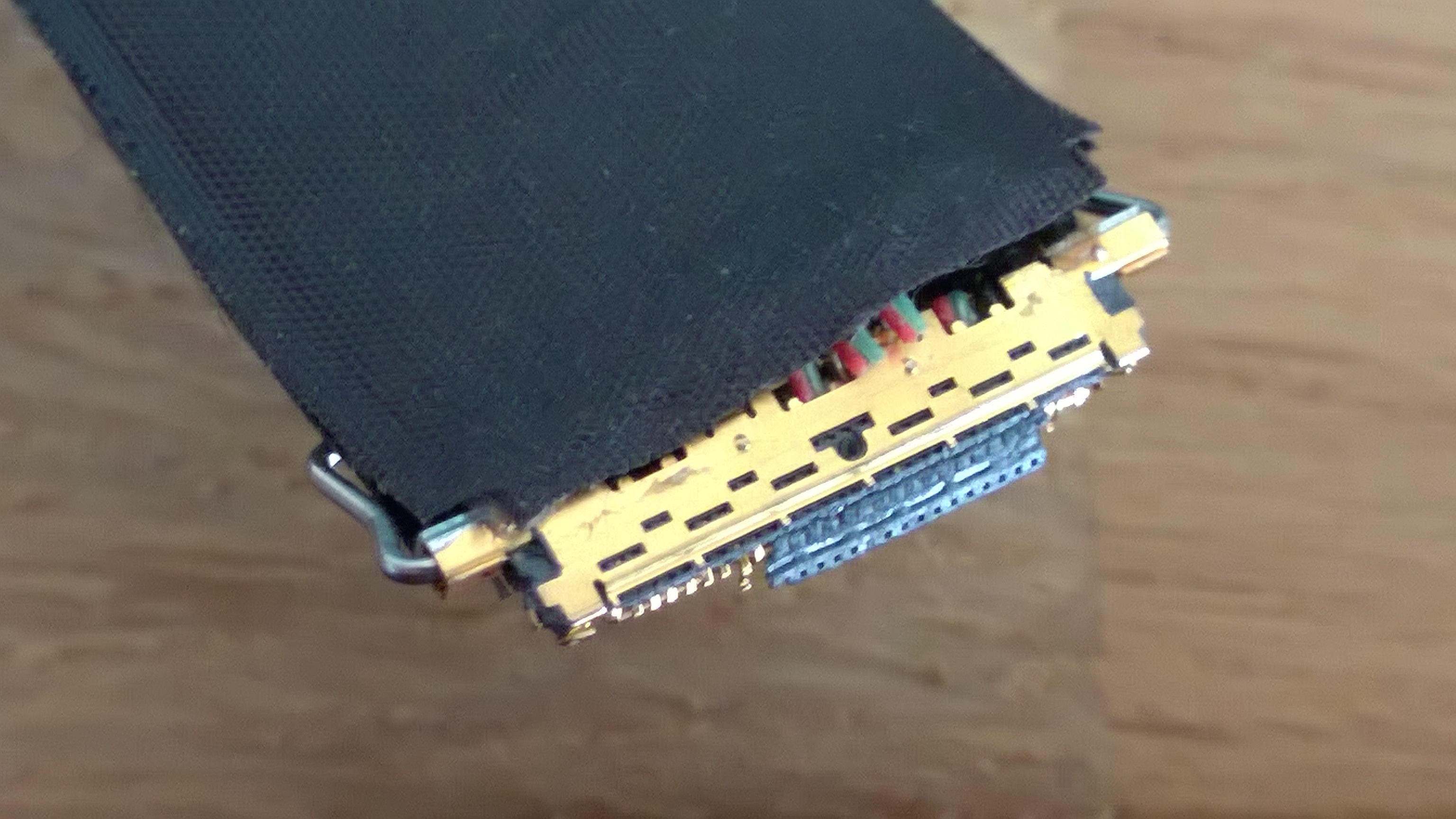

Today i changed my HDD with a SSD, but unfortunately I also broke the displayport cable and maybe also the connector. i lifted the LCD too much and the cable broke loose and my attempts to plug it back in again failed, so maybe the connector on the logicboard is also ruined. The cable seems pretty bad, but its replaceable. I am missing a closeup picture of the connector on the logicboard to see if its gone also, anybody who can guide me to that?

Maybe post a picture of the connector and cable here, so folks who are knowledgeable can determine the extend of the damage.
This is an old problem. The display connector is very fragile and lifting the lcd panel too high will snap it right off. The only solution is a replacement motherboard or running it with an external monitor.
I wound up replacing my 2009 motherboard with a new $175 Ebay replacement. It still works.
This is a picture illustrating when an elephant (me) 😱 is working inside an iMac. The connector on the logicboard seems ok, so i ordered a new cable and keep my fingers crossed.
