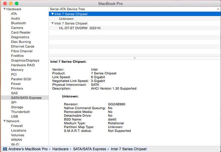

So a few weeks ago I was trying to restore my MacBook Pro. After it restarted I wasn't able to reinstall OS X because it wouldn't let me select the Hard Drive. So eventually I got a My Passport to run OS X on it. But I can't get my Internal Hard Drive to work anymore. If you can help me fix this that would be great. Ive included some pictures that could possibly help with this.
Failed Hard Drive??
Tried booting MacBook Pro all that shows is a Folder with a Question mark.

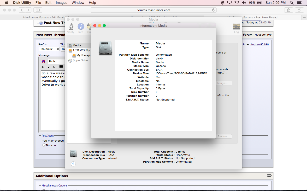

Holding Command + R to boot into recovery. Disk Utility shows Internal Hard drive as Media
DISK UTILITY SHOWS
Disk Description MEDIA
Connection Bus SATA
Connection Type INTERNAL
Total Capacity 0 Bytes
Write Status READ/WRITE
S.M.A.R.T. Status NOT SUPPORTED
Partition Map Scheme UNFORMATTED

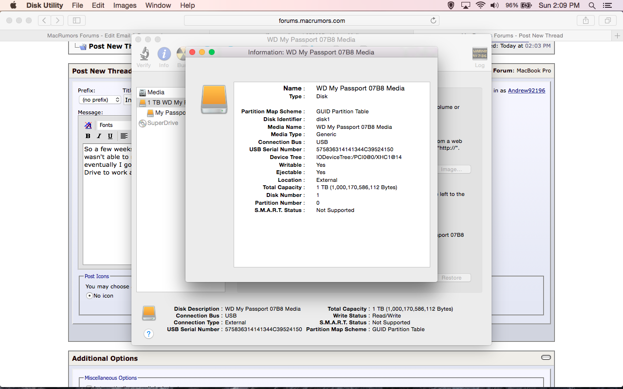

Got an External Hard Drive
Installed OS X on it, MacBooks Pro runs fine

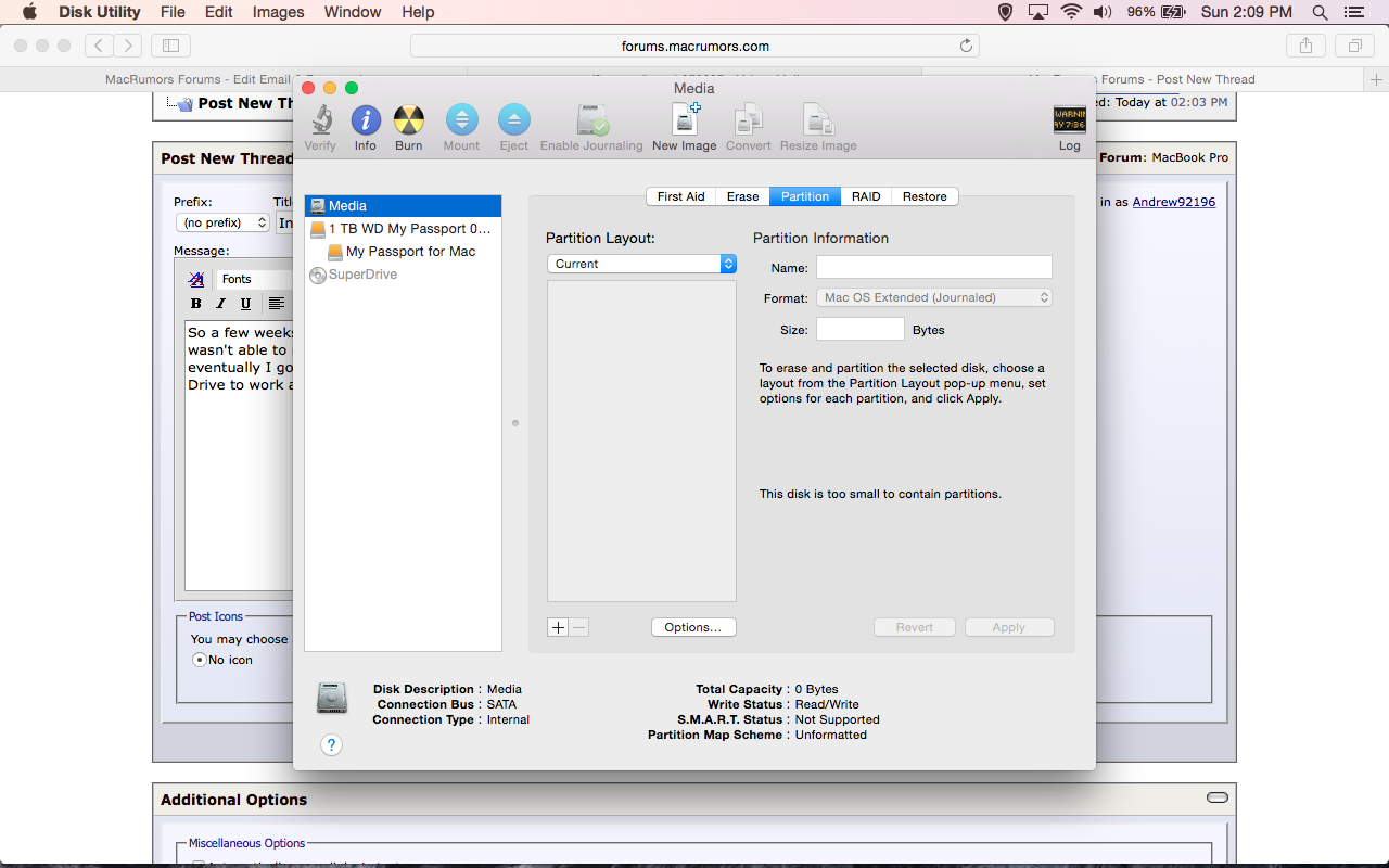

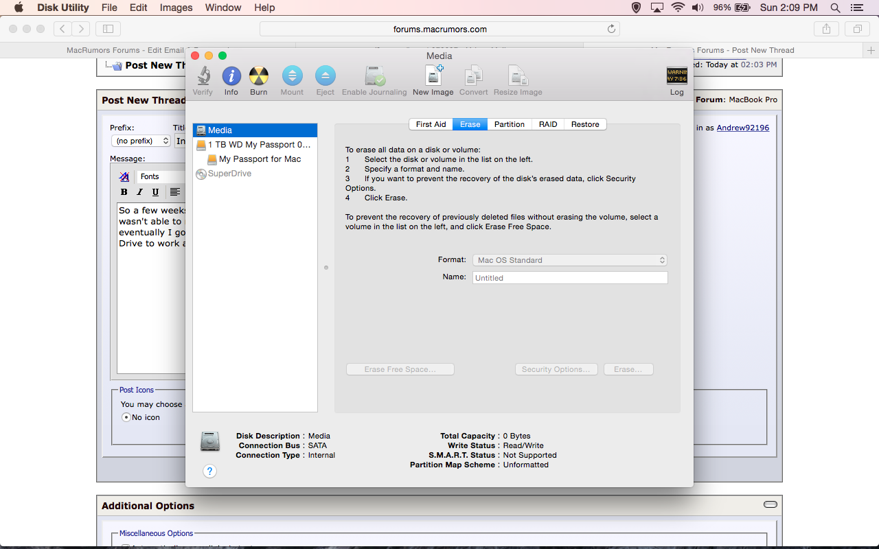

Look in Disk Utility to try and erase and restore Internal Hard Drive
Internal Hard Drive (Media) everything is grayed out.
Cant use First Aid, Erase, Partition, Raid, or Restore Tab.
