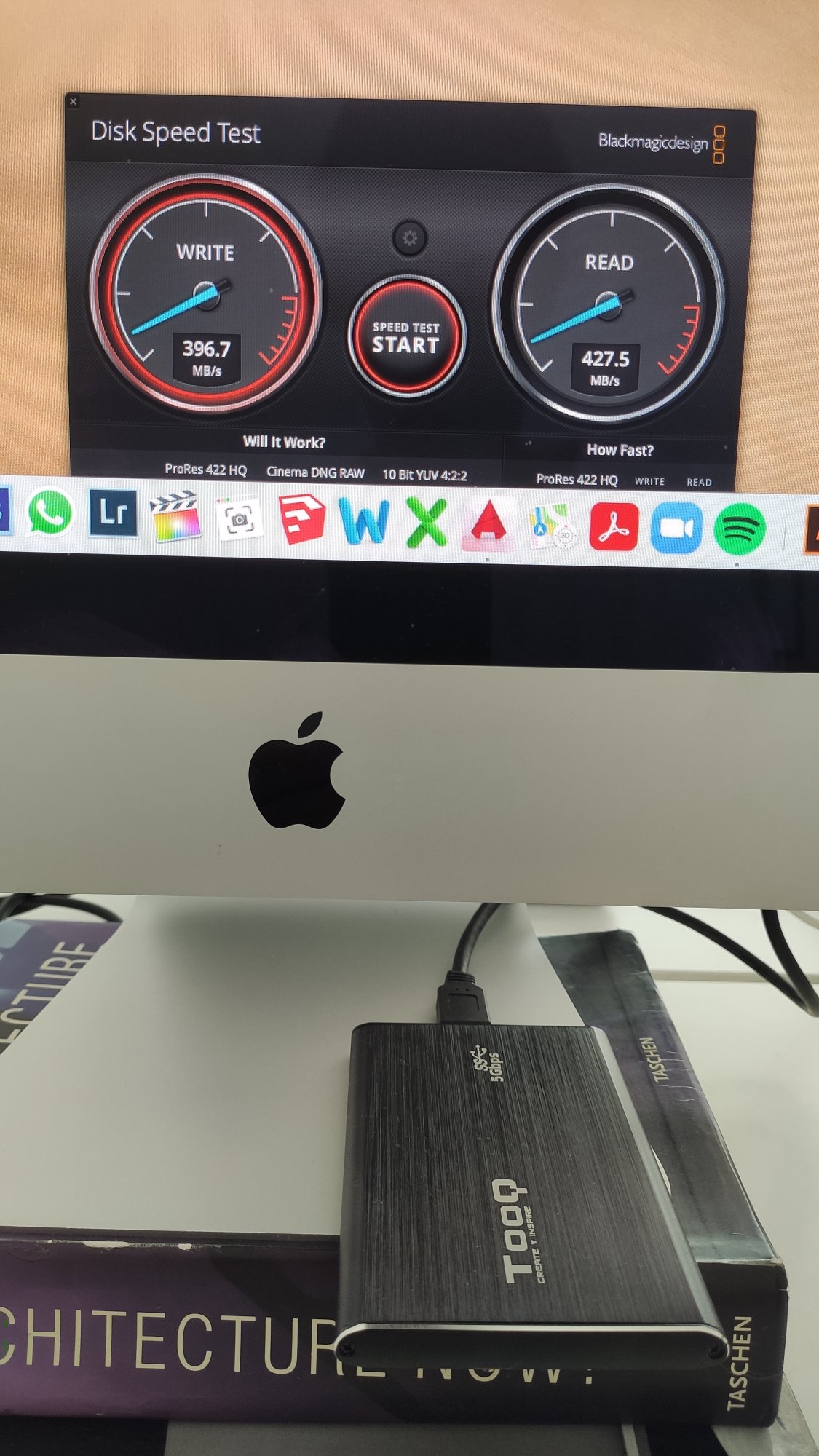

Finally I upgrade with a Samsung 870 QVO SSD 2TB SATA3, inside Tooq external case 2.5" SATA USB 3.0, cloned wit BCC.
Everything is working fine and speeds are in the 420MBps range, as expected.
I'm very happy, but in 3 or 4 days I experienced 2 complete freezes that required a restart, (they happened after some time inactive). Would this be related with the upgrade?

"I experienced 2 complete freezes that required a restart, (they happened after some time inactive). Would this be related with the upgrade?"
I would:
- power down, all the way off
- remove and re-attach connecting cable to drive (do both ends of cable)
- try again.
