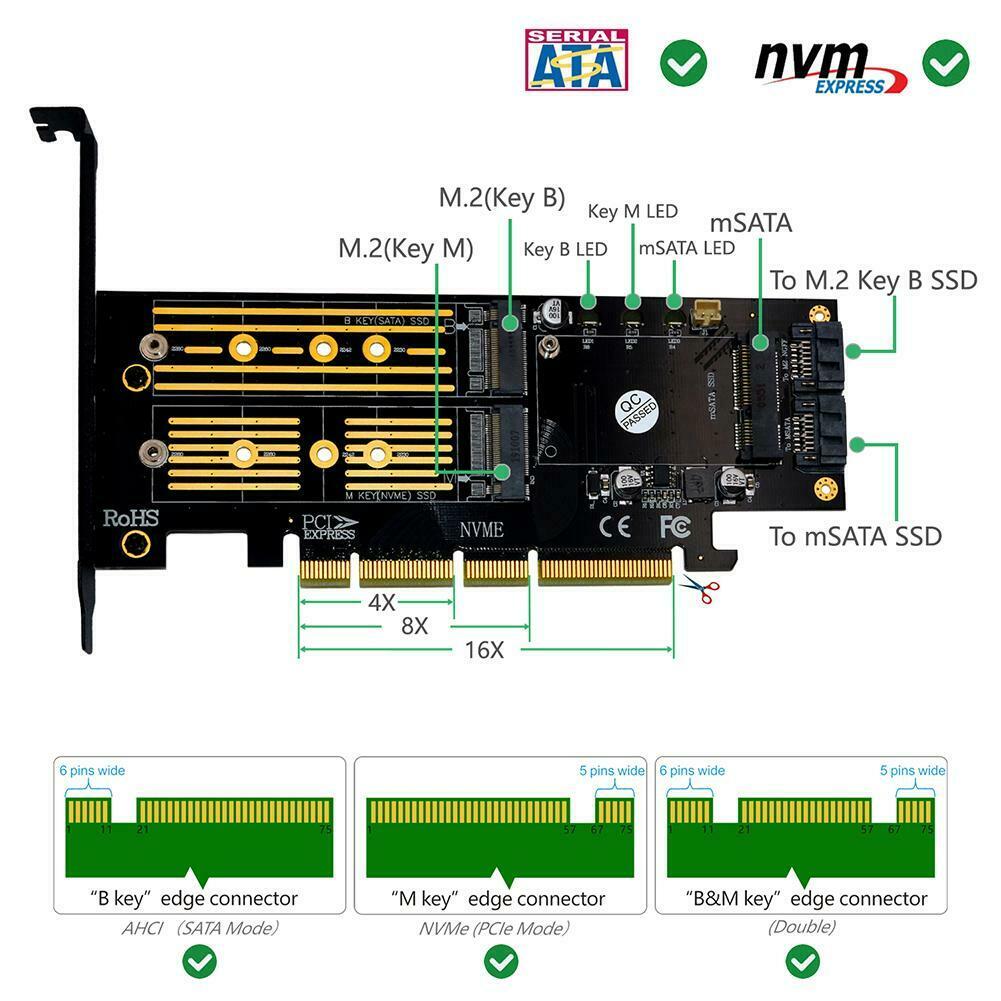

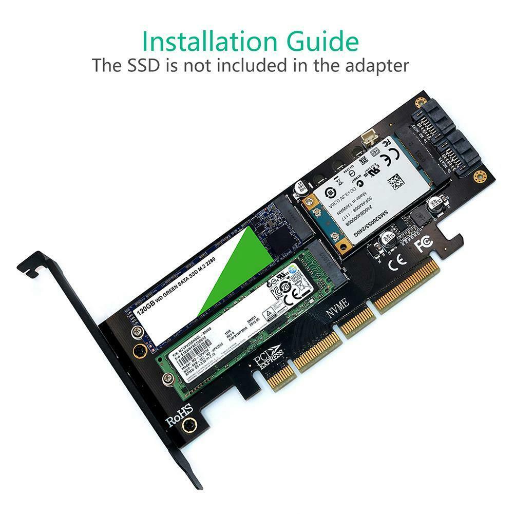

I bought one of these for $20CAN from ShenZhen, China to do what you're doing 😀
Description:
3 in 1 Msata PCIE M.2 NGFF NVME SATA SSD to PCI-E 4X SATA3 Apapter Computer Expansion Cards for 2280 2260 2242 2230mm
Feature:
1. Supports PCIE M.2 SSD (NVME or AHCI, Key-M), PCIE 3.0 X4 32 Gbps bandwidth, apply to 2280/2260/2242/2230mm. (7.48/7.41/7.36/7.31ft)
2. Supports SATA-based M.2 SSD (Key-B/B+M), SATA 6 Gbps bandwidth, apply to 2280/2260/2242/2230mm. (7.48/7.41/7.36/7.31ft)
3. Supports mSATA, 30x50mm, SATA 6 Gbps bandwidth.
4. 3 channel SSD read/write LED indicator.
6. Supports PCIe 2.0, 3.0 and PCIe 4.0 motherboard.
7. Supports 3 SSDs (M.2 PCIE-based SSDs, M.2 SATA-based SSDs and mSATA SSD) to work simultaneously.
8. NVME M.2 SSD to PCIE 3.0x4 (32Gbps), no need to use SATA cable to connect to the PC.
9. When working with SATA M.2 to SATA III (6Gbps) and mSATA to SATA III (6Gbps), a SATA cable is required to connect the motherboard. (The product already contains 2 SATA cables)
10. This adapter is compatible for PCI-E 4X, 8X, 16X, but the speed only PCI-E 4X.
